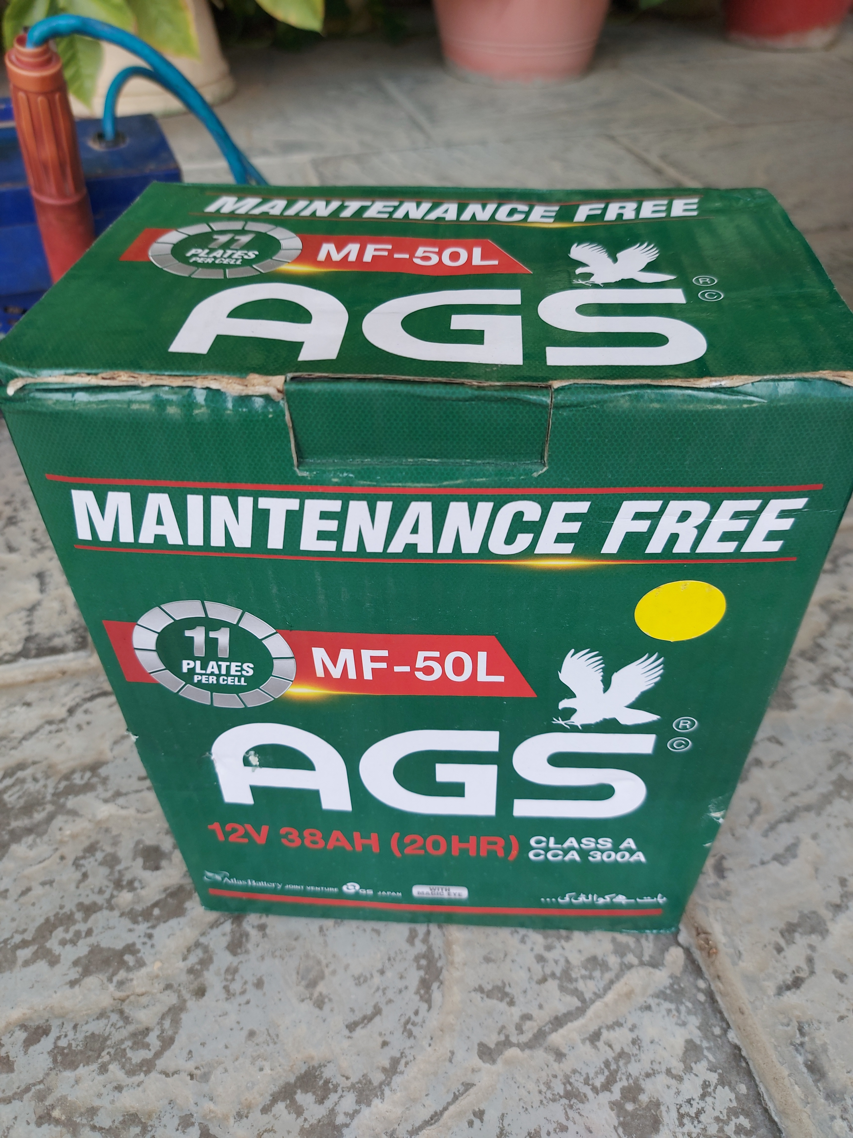

I have 2011 Daihatsu Move custom G. Its front battery suddenly died on me, or maybe i wasn't taking a look at it. When the battery got replaced, its fuel consumption increased by 6 kmpl, eco idle is constantly blinking even after driving a lot. What is the problem? Is it the ecu or the battery or do i need different battery if yes then recommend. Before it was working completely fine.
Both of the batteries are dry cell. I forgot the specs of old battery. If anyone is using eco idle, share the picture of your battery. I couldn't find the eco idle battery in the car. I have heard that the alternator charges the battery quickly that is why it doesn't have eco idle battery.
