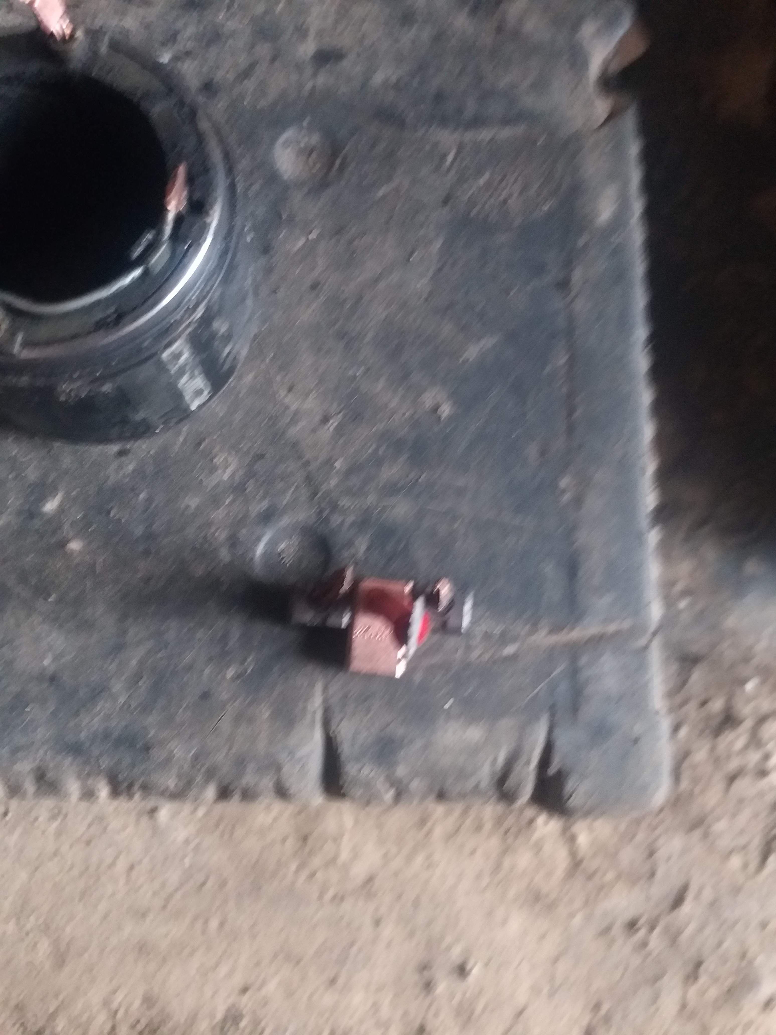

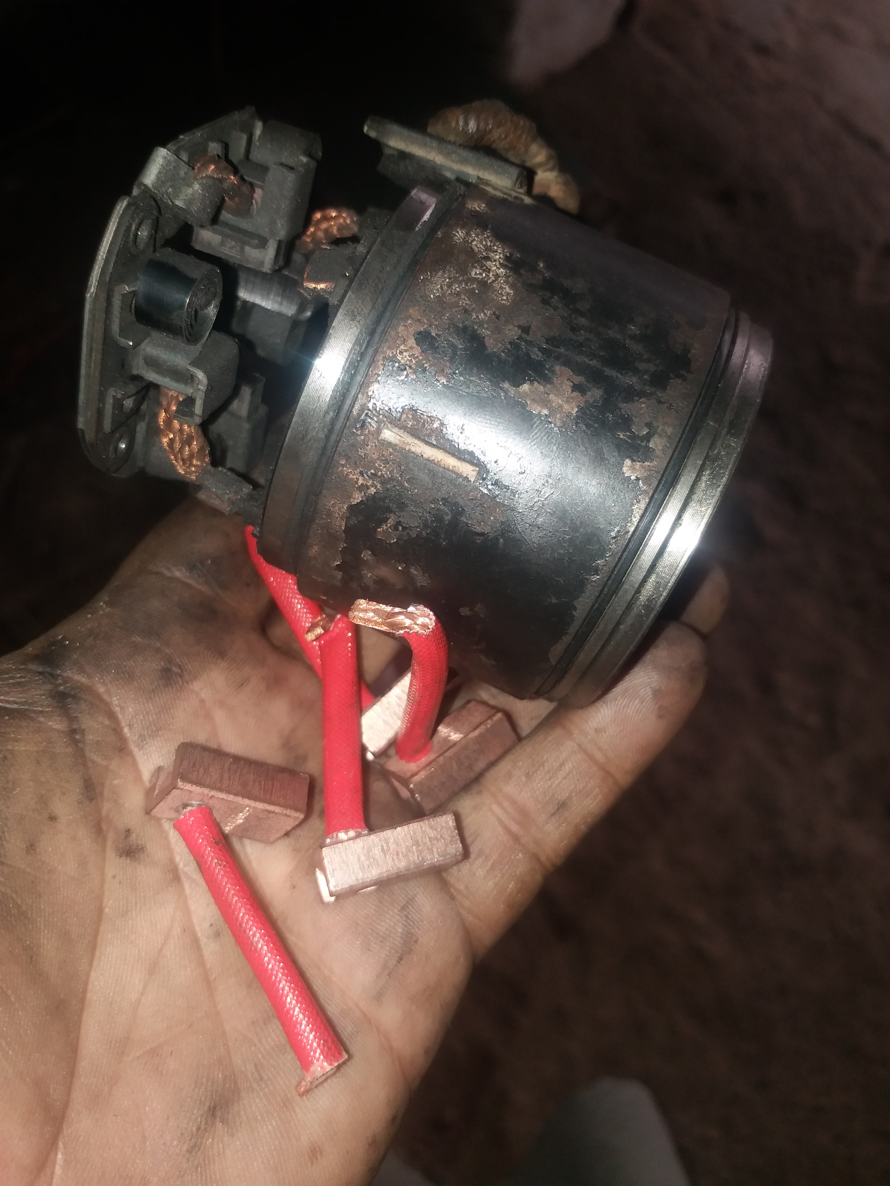

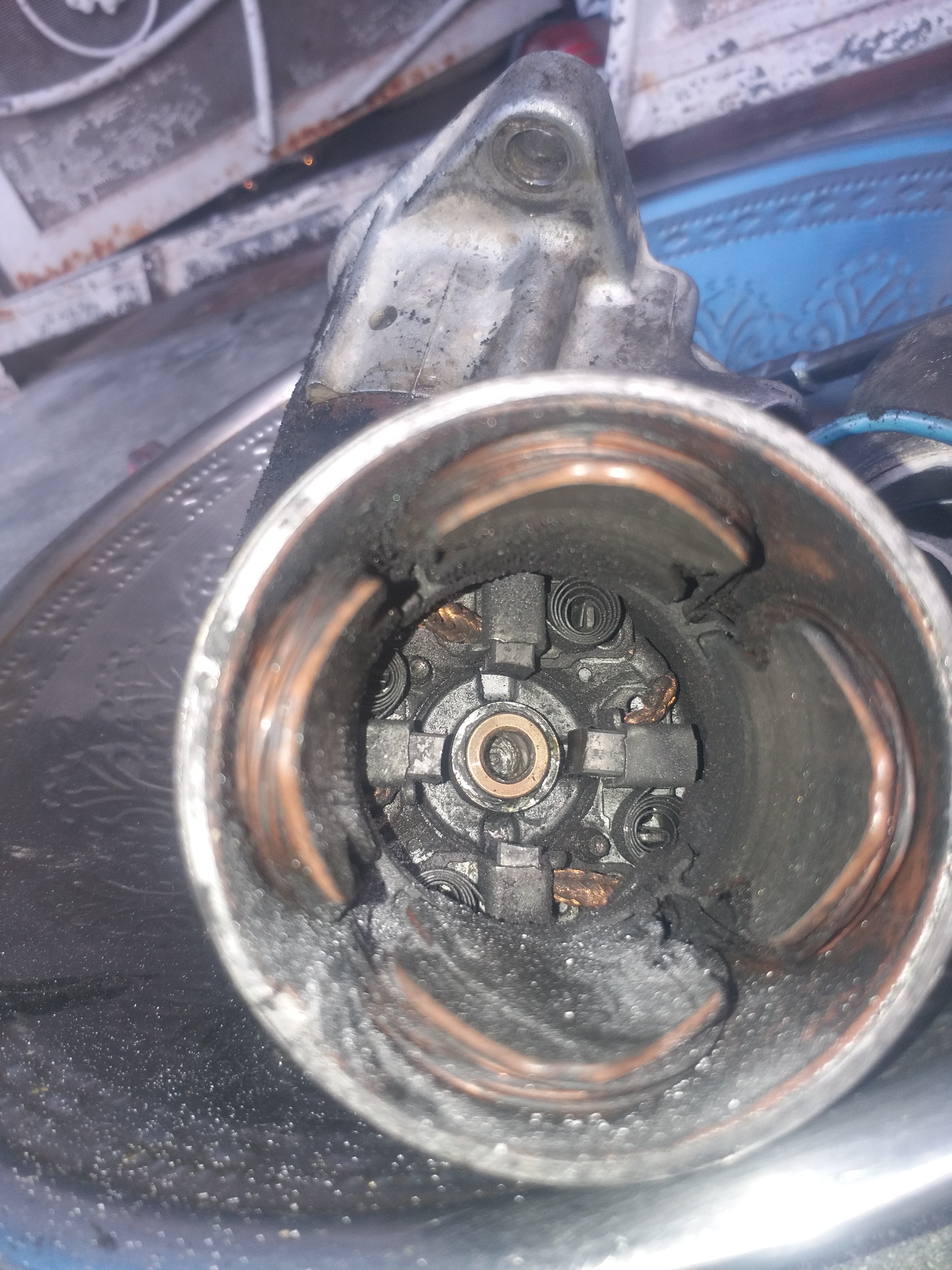

Today i spent a day the stater it was doing some cranking issue in morning like some times stater behave as it has no power or clicks a bit ... I was doubt in carbon bushes and i was correct with my guess well have changed the bushes and also cleaned the stater from inside Uploading...
