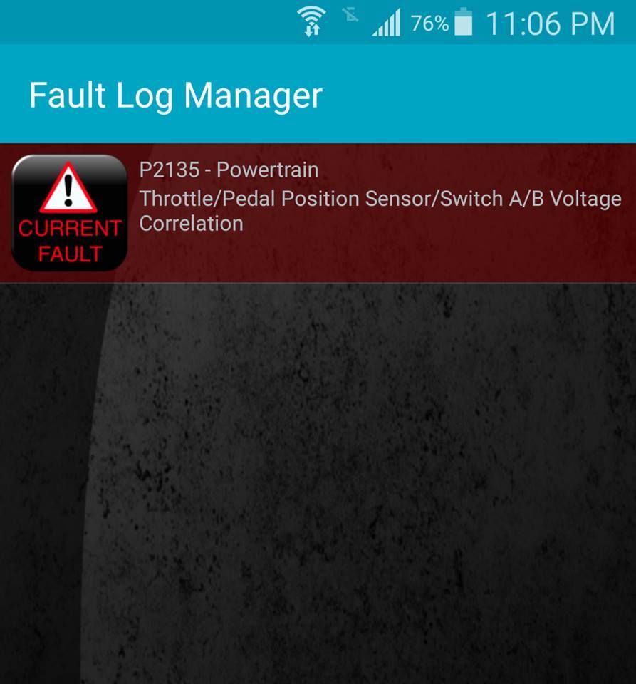

My honda city IVTEC 2015 just started showing Check engine light. Actually I was out driving in the Rain in Karachi for 2 hours.
Car engine stalled in 3 feet deep water twice. Luckily i was able to start engine within 5 to 7 seconds. (after pressing accelarator hard)
Reved the car sometimes upto 4000 rpm in first gear while driving in water.
Checked radiant coolant level and it was OK. Also checked fan and its running normally.
Car check engine light is of now and car is driving normally and is not under powered.
What could be possible reasons for this light. Should I still go to the mechanic even though the light is off.
