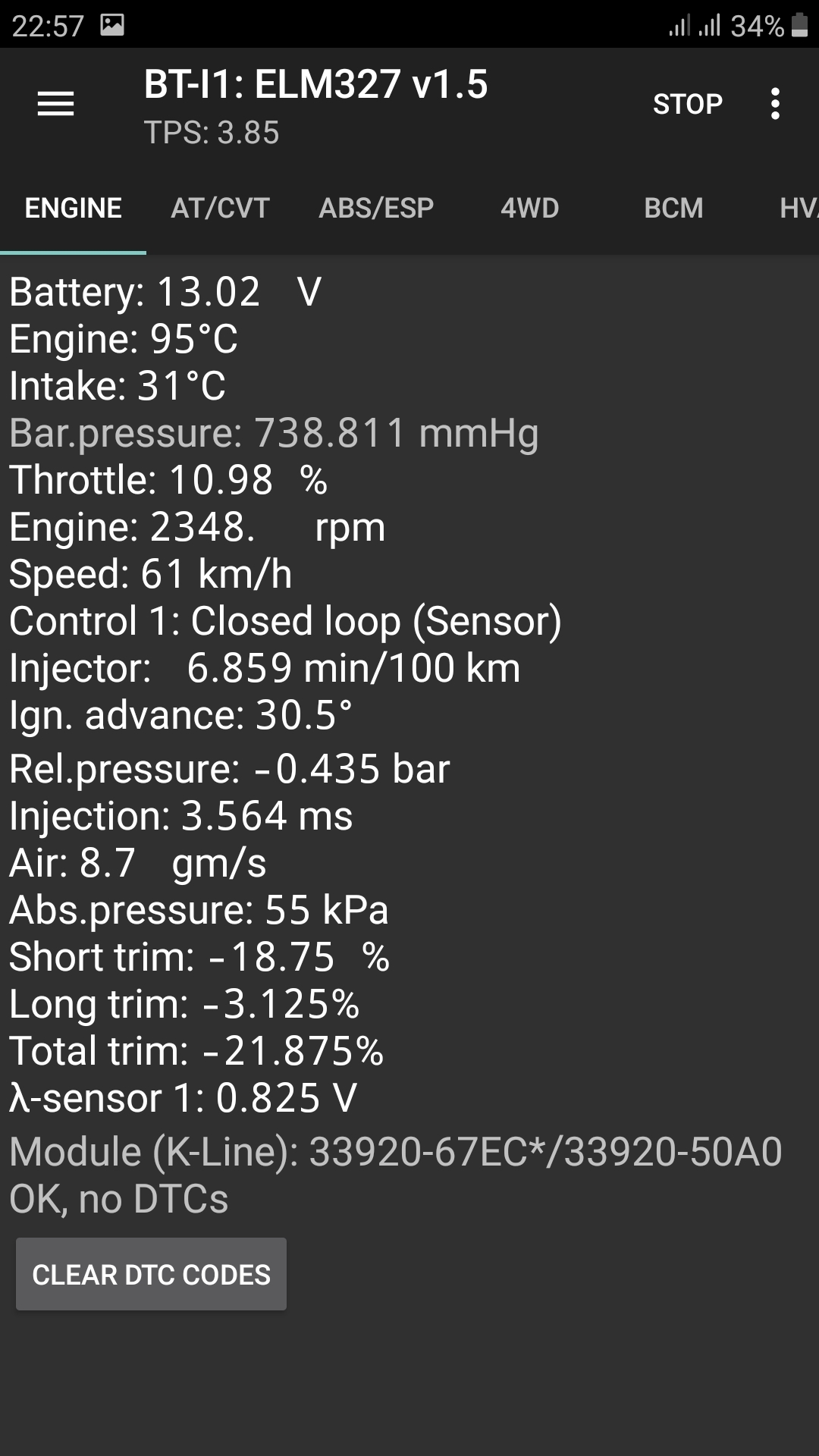

I also got a cultus 08 efi last week. Hooked up my bluetooth obd2 adapter to see why the fan is not running automatically, it was direct previously.

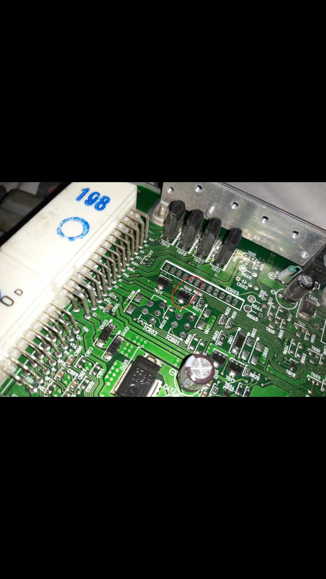

Khair somehow managed to check the wiring & diagnosed the issue. It was due to bad transistor on the ecu which sends signal to radiator fan relay.
Tried to find this transistor from market but it wasnt available anywhere, so went to my local ecu repairing shop, he charged me 500 & replaced that transistor from another scrap ecu.

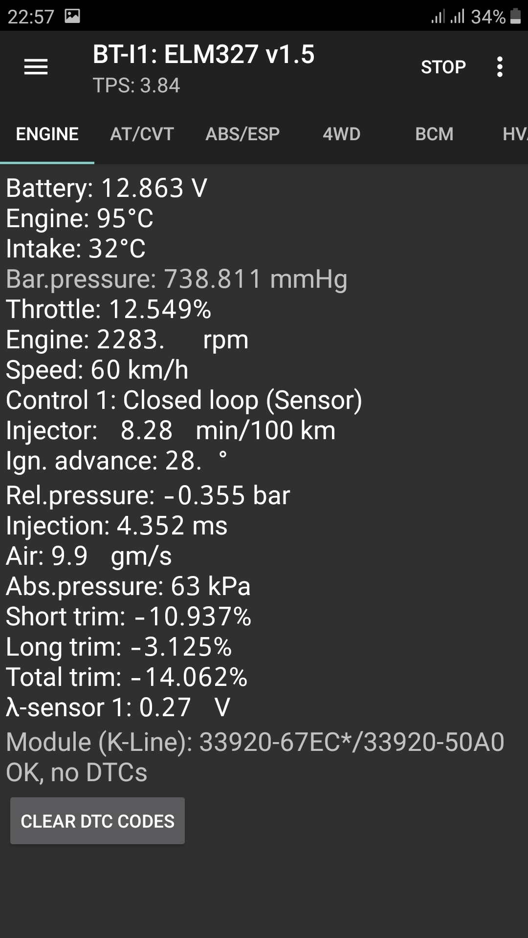

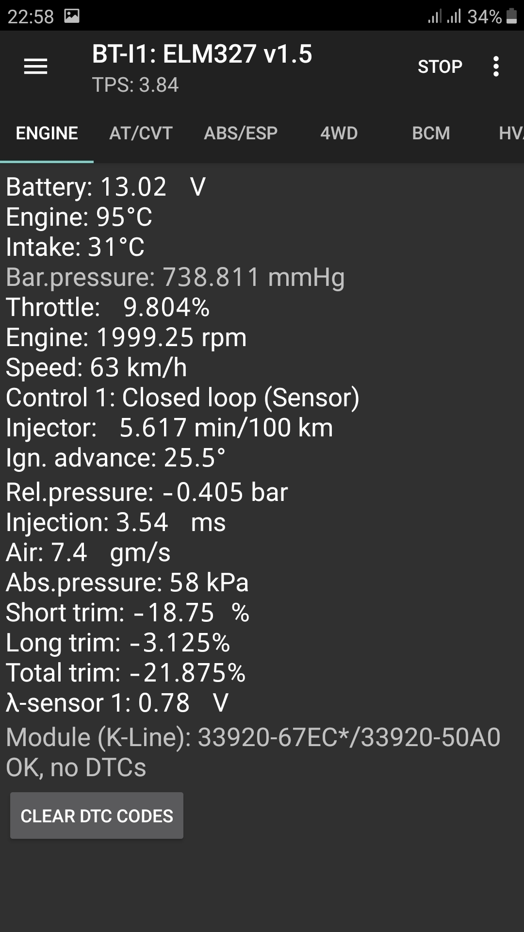

At first I also noticed that the ecu remain in open loop while idling,I thought my 02 sensor may also needs replacement, khair when I took it to drive, ecu shifted to close loop & LTFT was also in negatives.
Previously due to direct fan, it was continuously running in open loop & was hogging fuel like anything, but after the auto fan job, its running perfectly fine. Alhamdolillah !
