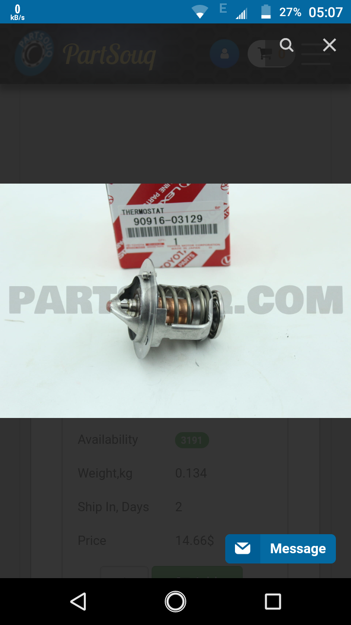

Update!!!So today I went to the mechanic to install the new Thermostat Valve I recently got from Karachi as previously I removed Tstat valve in summers as it was partially opening. At first glance the mechanic said that it is not the correct part according to his knowledge but I assurred him that I confirmed the part number online so he installed it and then filled water and started the car. When the needle reached middle it opened and after some time time the fan also started so he declared it Ok. Then I took it back to home but one strange thing I am noticing is the heater is throwing very hot air even at lower settings which is making me a little concerned that whether car is operating at normal temp or its overheating. Its needle still is at middle and the car is running Ok no knocking or loss of power but this heater thing is making me worried. Now how can I check its working as needle is at the middle all the time and both upper and lower hose are hot like water is circulating through them.Below the is the picture of tstat valve
One more thing I want to add is , 82'C was written on the tsat valve

Aik aur chawal wajh gai mujh say k mainay gasket nahi mangwai tstat k saath aur purani waali farigh hogai thee khair phr mechanic k paas parhi theen us he may say aik fit krdi us nay jesay tesay kr k baaqi Allah maalik hai mainay tu apni taraf say poora homework kiya ab meray city may kuch milta nahi tu yeh meri qismat
you were experiencing weak heater performance before when the thermostat was missing, what you are experiencing now is correct. The heater should blow very hot air when the engine runs at normal temperature and you spin the dial to max heat.
so it means ur issue resolved. great
Can you please confirm is it the correct part?? And any way to check the coolant temperature??
