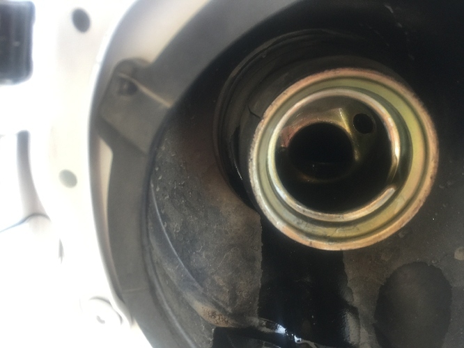

I have a high mileage engine in my possession, I was loosing a quart of oil every 3k km's. It was about time to step up to a high viscosity variant. I went for Taglon. My engine has a lot of sludge deposits, because of extensive usage in village environment where it did 50k km's of running on I am sure fake oils. The guy who filled the oil overfilled it a bit. Next day I go to get that oil removed and guess what taglon has turned considerably black.
Morale of the story even an ordinary flush does not do anything. Because I have done it before and oil comes out quite golden. Why did the taglon turn black in one day? Simply because I had a high speed run on the ringroad in this one day and this is what would constitute as a proper flush had I done it for a engine that is sludgy like mine.
