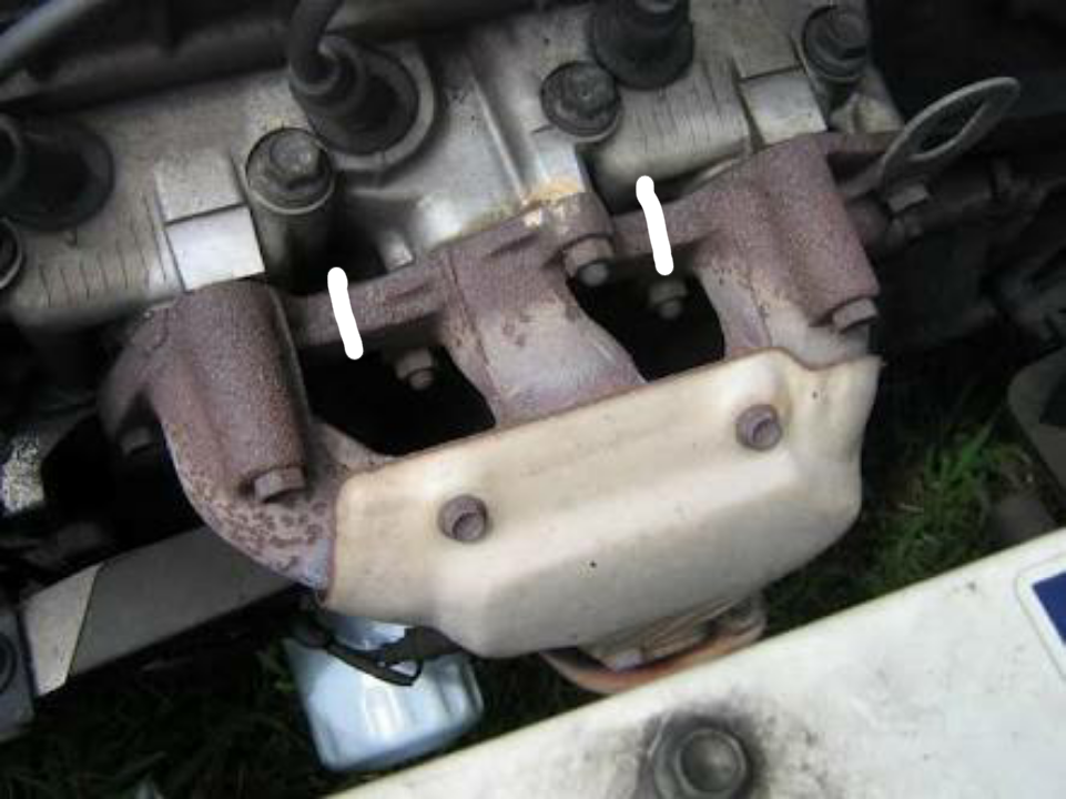

Also get the exhaust manifold cut from the places marked in the picture sometimes it also leads to a blown head gasket problem.
It was reducing earlier and I faced gasket issue multiple times. It has been replaced 3 times in the past 6 months. Once because generator belt was broken. Recently its head was faced and gasket placed, with radiator serviced and coolant filled in.
sorry brother I couldn't understand. Do you want me to have those pieces cut from those places?
Yup i meant the same. Cut those extra pieces.Expansion/contraction rates are different for both aluminium amd iron and hence this can also lead to a blown head gasket.
