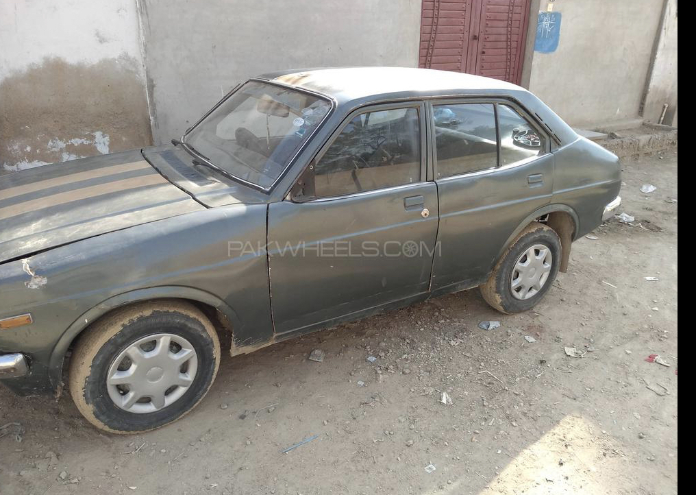

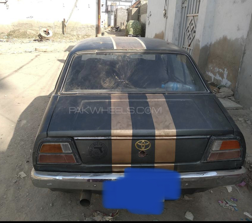

I am looking for an engine and transmission for starlet 1974 door sedan i have a budget of 5L what engine can i swap in this budget which would give me the most hp?
Starlet 1974 is P40 series SEDAN front engine rear wheel drive.
(P-60 series are 4+1 door hatchbacks)
P40/50 sedans were imported into Pakistan as reconditioned vehicles, all were JDM specs.
Hello, the starlet i am planning to buy is a sedan its the 1st gen starlet i will attach some pics Can you also suggest and engine and transmission ty
I am just a beginner I don't have a lot of knowledge about cars i am just wanting to make a cheap daily driver/drift build

it will be helpful to guide if you post the current setup of vehicle, lift the hood and snap day time pictures.
do tell us if the engine & transmission are still the oem setup working in vehicle, or there is some ustadee already done.
