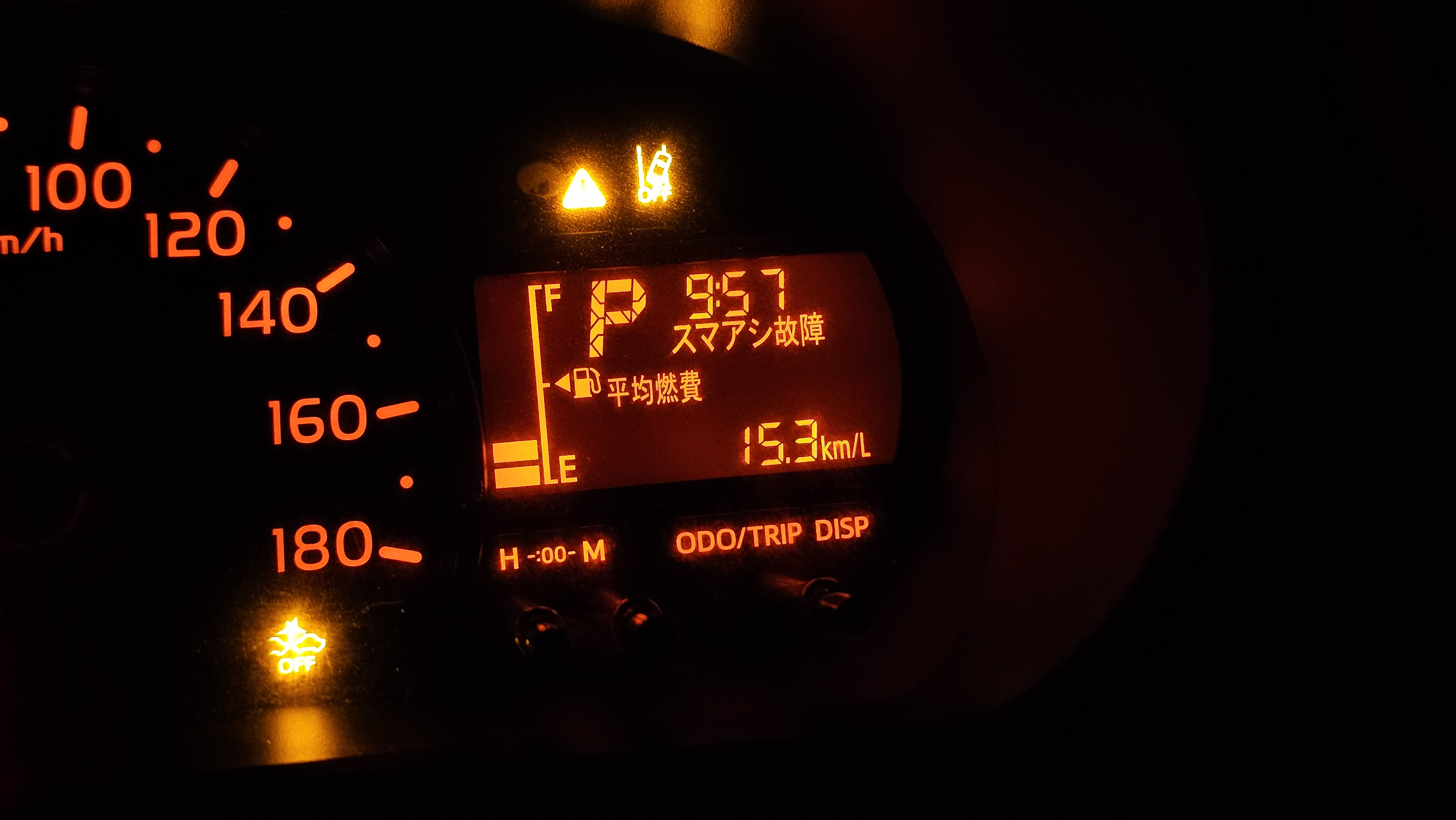

Can anyone please help identify the problem this error code depicts?
I have shown it to a mechanic who scanned the code and it showed a sensor in the front. But he wasn't sure
Post the error codes here don't rely on technicians who don't know what's wrong with it.
Looks like a lane departure and collision assist warning?
It's hard to tell from the pictures, but you need a scan tool to identify exactly what error codes are stored in the system. Once known, testing can then be done to find the issue

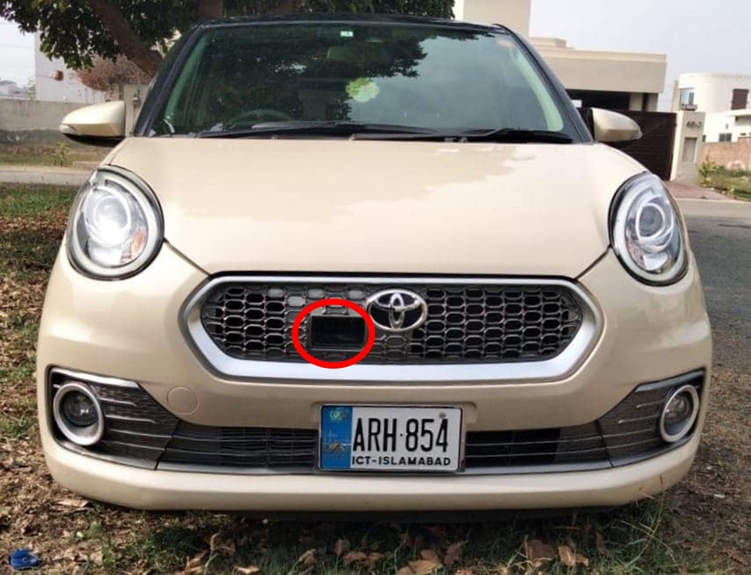

You did not say which year is your Passo. If you have ADAS in your car, try cleaning the lens for ADAS in the front grill
