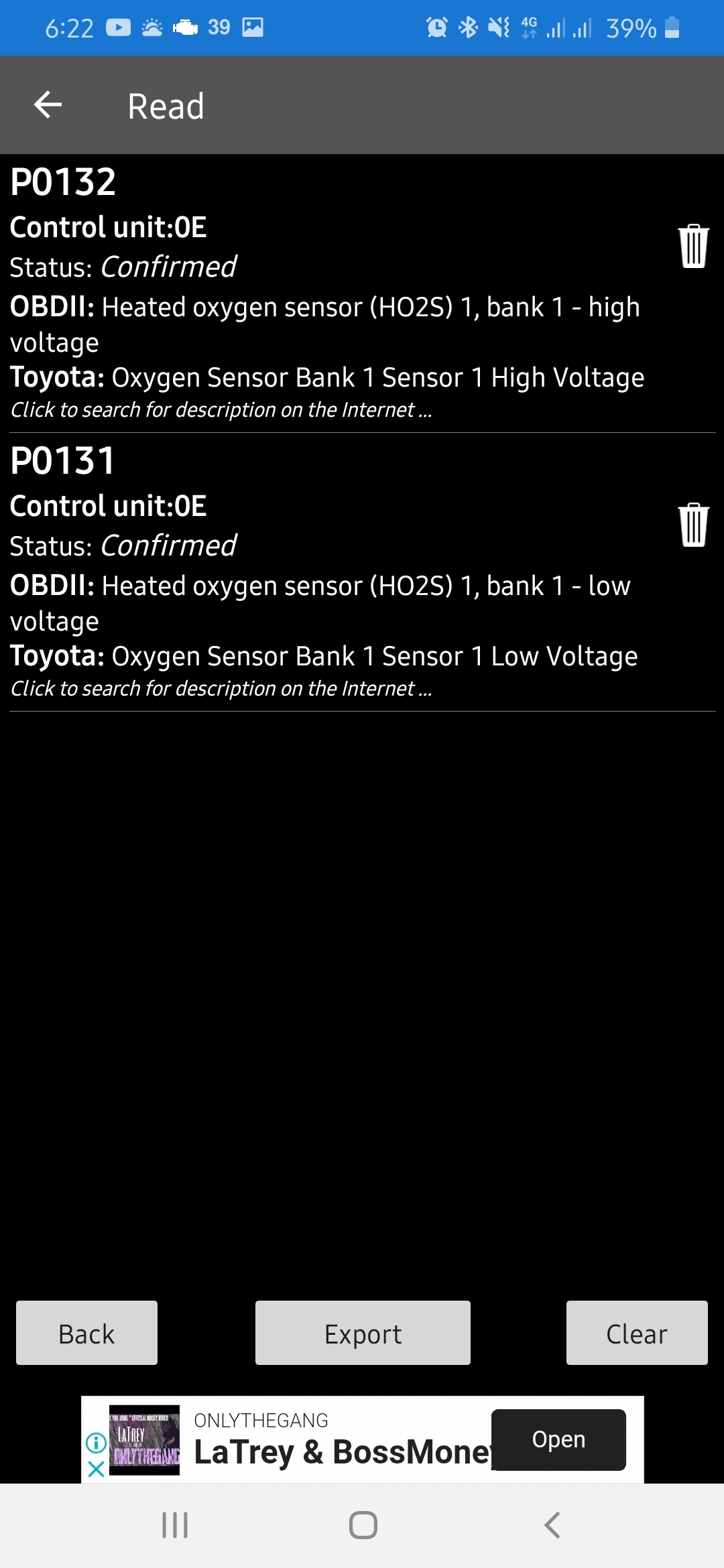

hi guys suggest please solutions for this code.
last week replaced the injeftors and drove 100 km after thar got this code during traffic jam
@xulfiqar any suggestions@capsat @dani_kk @chinyoti @incognito59
reset it. if it comes again then i doubt your new injectors.
actually those were qabli too. not new
infact i have replaced the o² sensor today bought it qabli from shafiq more
let me upload the video here and see the readings please suggest
@xulfiqar
these codes pop up when o2 voltages stay high or low for some seconds.bad injectors can be a reason for it.
here is the sensor readings
so the injeftors i replaced last week are bad ?
Yes. Reset it. If it appears again reinstall your old injectors.
The Old injectors were running the car too much rich , the Short Term Fule value was -0.20 Volts all the time. there were Leak and Avg was not good
in that case you need to buy brand new ones.
