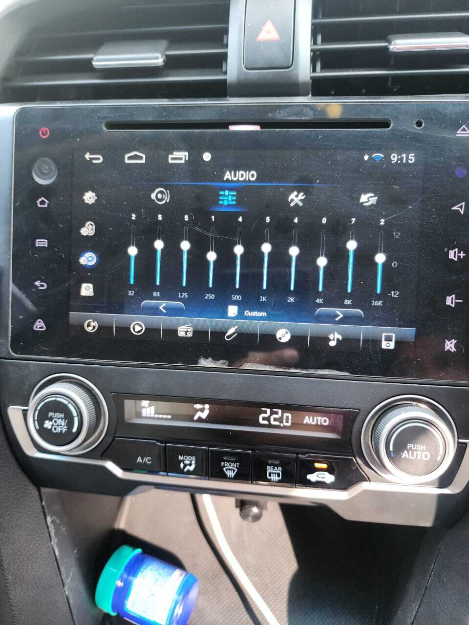

Software aside which probably costs the Chinese a few dollars to get up and running, or the fact that there will be terrible customer service linked to units coming out of China or the fact that if something does go wrong, repairing this unit will be a PITA, we can actually test the two out and see both sides of the story. We'll throw in a Onkyo XQD1800 Pro in there too. The 6-128 costs 120k so it's right there

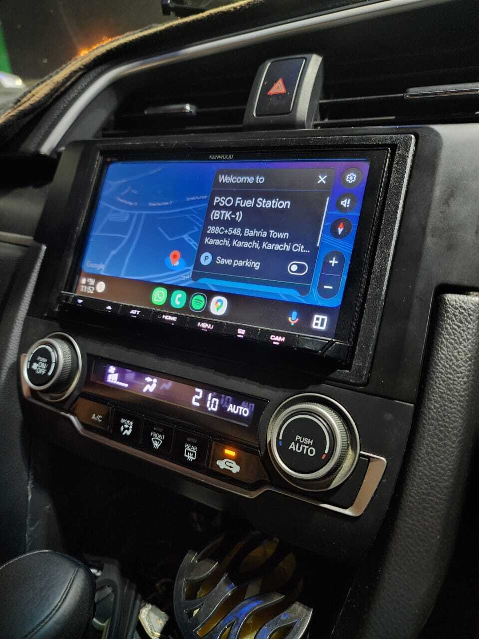

The point of this test is to test the audio quality of high spec android units vs a OG brand that has recently introduced a budget friendly player (that has a larger android type 9" screen) and that uses the same software and hardware like it's generic head units. Remember, the Onkyo pro series units were designed in collaboration with Pioneer's engineer's. The 1200 and 1800 pro are both possibly the best sounding android players I've heard & tested and yet I would rather have a good old pioneer A, Z or NEX series head unit that pretty much offer me the best audio output & features along with things like alexa, idata link maestro, siri eyes free, HD radio, android auto / carplay etc etc. Things i use on my everyday commute in my corolla/civic/vitz/aqua/lc80/patrol/surf/sunny. The only vehicle running a android unit is our rocco with the nakamichi 5510 and that unit does cost 50k so it's not exactly cheap. I'm still replacing it with a Alpine 10" floating screen.
If you have one of the newer cars that come with their integrated head units, obviously you are not going to install a Chinese android unit in there. You could install one of the OG units and tap into the car with the Maestro which is a lot better than having to worry about your android players gimmick software just crashing.
I still want to do the test though. But there is a reason you'll never see a car audio install channel/shop/individual throw in a android unit into a build. I would not spend 50-100k on a Chinese android unit let alone 100-150k no matter what kind of features they offer or how big their claim is of the audio quality being great. I've done previous comparisons with the DD-1 and multimeter as a hobby and you can send your choice of a android unit and i'll do the same and share the results. Just a heads up, non of the android units will ever put out numbers (pre volts, amp rms values, thd's etc) they claim on their box's. On the other hand, grab a alpine/pioneer/kenwood head unit (not their flagship series but rather their basic ones) and you'll find out that their values either match or are in fact under-rated than what they put on the box.
