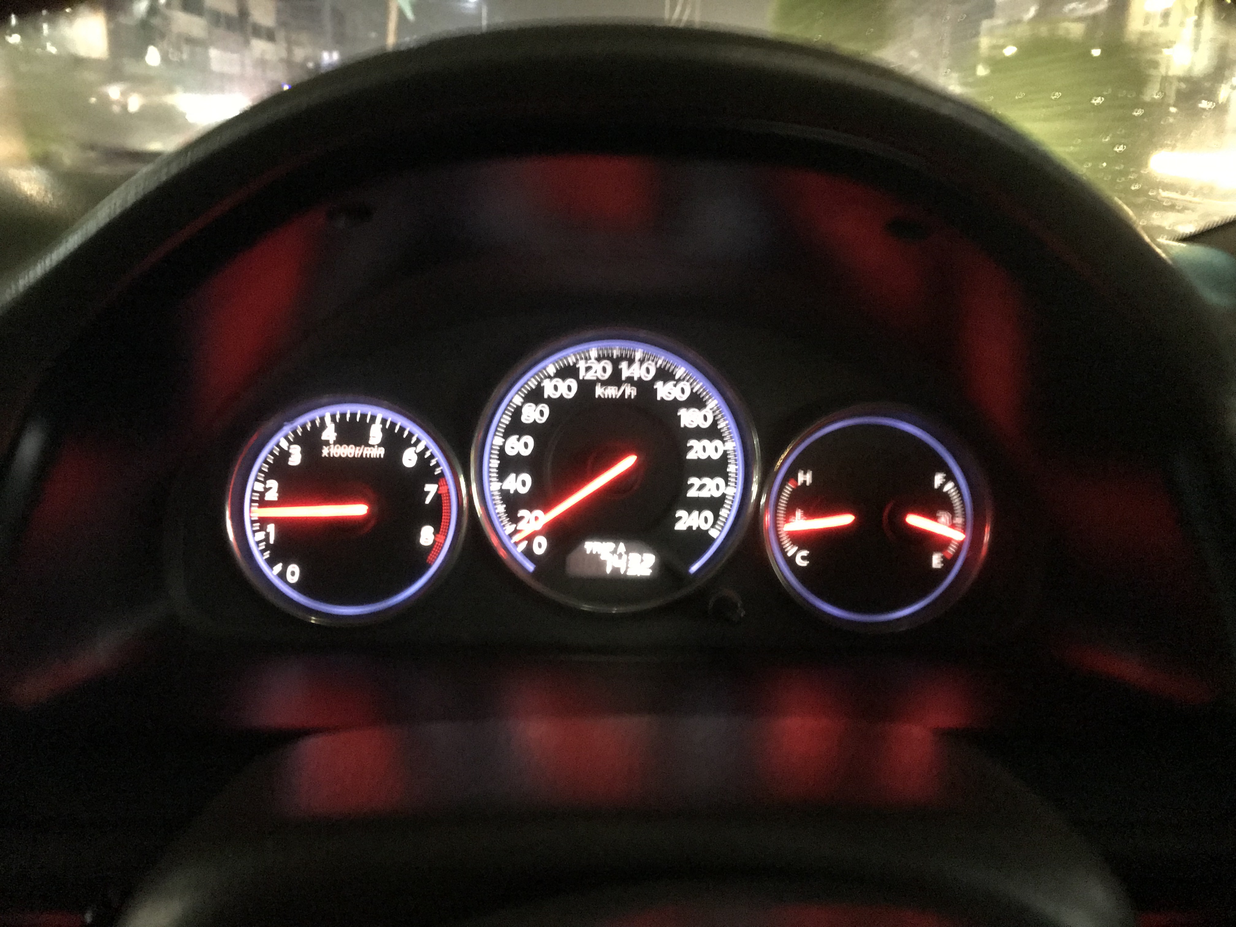

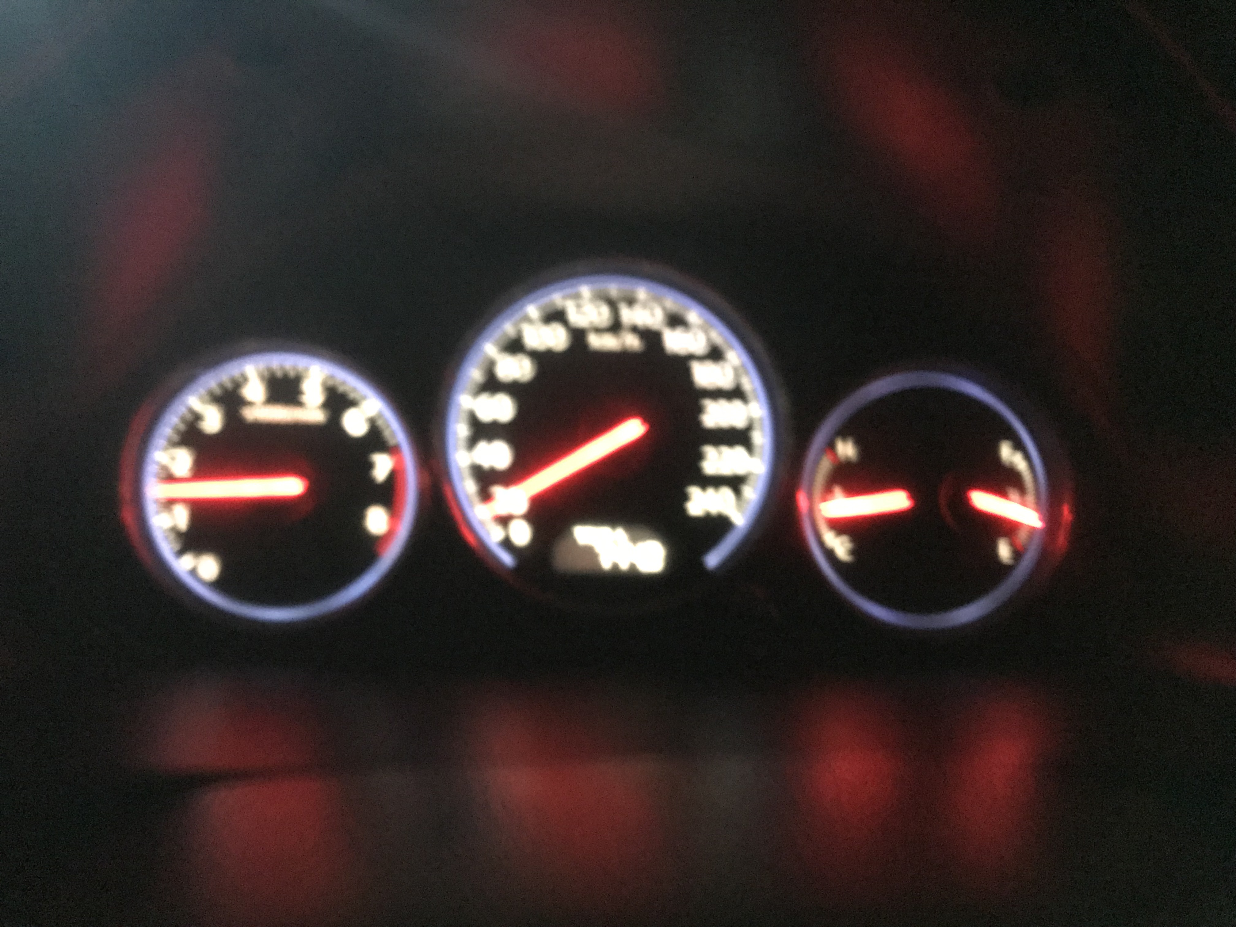

Rpm dropping problem can also arise due to incorrect tappet/valve clearance setting. RPM shooting to 1500, did u spray anything in throttle body,map sensors are delicate and they dont like desi ustads' most favourite tuning job of "sprays" in TB.
