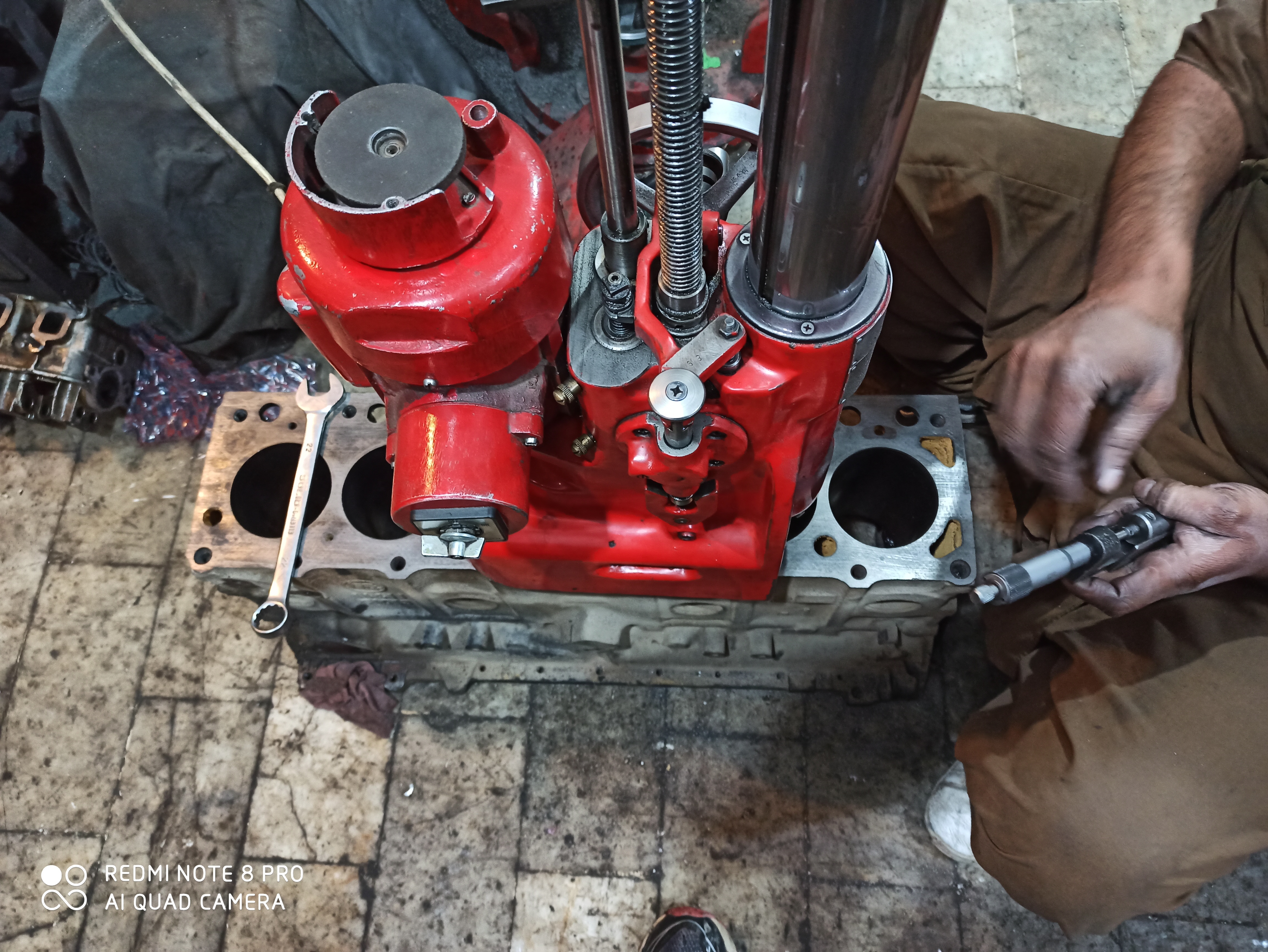

Dear folks, we are restoring fj40 completely in bone stock looks and it's own engine... So currently we've disassembled the engine just because it was giving 100-120 average compression and was eating oil..
Upon opening found out two seized Pistons... With rough crank shaft. And too much sludge accumulation.

After measurements and data collection..problems have started to increase.
Bore is 0.50 already.Crank main is 1.25
Searching for blocks, Pistons etc... Let's see what happens now.
Finally have bought the stuff going with standard rebuild...
Valves are worn out and changing them.Seats, guides, seals getting replaced. Cam Bush is being replaced.
Bought new Pistons.Gasket and seals set. Cleaning the stuff started today.
Crank bearings are also purchased.
