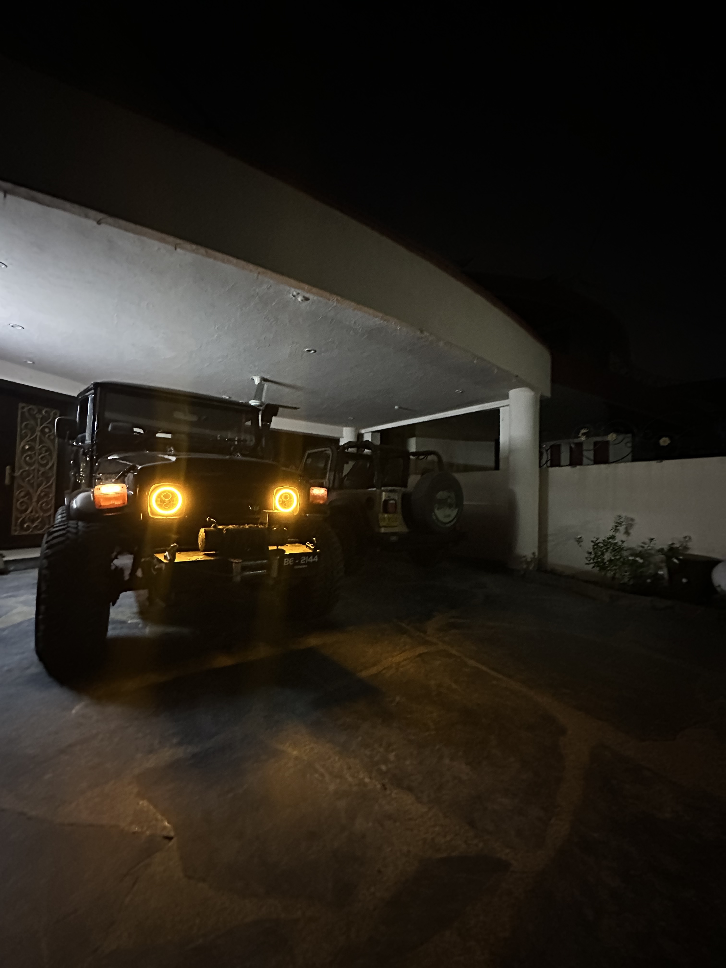

Okay you can contact me on WhatsApp if you need to see my jeeps and the comfort in them and the things done on them. 03105419868
