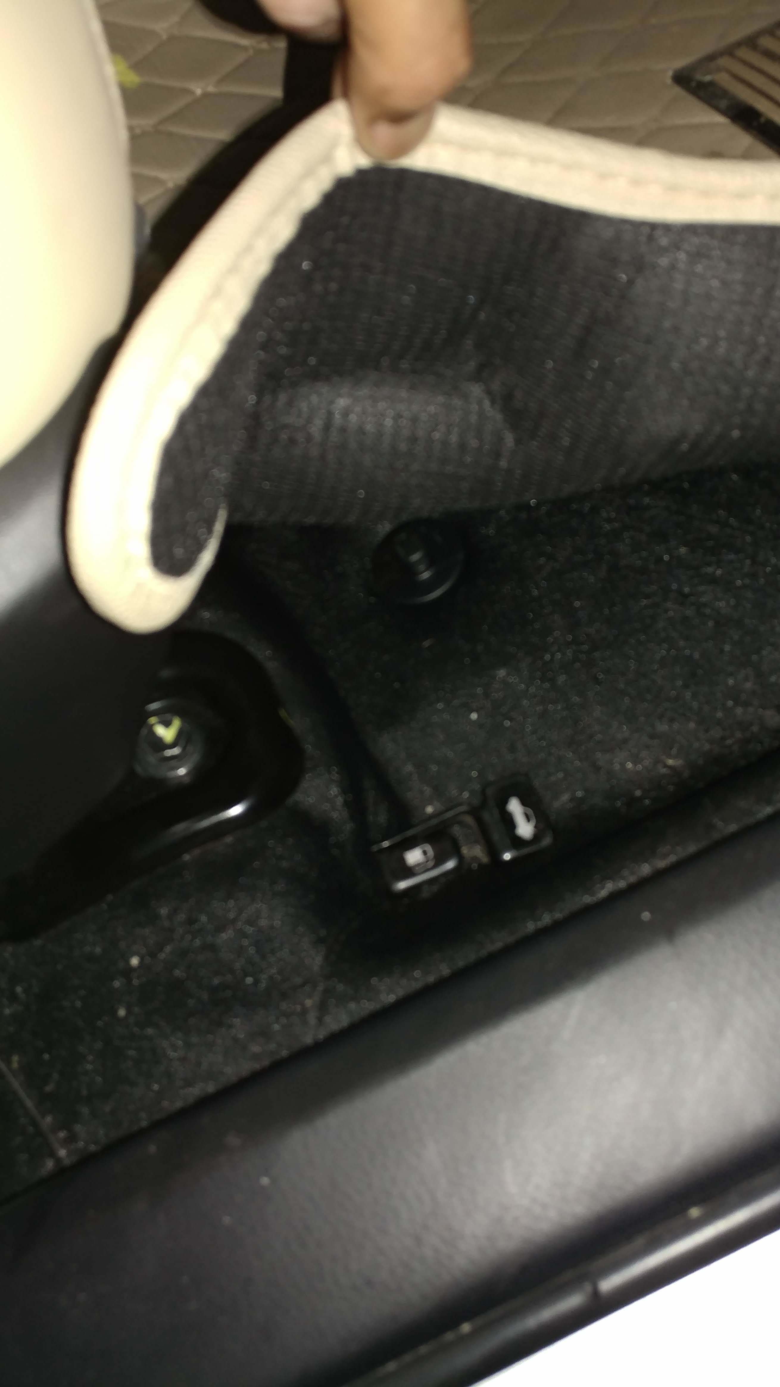

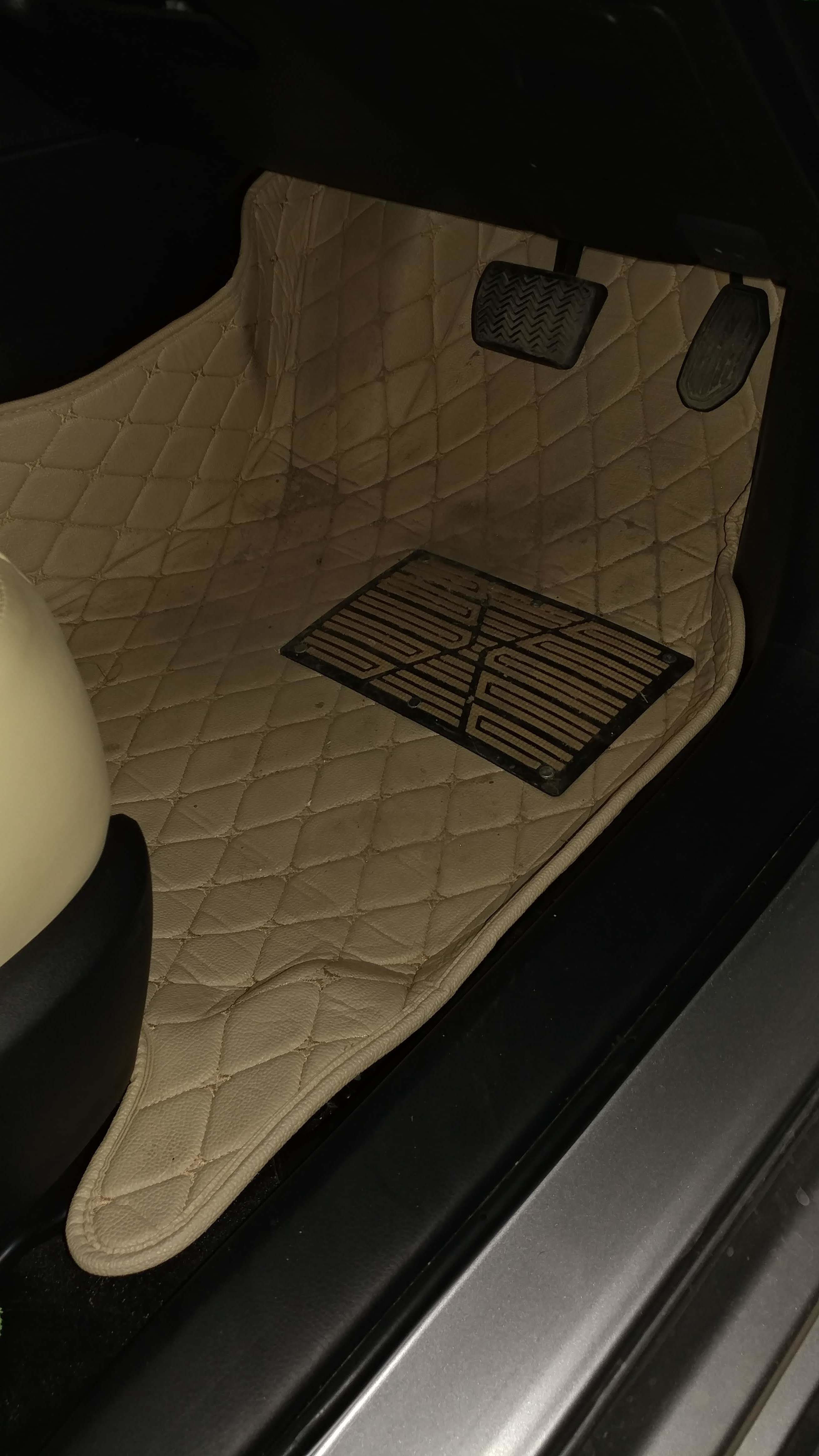

Hello Pakwheelers, Just a small mod regarding the corolla or any vehicle driver side matt retainer clip for after market floor mats.
Pictures are itself self explanatory

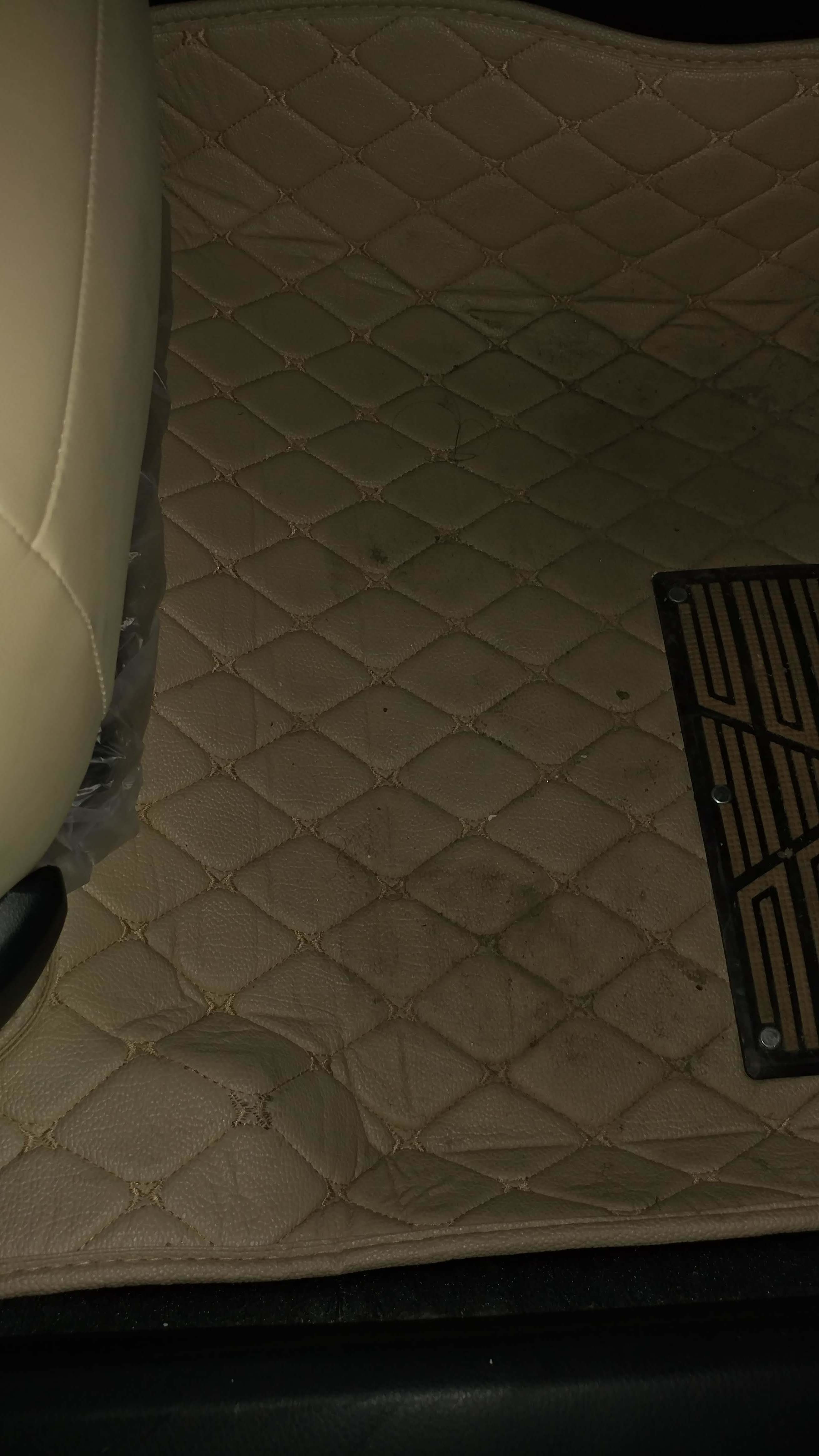

Before
After
No locks mean slippery floor mats can cause accident (God Forbid), specially when you floor matting already done.

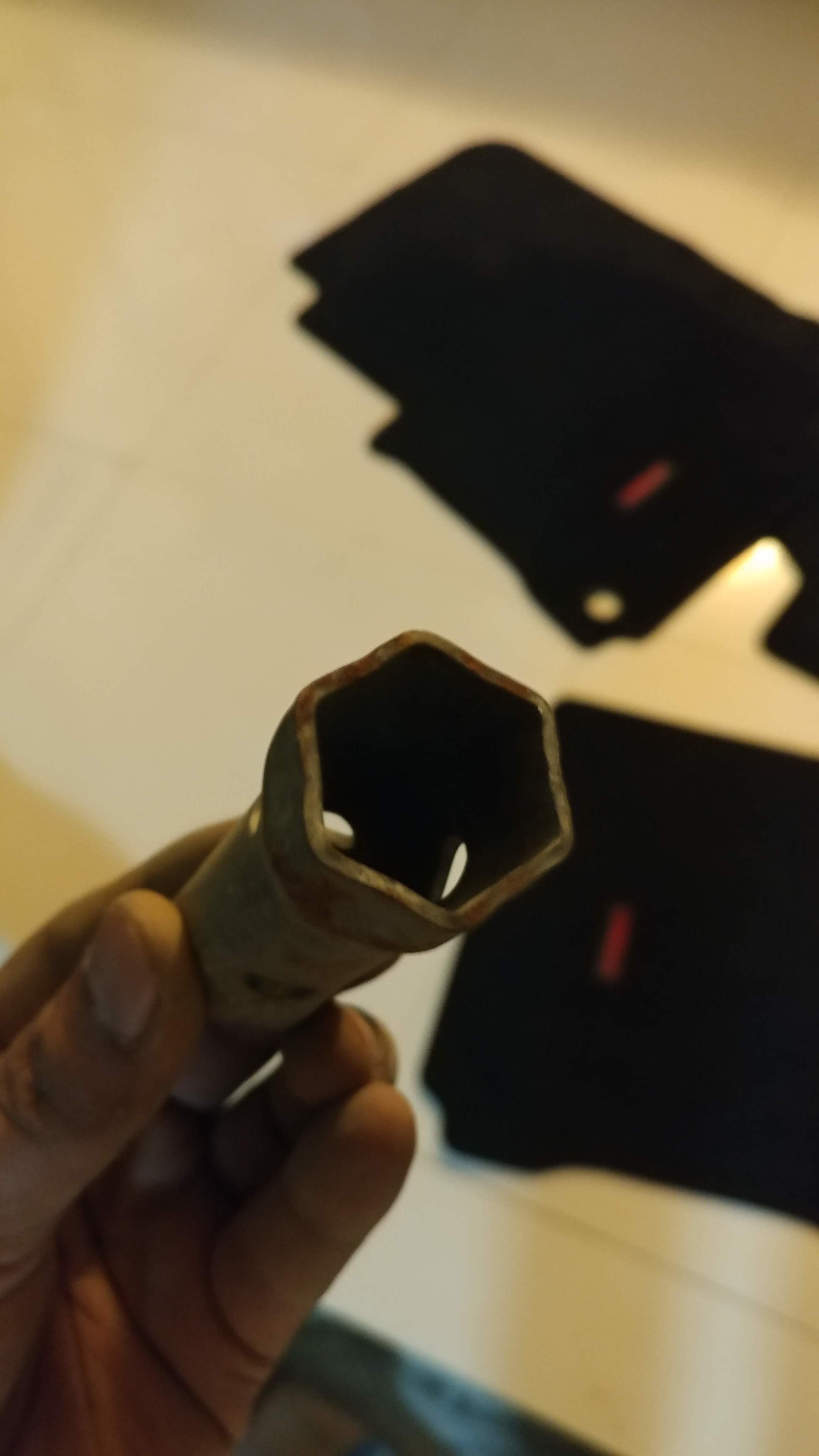

3) Any matching size socket spared in garage garbage,mostly available in homes
Step 1:

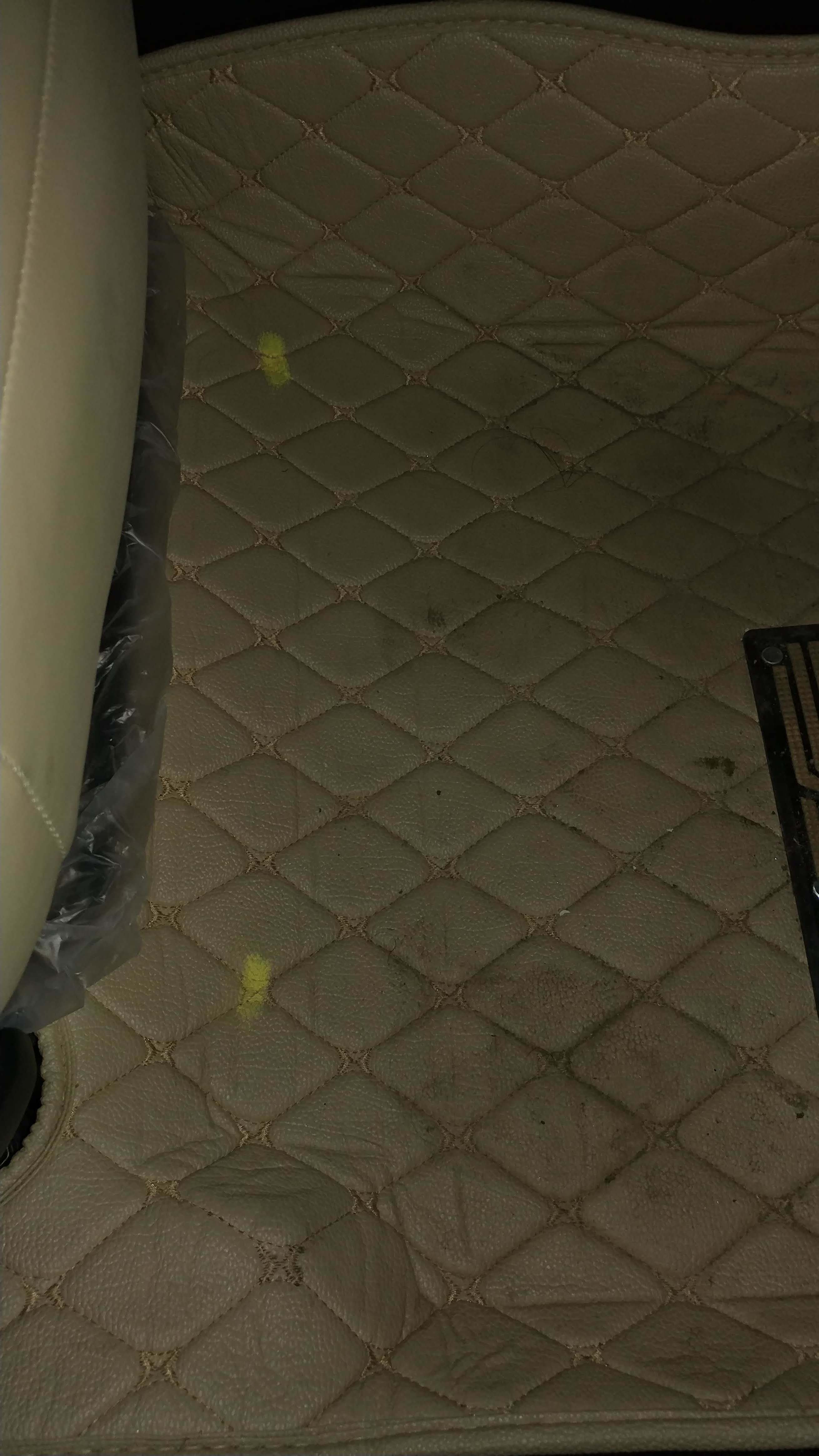

Put the Floor mat exactly where it should be, according to foot rest area

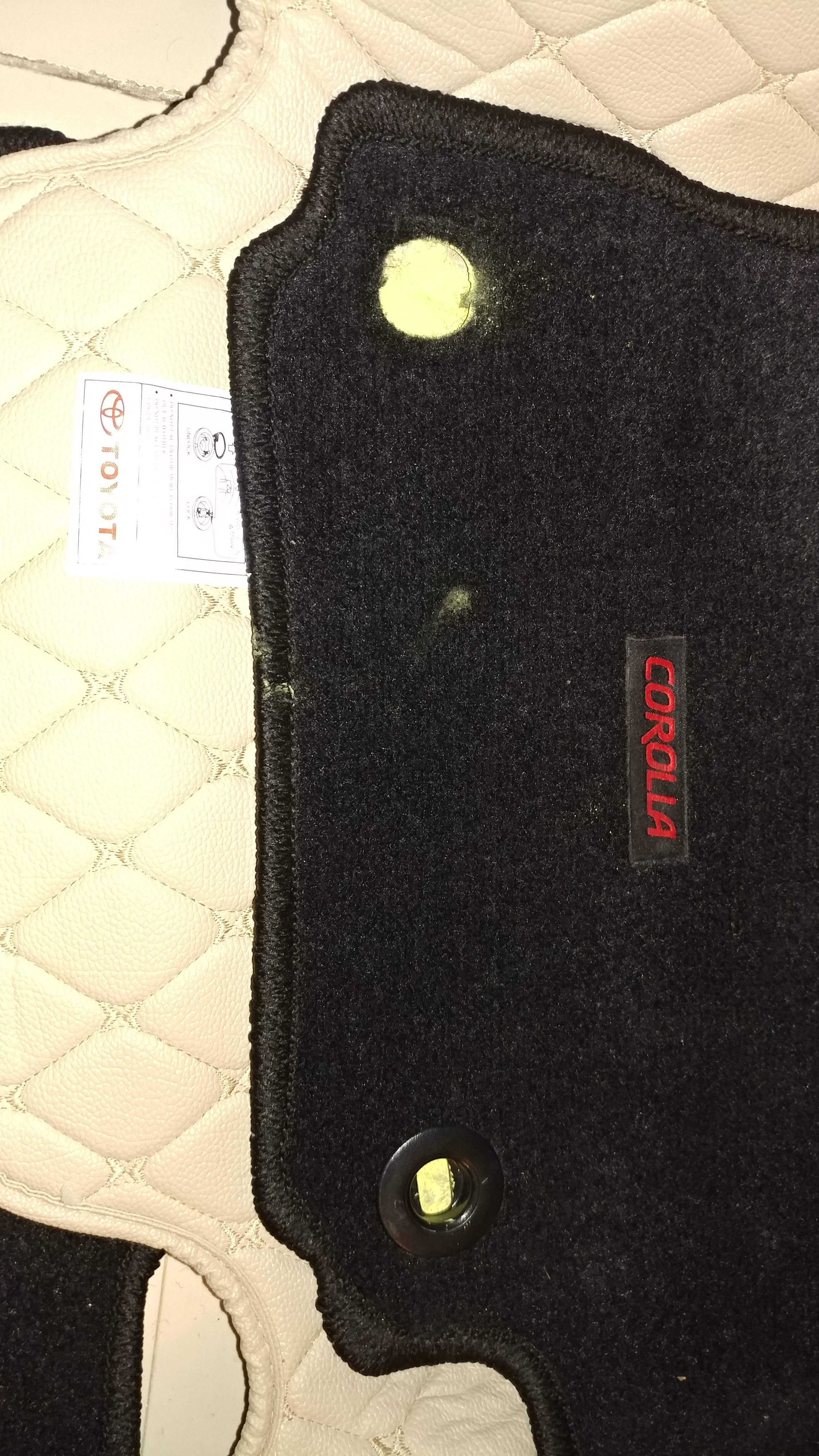

Step 2: Mark using chalk or marker feeling by hand

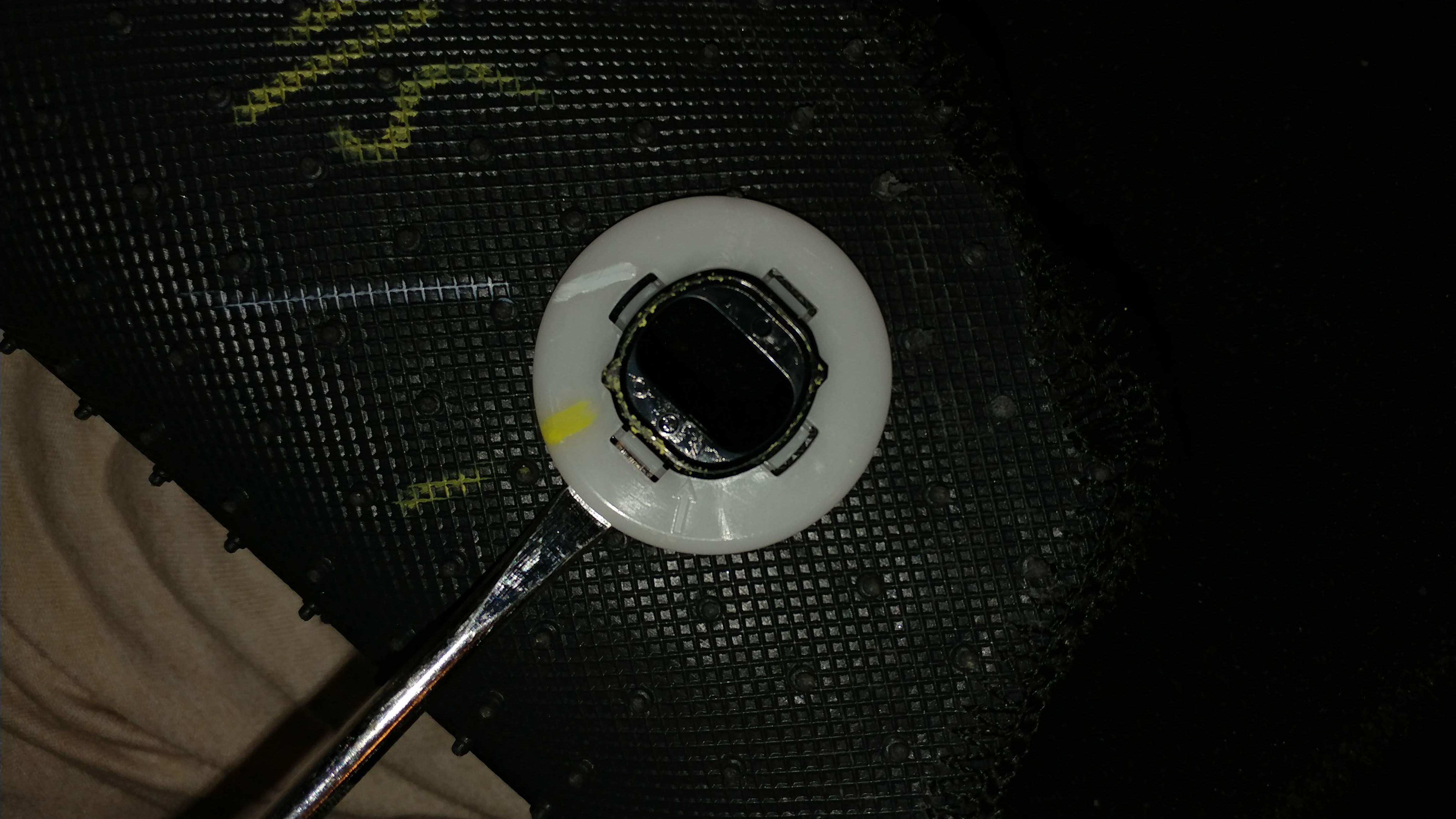

Remove the original retainer holder from floor mats if you have original floor mats (like in my case)

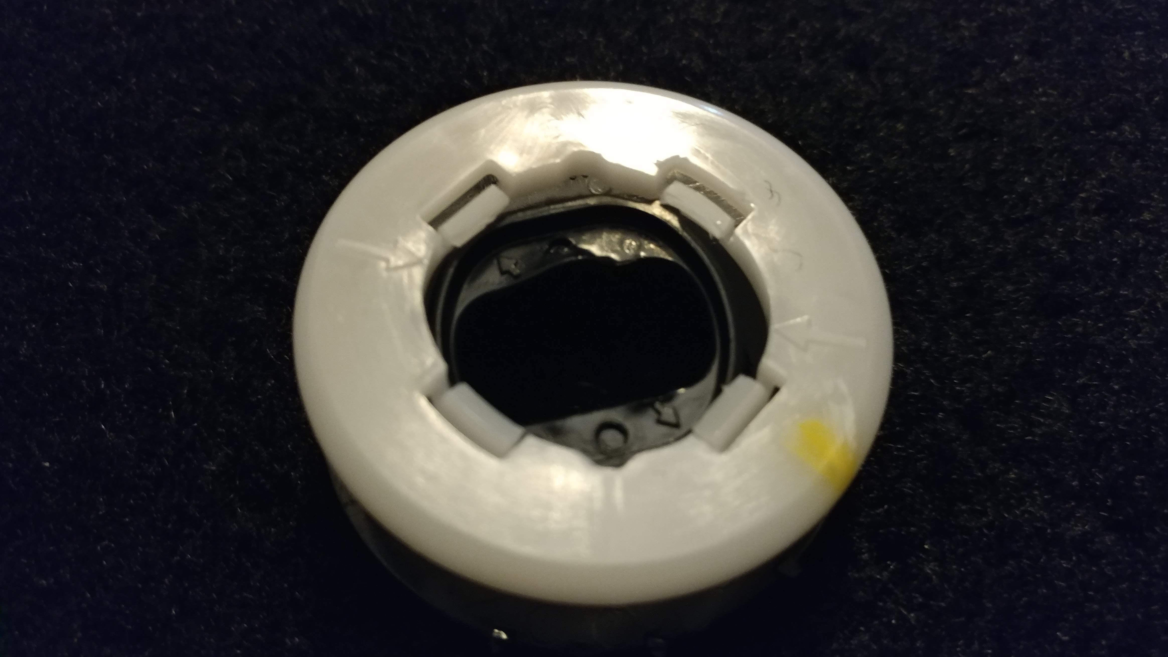

You have to insert flat head underneath the small white holder where its locked with black part and push upward , these are 3 step lock so you have to push each clipper one by one or it may break, i repeat move all white clips to second clip one by one and then one, and it will pop off from black holder.

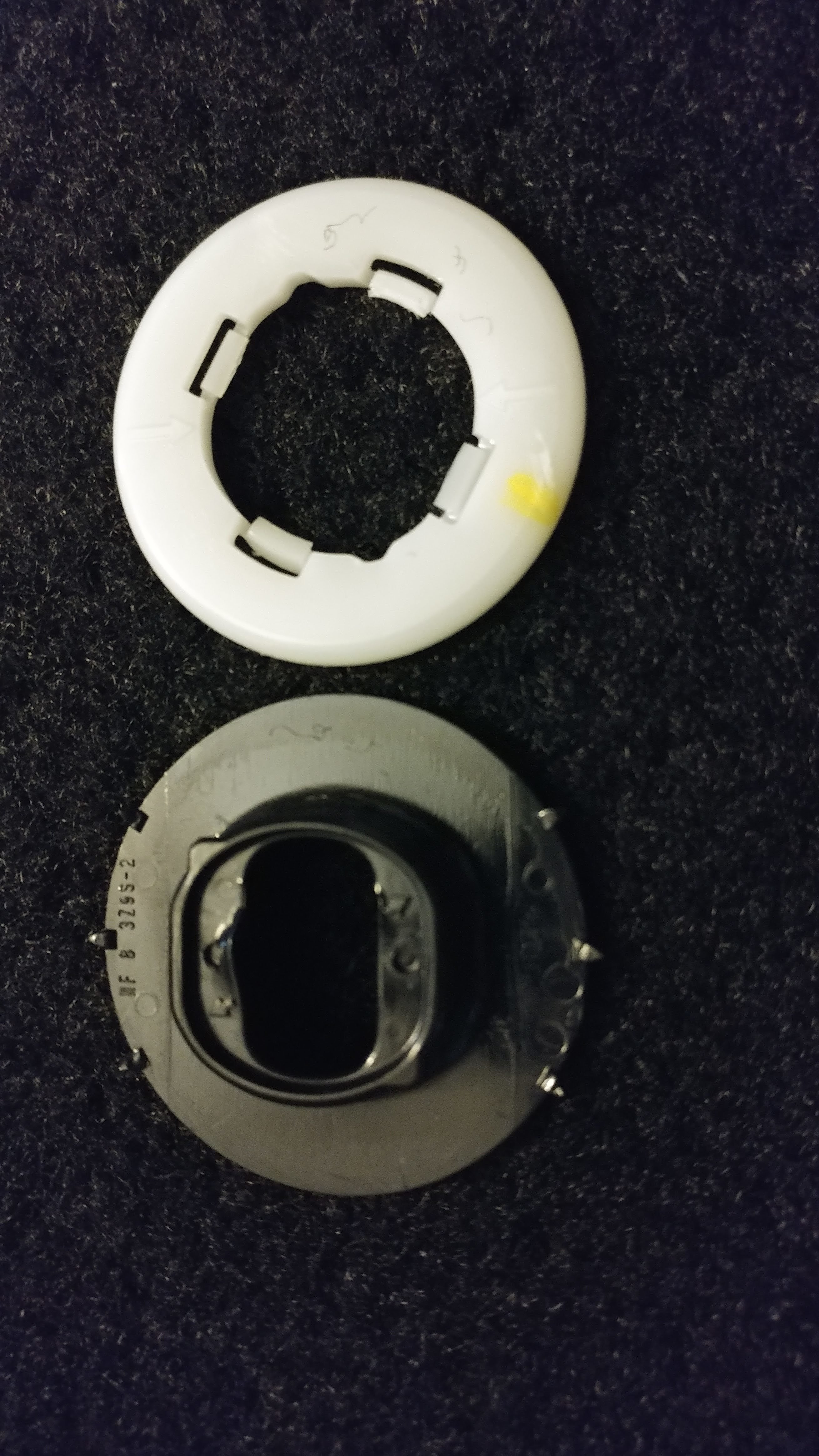

6

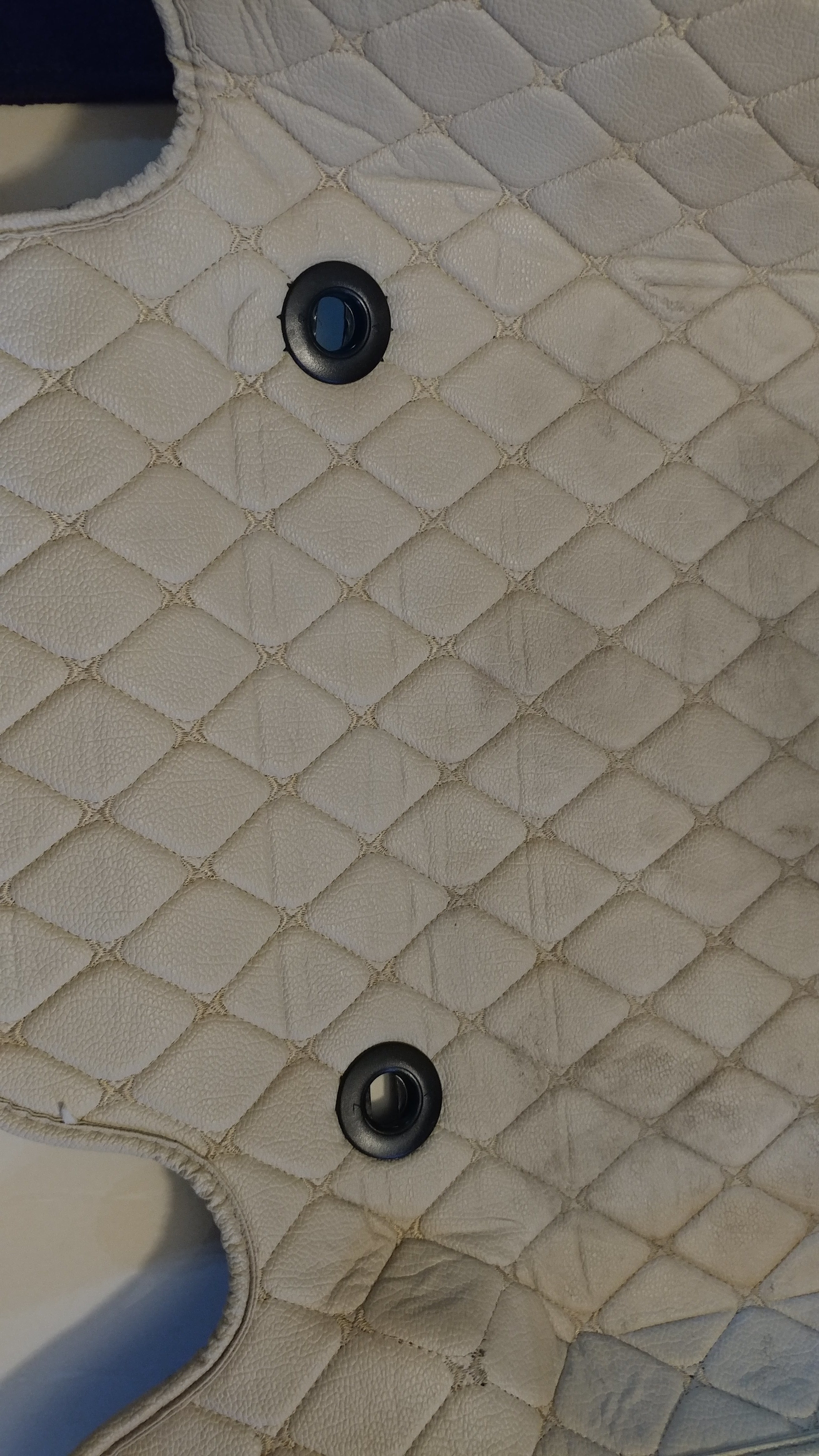

These are the parts we need for our install on new floor mat
Now match/align the markers after removing plastic tabs
"Yeh lein ustaad 1970 ka plug pana"

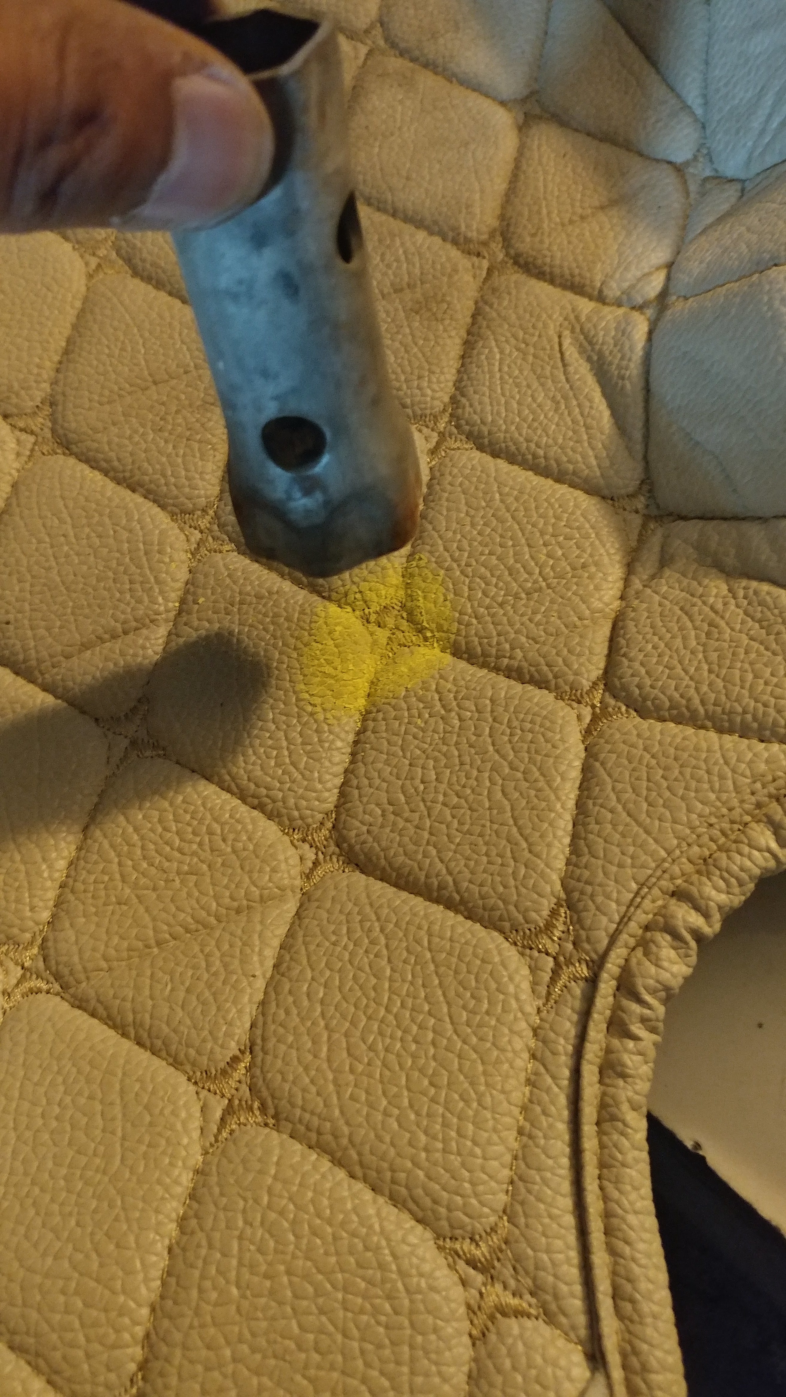

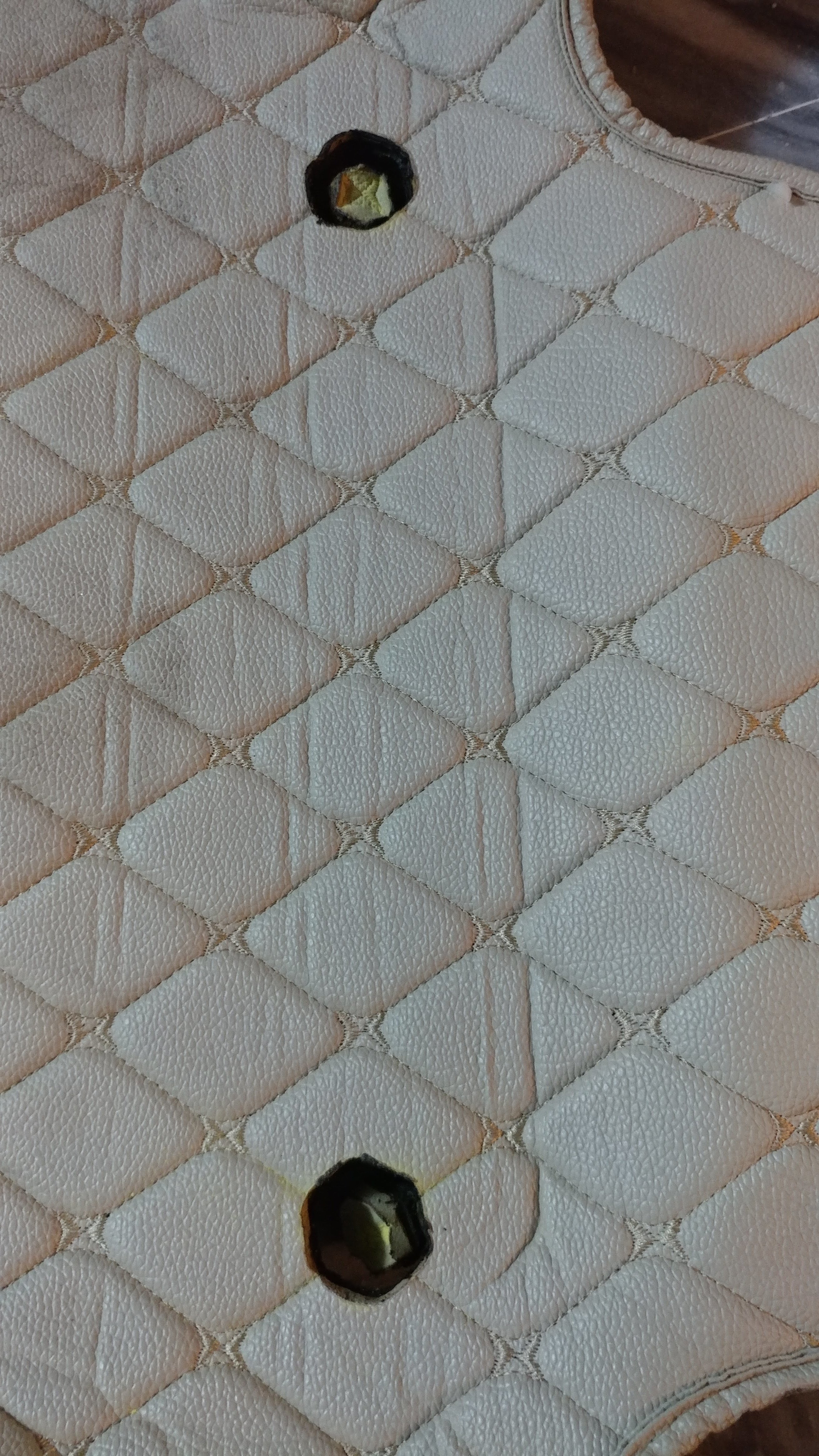

Match this socket with the hole you gonna make, Make it hot on stove and hold it with plier or something and make holes
Wow perfect....

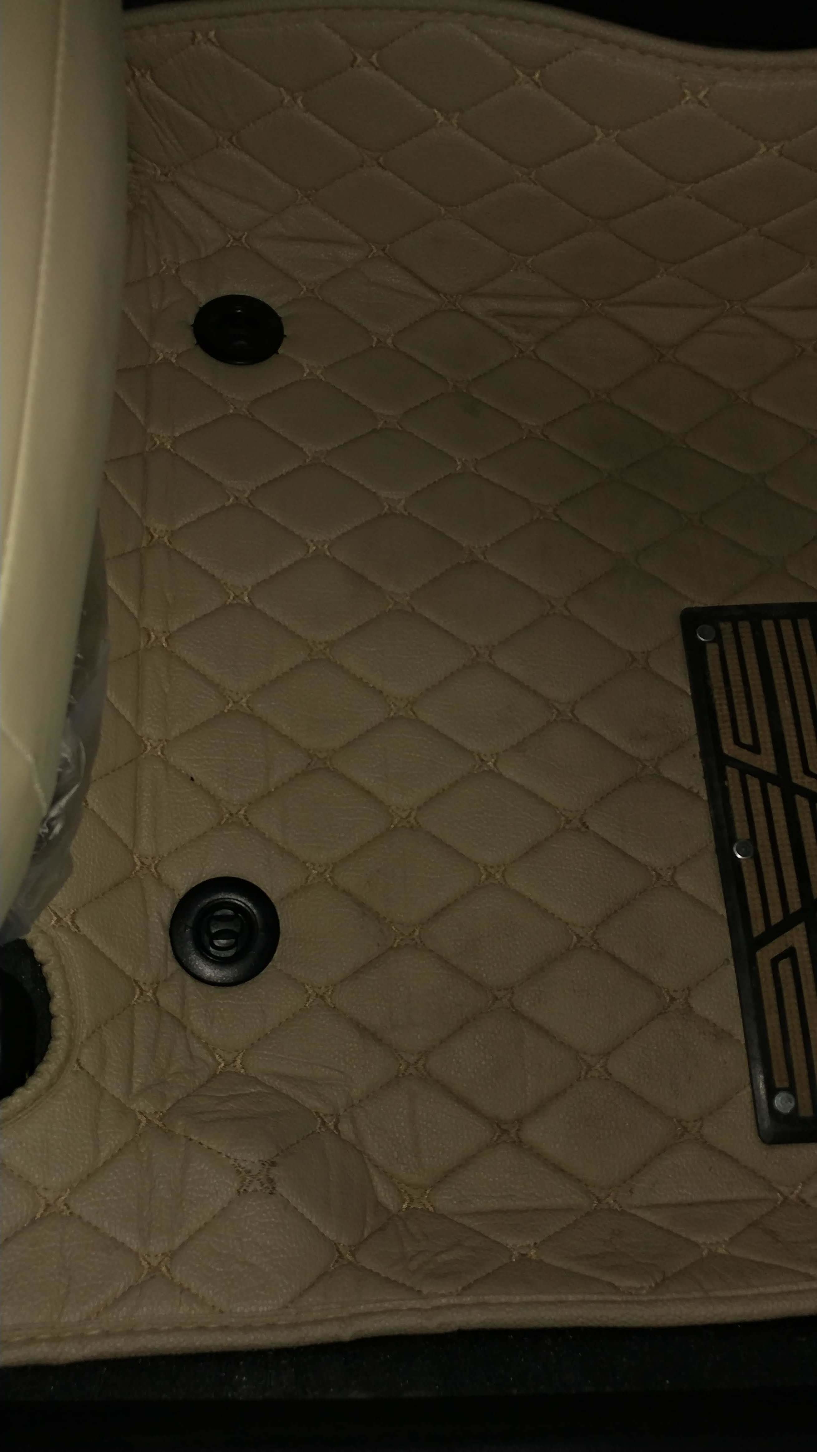

Put the tabs on new floor mats, keep in mind there are small arrows on white/black plastic, align them and push the white part from back of floor mat.
Voila!!! Neat Install
