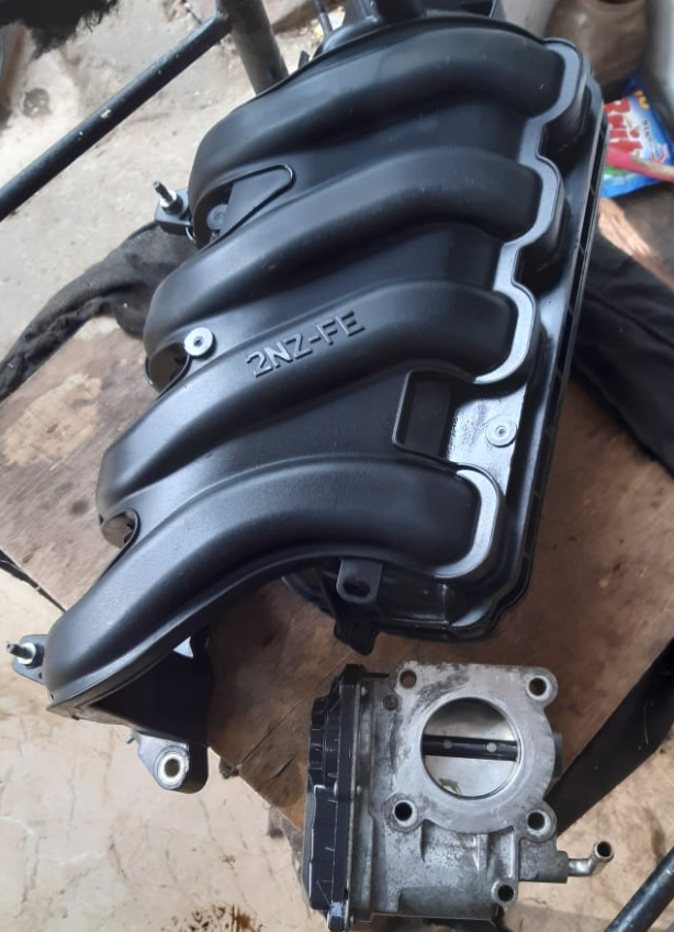

does this engine has a positive crankcase ventilation valve, what does this valve do, lower the emissions levels by recirculating the escaped combustion gases(blow by gases) into engine(From Piston Area) then recirculating them via PCV valve into the throttle body then into the intake manifold again for re-combustion.
these blowby gases could have been discharged into air as well but they are not environmentally friendly so they make them go through the combustion processes over and over again.
what if you can somehow separate oil from gases, then you would have clean intake manifold. i dont think, these vehicles are equipped with oil catch cans.
IN EURO 4 or 5 standard, this all is also done through ERG valves which recirculates portion of these gases from exhaust manifold into intake manifold via ERG valve and sooth buildup problems with time are worst and require periodic cleanup.
few companies manufacturer after market oil catch cans which are connected prior to ERG valves to separate oils from gases in order to avoid sooth buildup inside ERG valve, intake manifold.
same can be done with pcv valve, since problem related to sooth buildup is not as bad via pcv valve so they avoid this step. after market oil catch cans needs to be emptied after sometime.
