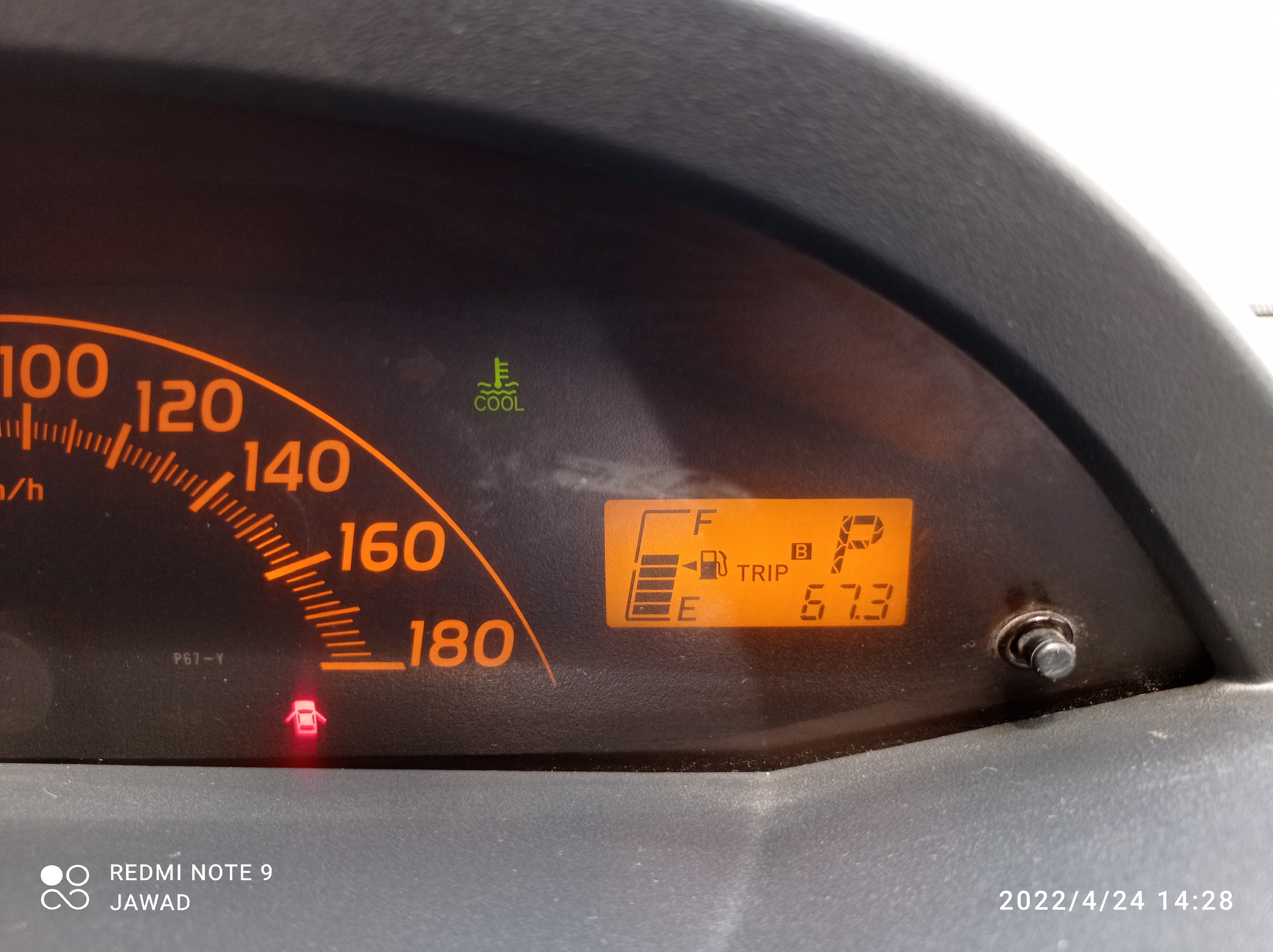

I have Vitz 2009 1.0 B Package , it has done 100000 kms, engine in quite good condition but facing fuel average problem since bought. In local drive within Rawalpindi-Islamabad it does only 8-9 kms with AC driven with extreme caution with very light foot.
I got its spark plugs changed with Toyota original Irdidium ones, throttle body cleaned, CVT oil changed, O2 Sensor changed but still its behaviour is same.

The only thing that remained untouched is CAT, since there is no checklight or error code in scanning.
