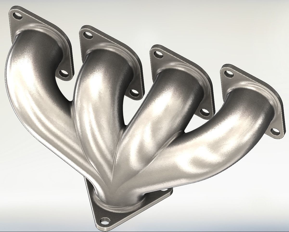

I was also expecting the same consumption.I got my catalytic converter, spark plugs and air filter cleaned yesterday let's hope mileage improves. Can u guide what do u mean by "get your exhaust manifold"?
there is no exhaust manifold in city as CAT is directly bolted to cylinder block rather than exhaust manifold
as mentioned above i was a bit on wrong side.
