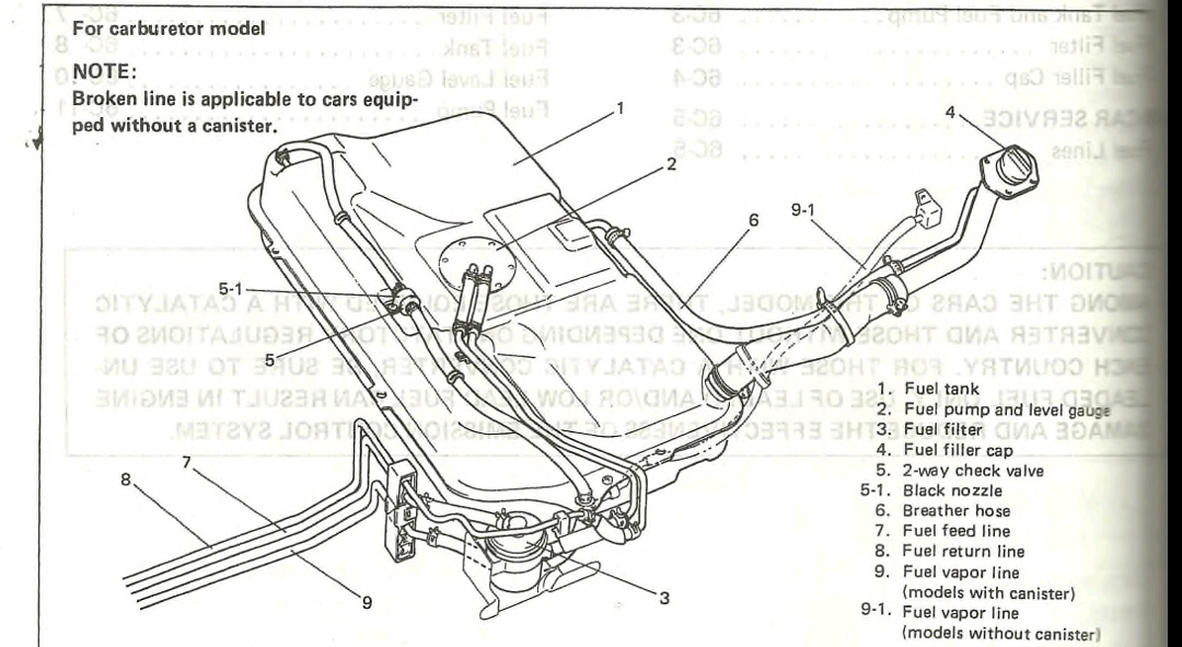

Hi, I have this weird issue of fuel overflow from filler cap after filling up fuel tank. Car is carb Cultus.
Normally I dont fill it till full but yesterday morning I filled it up till full, was not overfilled, stopped on auto. After filling up went to office. Car was parked outside under sun. When I came back in evening there was fuel overflow stains on paint. Basically fuel overflowed from cap. This has happened once before as well but at the time the tank was slightly less that full. I have checked breather pipe and its not clogged.
I'm going to change fuel cap as well but I want to know what could cause fuel to overflow from filler cap?
