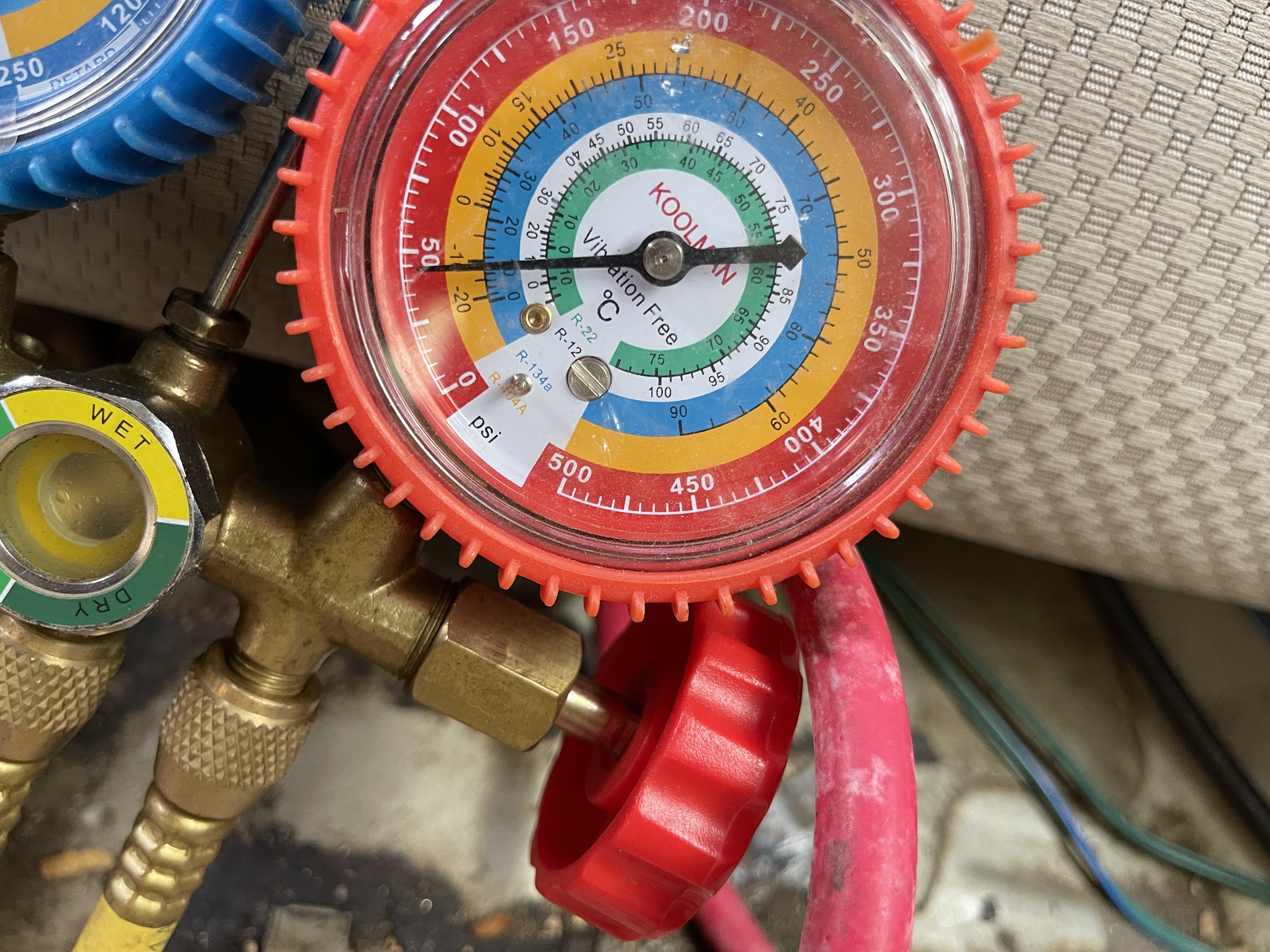

are you testing pressure at pump under the rear seat.??
i'd recommend to test at the injector rail - under 3 conditions. at key turn, at crank, at idling & throttling.
at key turn, at idling it shall remain constant, at throttle expect bit variation to correct that if worried, please change only purge valve inside the pump., if available.
