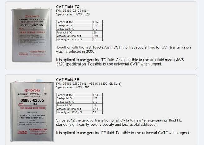

Most laymen wudnt know and thats a fact that no cvt fluid comes as a 0w16.
Cant read on the bottle 0w16 which you posted?
if u didnt guage or guess why wud you call a cvt fluid 0w16?
The specs do posted above do not reflect a 0w16, had you googled you wudve noticed that merely similar viscosity at 100c does not mean 0w16. Thats why a motor oil with a viscosity of 14 cst at 100 will be 0w40 while a gear oil with similar viscosity might be 75w90, so just saying low viscosity cvtf is 0w16 doesnt make sense.
You said in your post "i gave viscosity value" so i was asking how you "gave" the viscosity value
