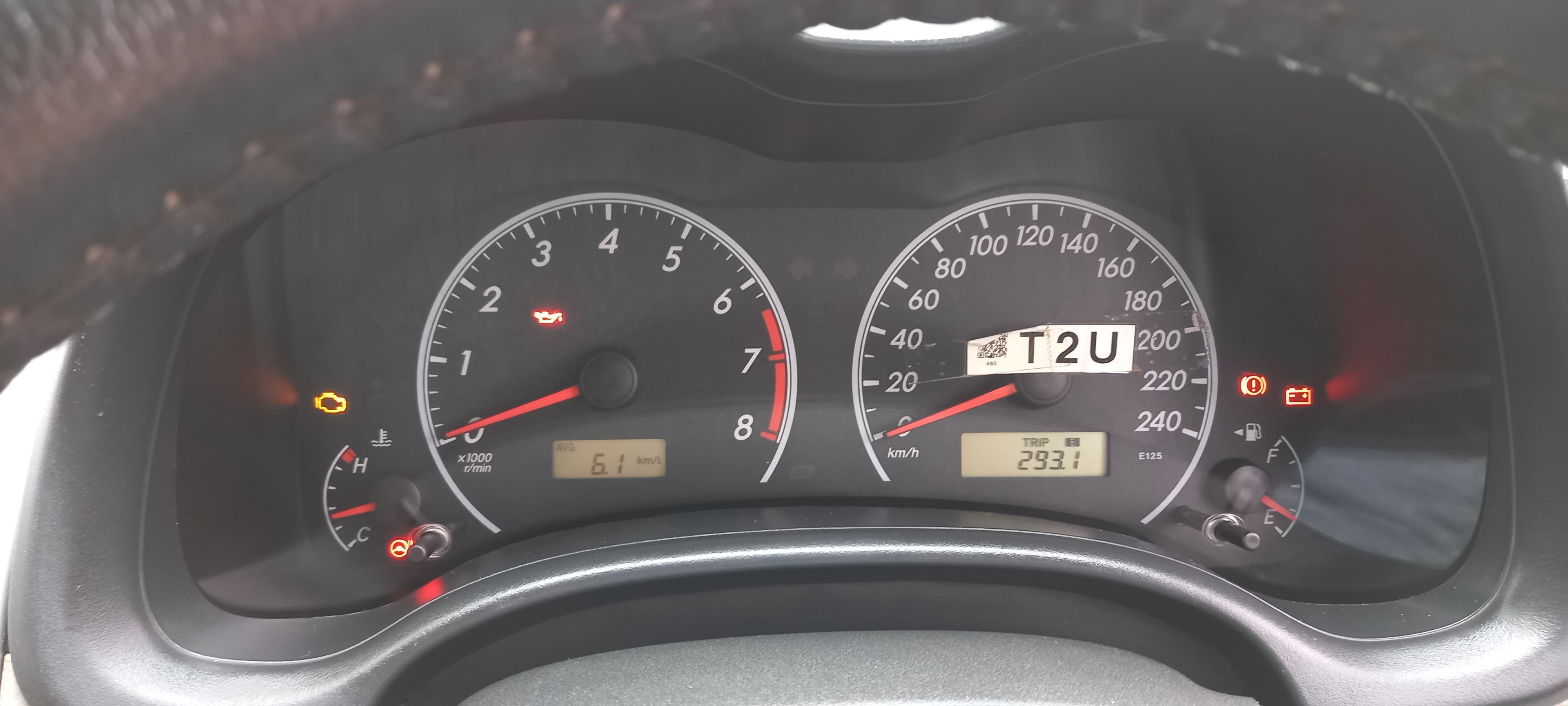

Salam All I cleaned my Gli 12 ODO meter but my fingure touch 2 of the needles and they lost their actual position. Now its something like this when i hit the switch.Temp + fuel needle both changed its initial position.How they can be fixed ??
Thanks
open the cluster again, remove the needles and put them back to zero.
Done !! Thanks
Cluster openened.. removed both needles. Just pulled them out with very soft hands .. put them back on initial position n all set.
