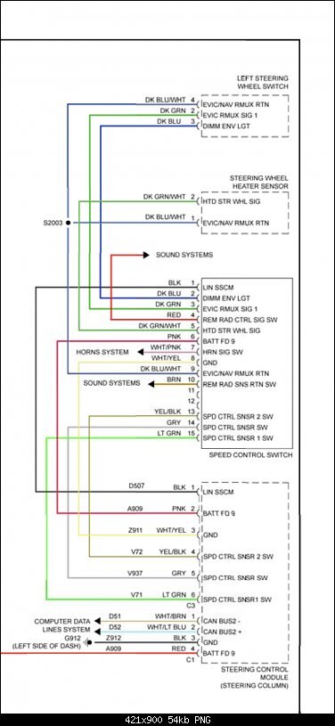

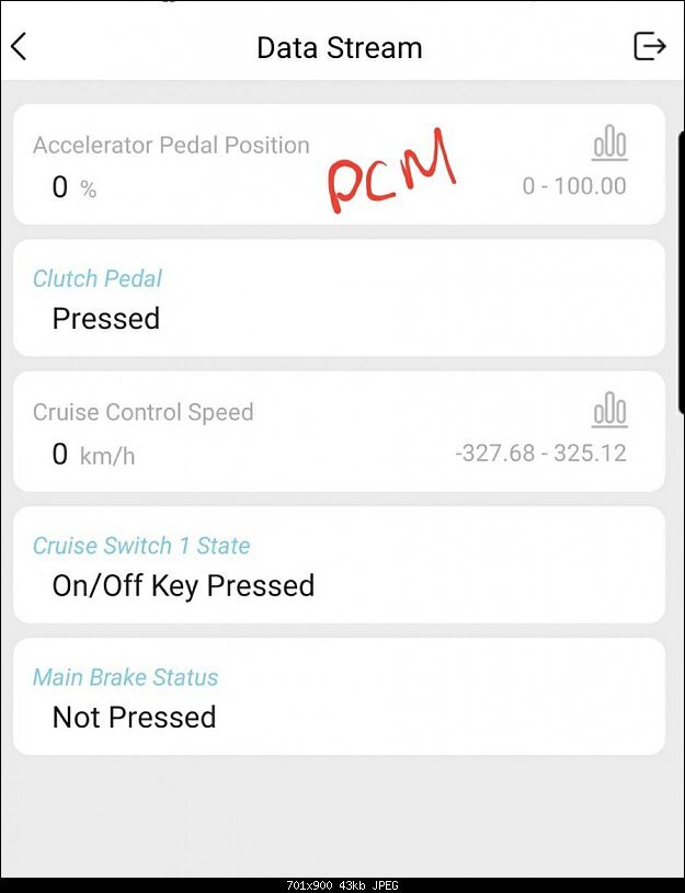

The scan tool does show that PCM registers which button is pressed. The switch is a simple multiplexed switch with a resistor network that passes data through LIN. My understanding is that if PCM and SAS modules can see which cruise control button is pressed they should trigger it.

Interestingly if you see my scanner showed the clutch pedal as pressed. The car is auto and I think the scanner is showing signal 1 or 2 as clutch. If its pressed the cruise will not turn on I guess. I have ordered the brake switch because it was 33 bucks oem. Too bad that I can't find the CRD ECU diagram to trace those signals.
