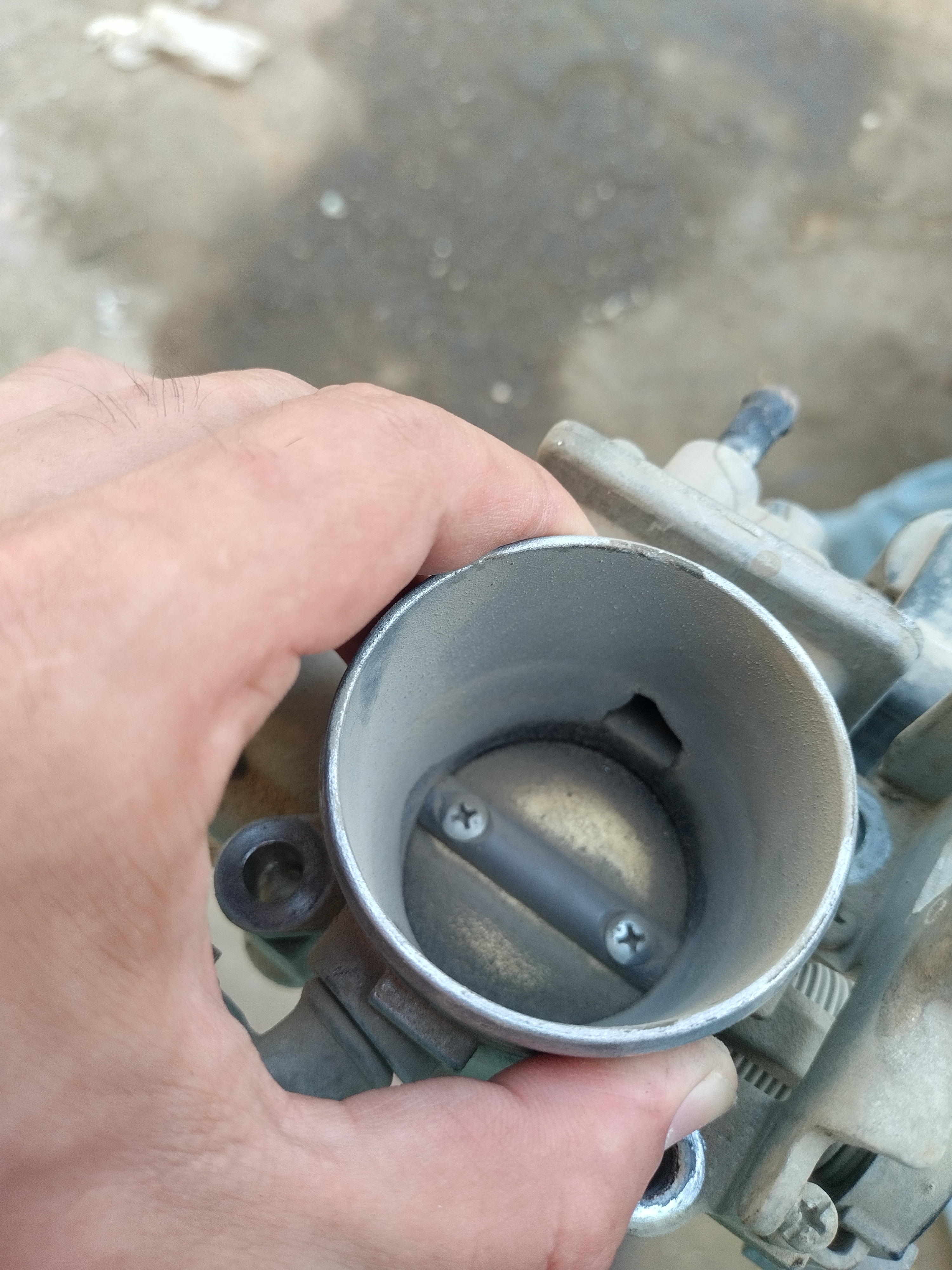

The throttle body had heaps of dirt, it had never been tuned
