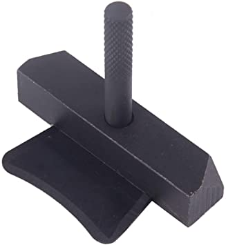

thats why you use heat and the gasket separator slugger tool. Most engine assemblies have a pry space or advise to use a sharp tool which is hammered into the joint of two assemblies - usually its the sheet metal oil pan.
This is the tool, you can make one too - or improvise on something like a stiff and sharp scraper. This tool is hammered into the flange surface and worked around a bit - which then lets go of the majority of the adhesive sealant.
For machined surfaces, find a pry surface or a hammering surface , All manufacturers provide that or have some holes where you can screw something in and use that to pull it apart. Like how you pull out a transmission oil pump. It has blind threaded holes for the job.
