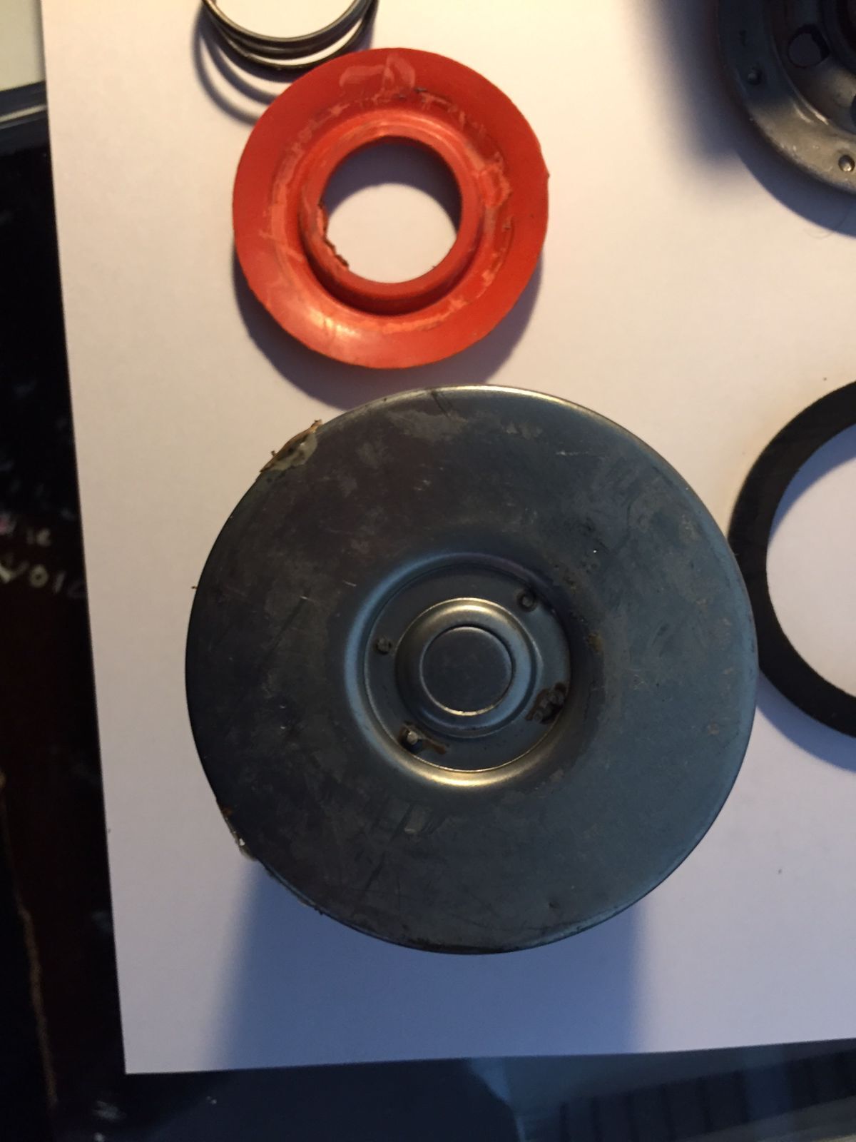

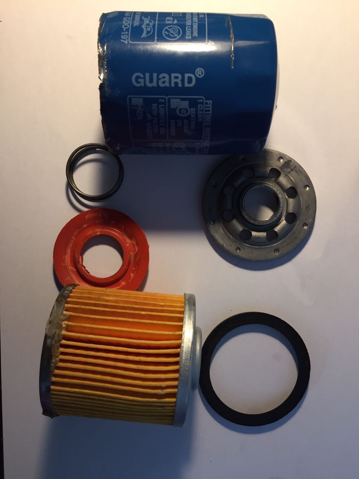

Bought this oil filter from METRO a while back. I was planning to use this however had a oem filter lying around so used that instead.
Guard 486PKR
OEM 1800PKR (forgot exact)
Filtration Area: 1795 sq. cm approx (I calculated area of one side and multiplied it by 2)
Trying to find dimensions of OEM Honda filter online. Will post filtration area of that too if I can find it online. If not, I'll tear open a Honda Thailand oil filter (used).
