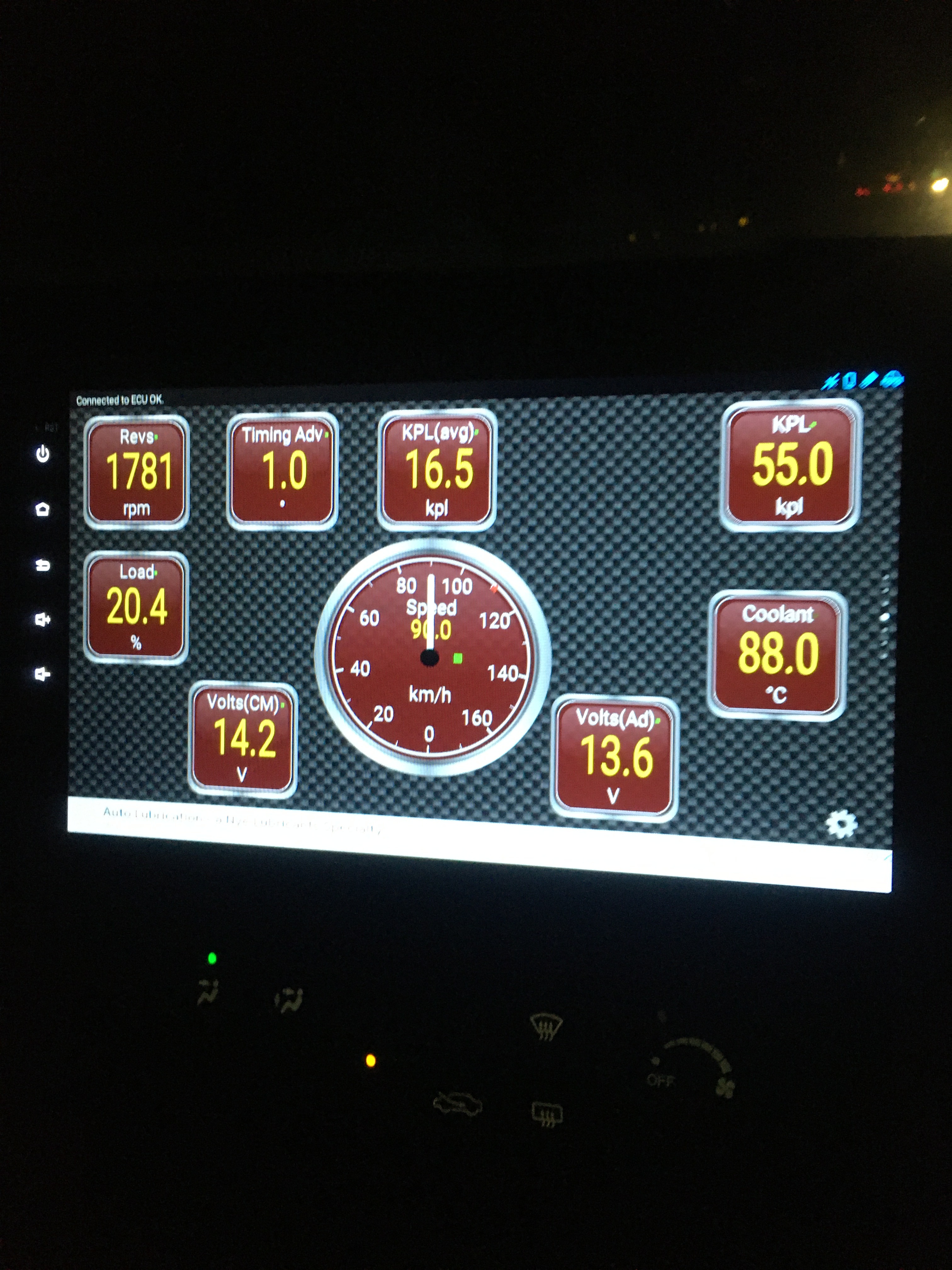

I have installed Cruise control and padel shifters recently and avarage increase when using these
I now get 16-18 km/L on Motorways and 10-12 Km/L on city (both with AC), but i have installed new o2 sensor and my cat's honeycomb is also broken
