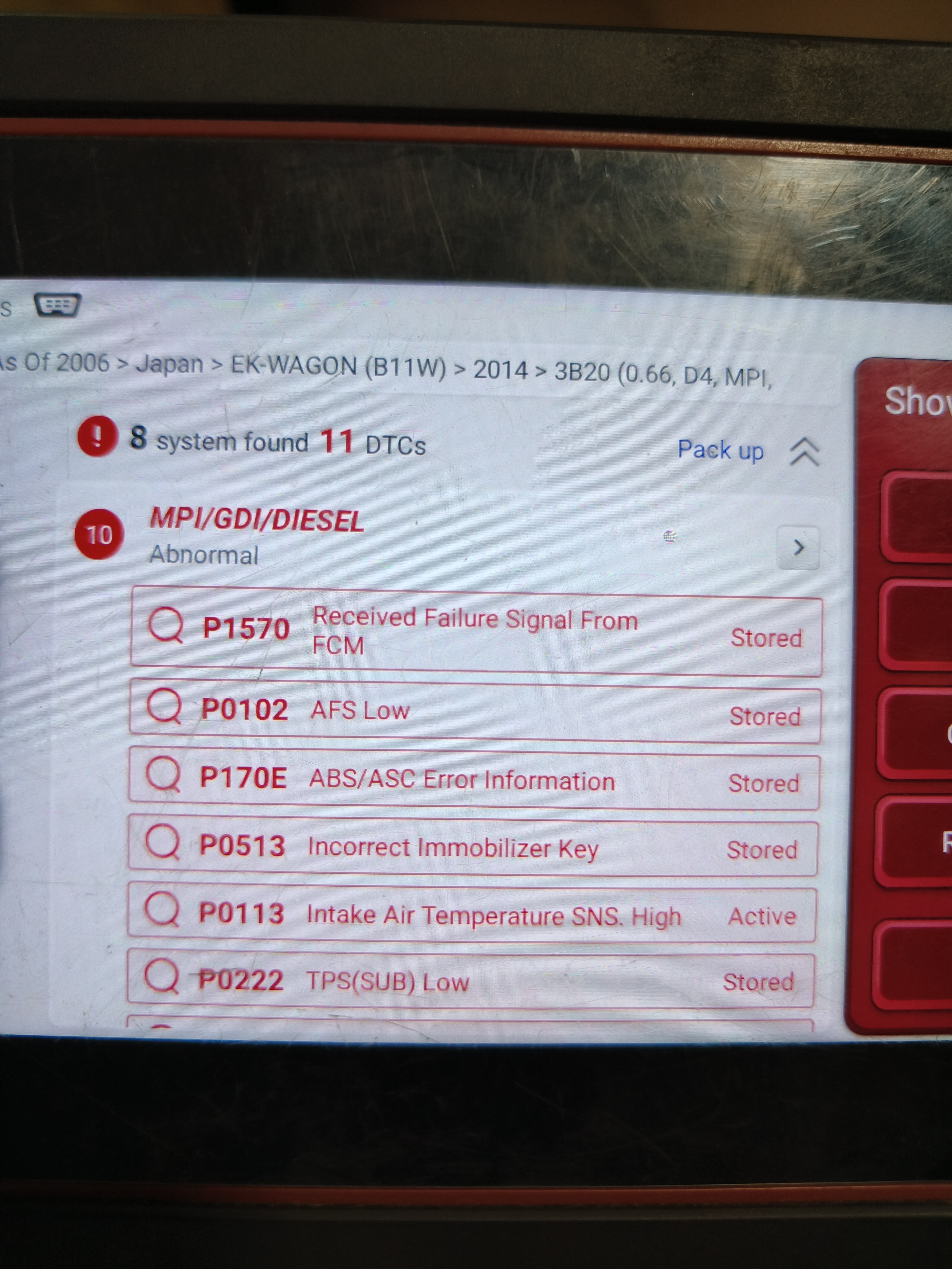

Car: NISSAN DAYZ 2015/19CAN SOMEONE PLEASE HELP ME UNDERSTAND THESE CODES (attached ) AND TELL ME THE WAY FORWARD. I HAVE BEEN USING THIS CAR FOR past one and a half year but recently I have been facing problems related to slow pick up and gear shifting on slow speed.
I assume these codes came back after clearing them.
You need to check if there's any vacuum leak, need throttle body and MAF sensor service.
