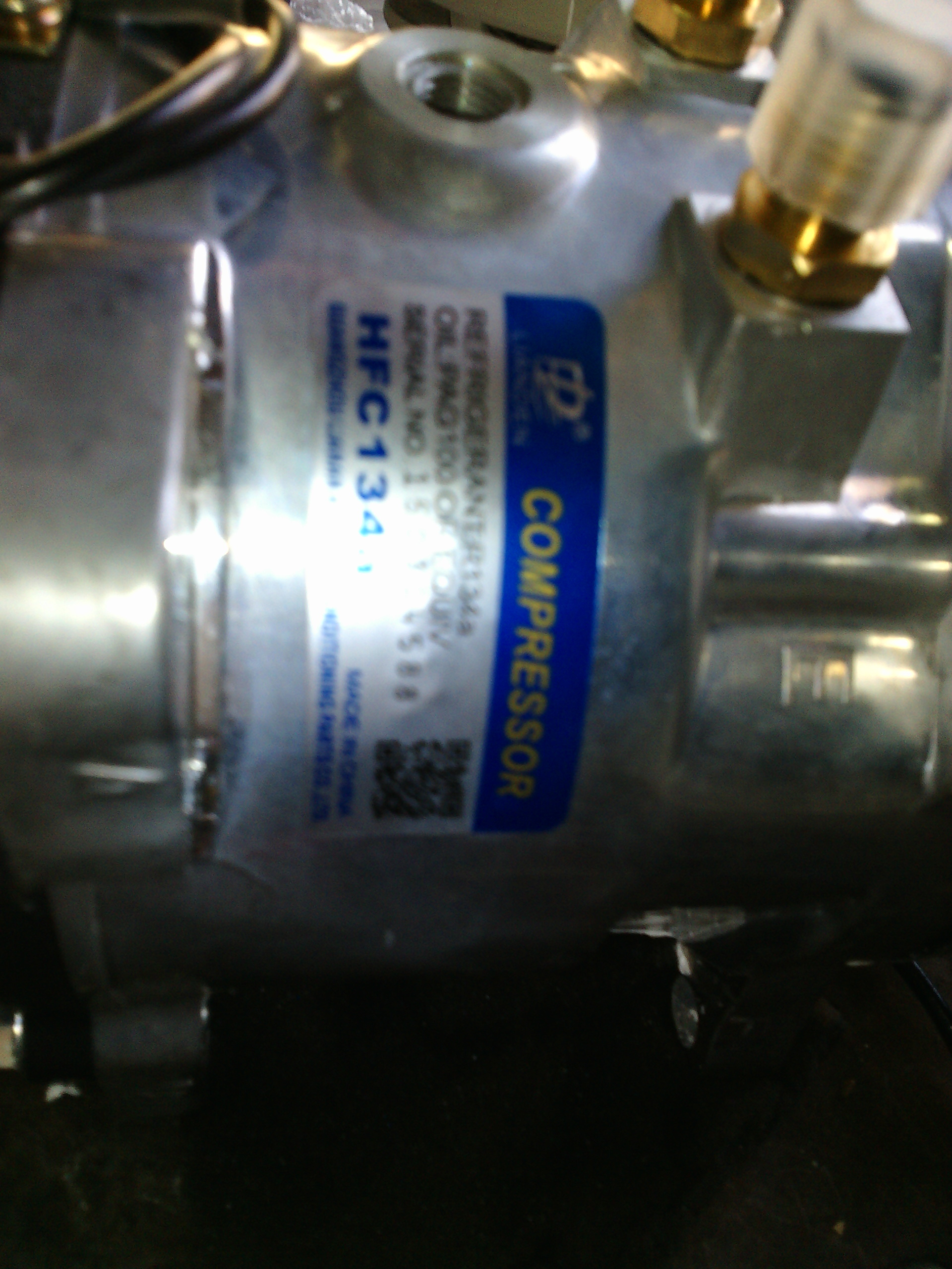

But Price u r telling is quite shocking for me. As i have done some times ago but one another guy my former Sales Manager also experienced Piston based Compressor in his 2010 GLi on my advice. Only Difference is that I suggest him SANDEN 507 but he opted for Chinese imported LIANDEN Brand.
Initially I was not agreed for changing/using any Non-Sanden brand and refused to supervise or help him in this project decision but on his insist, after checking performance & do some homework, i found it quite Reasonable and told him to swap complete A/C unit
Website is: http://en.lianan.cn/
I could supervise him & a/c wala only over phone but it went OK

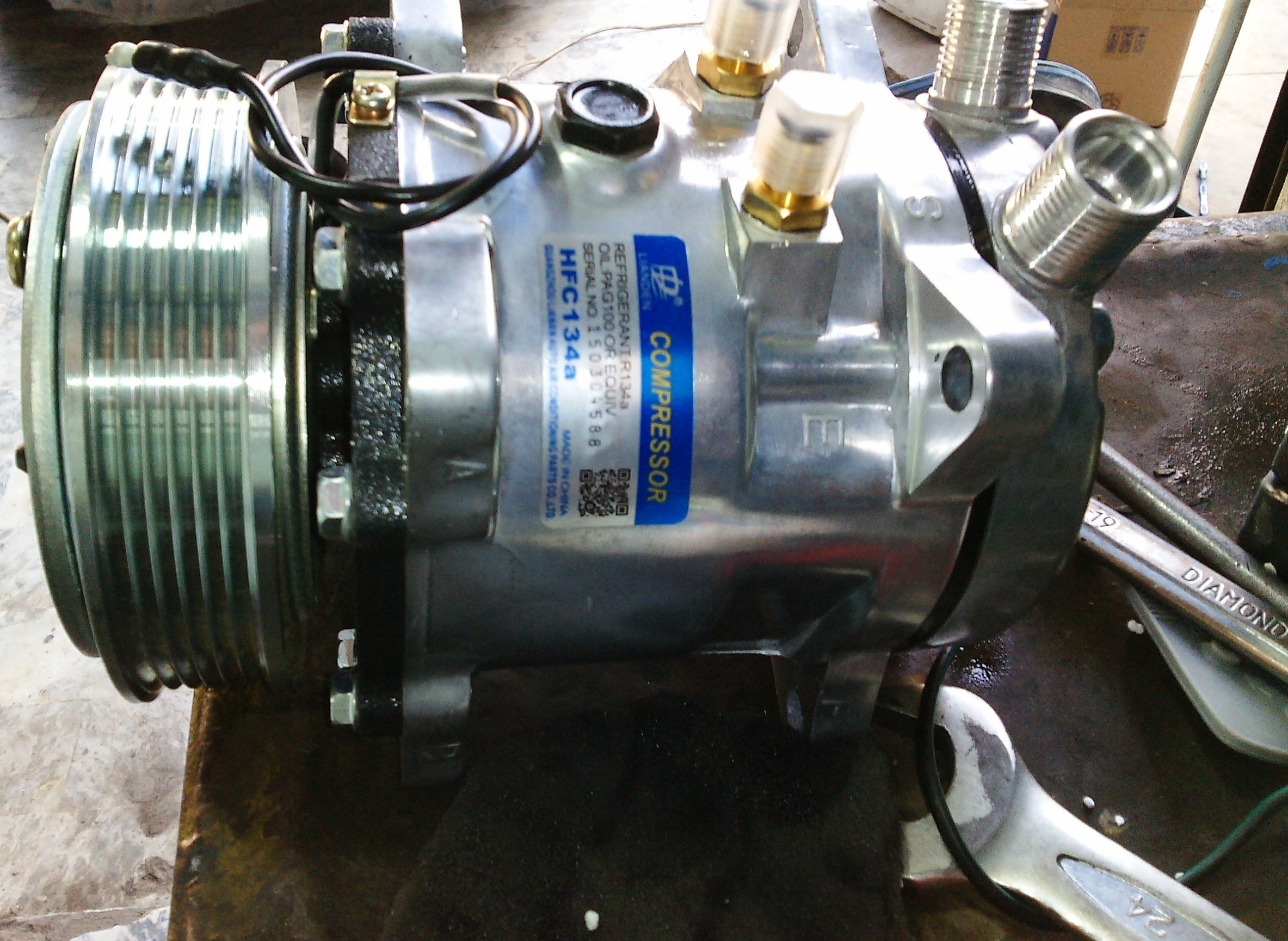

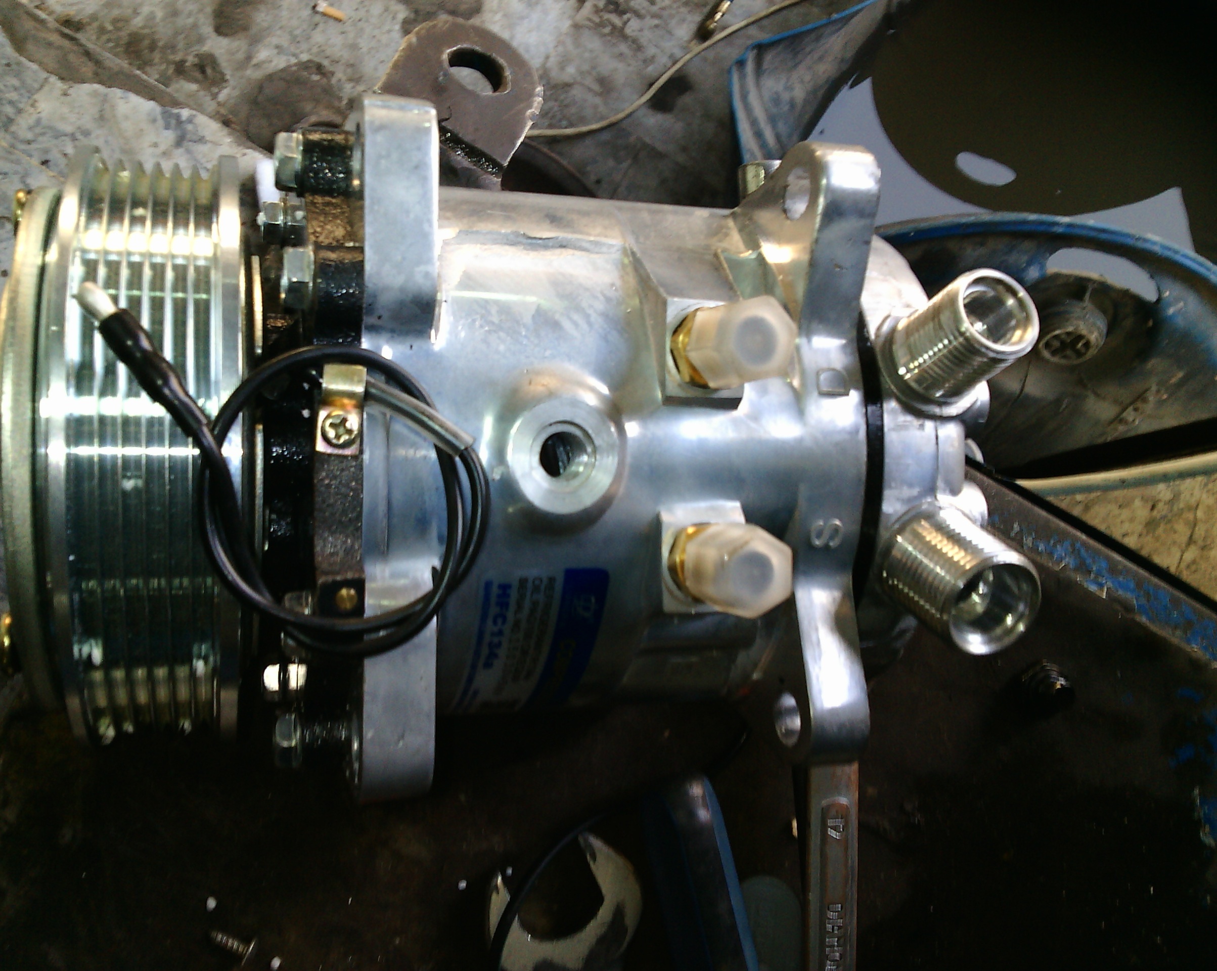

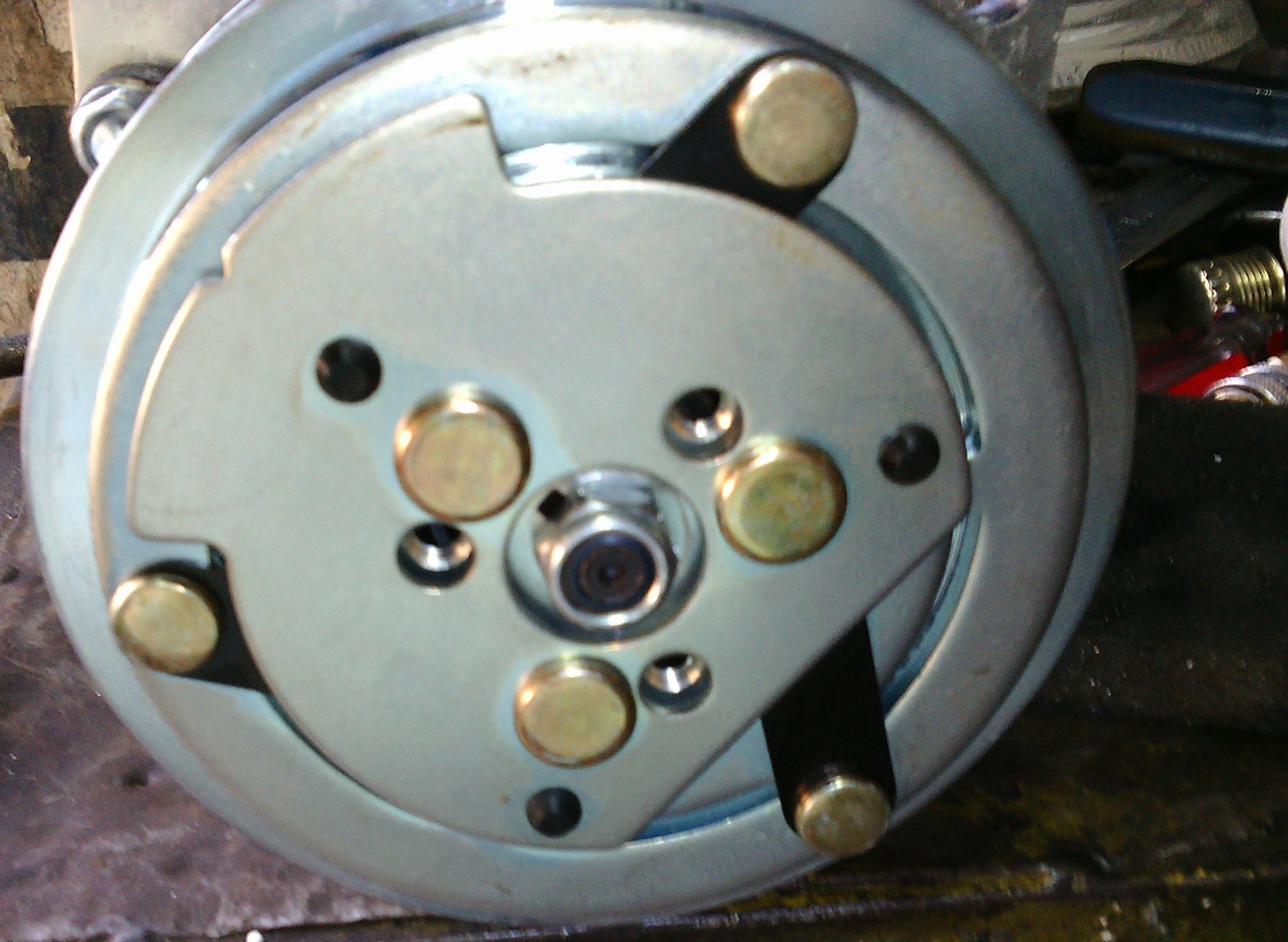

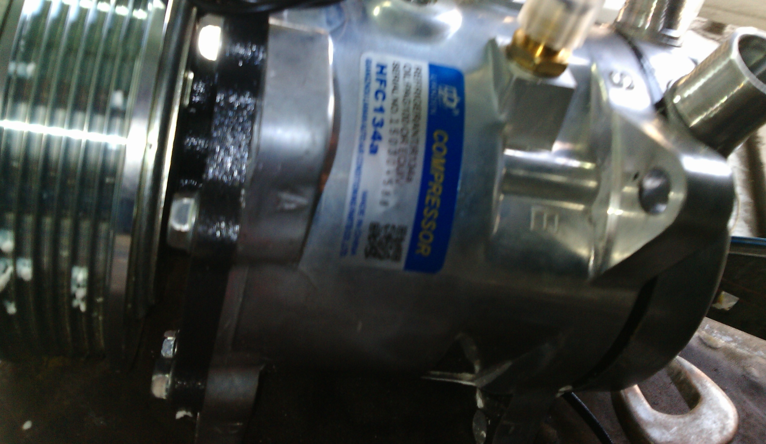

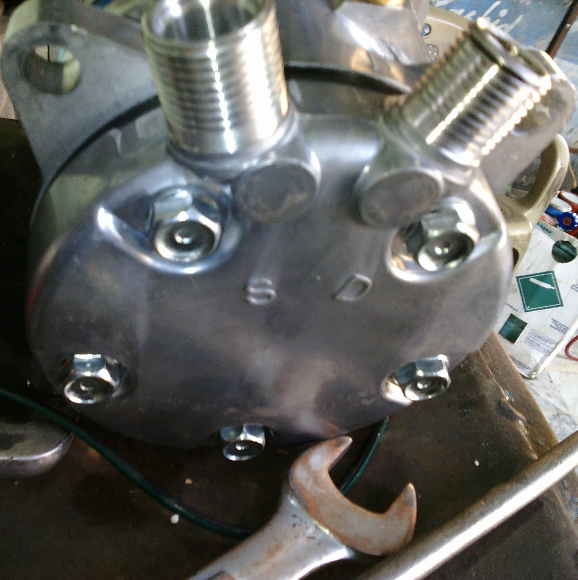

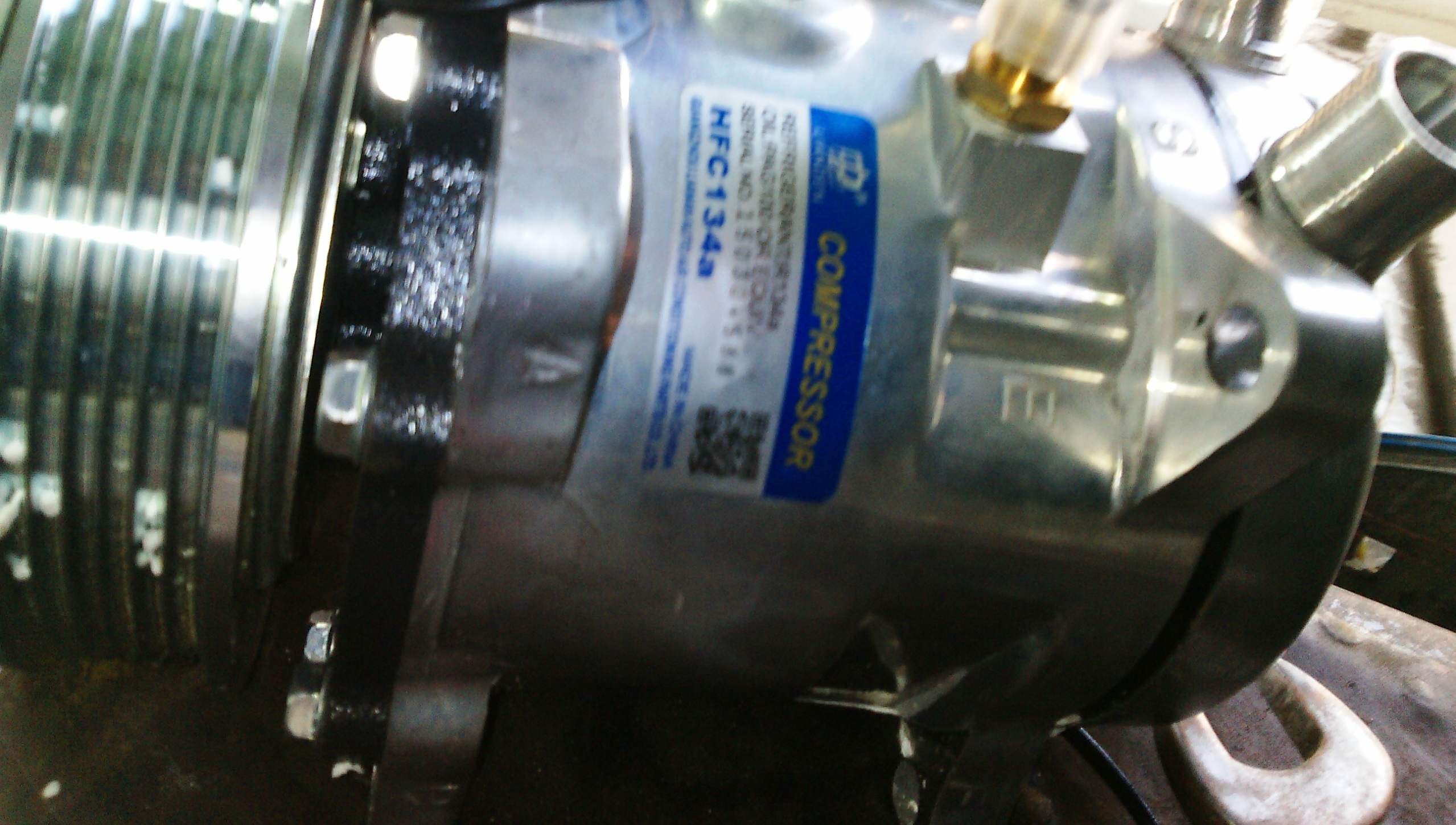

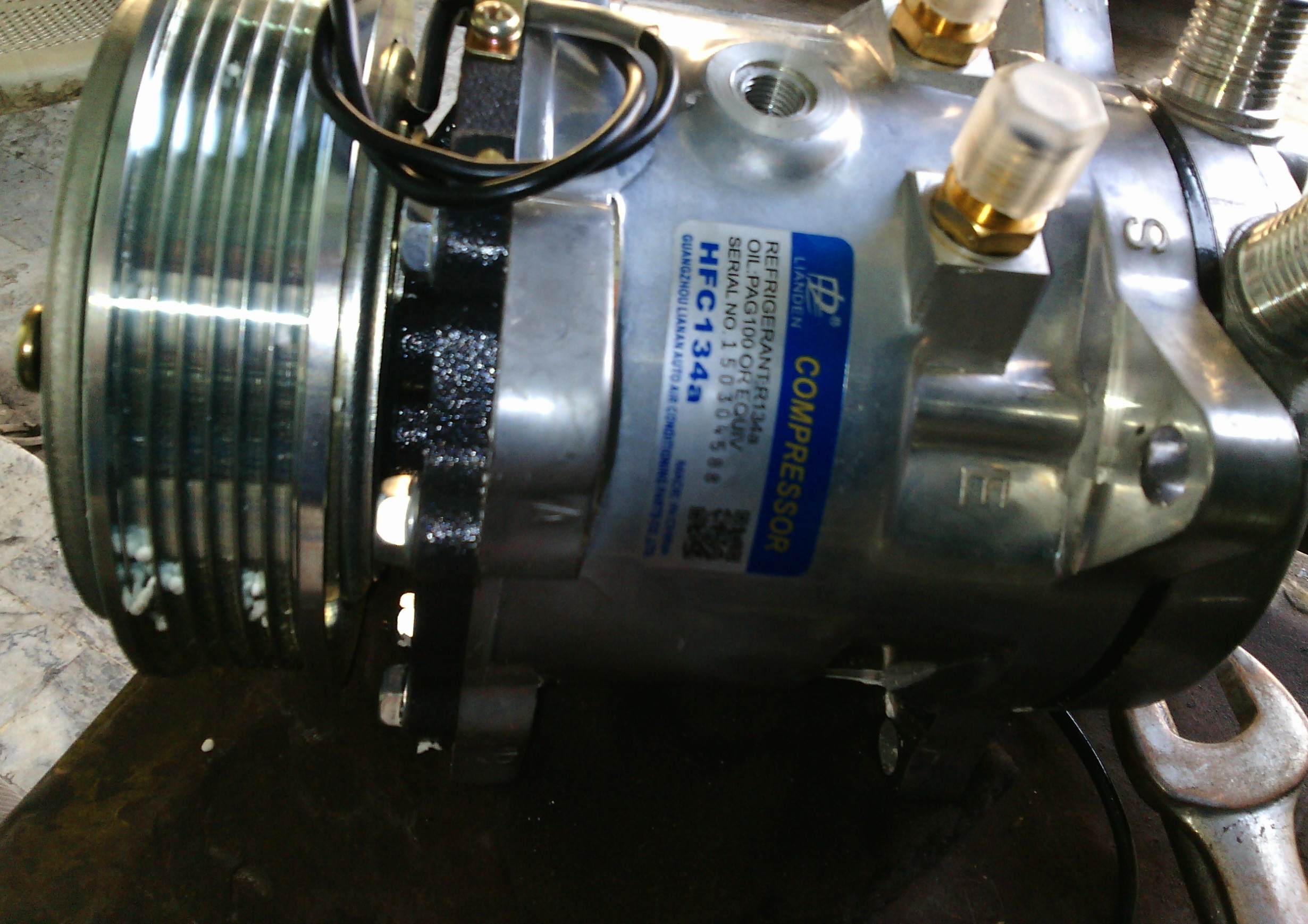

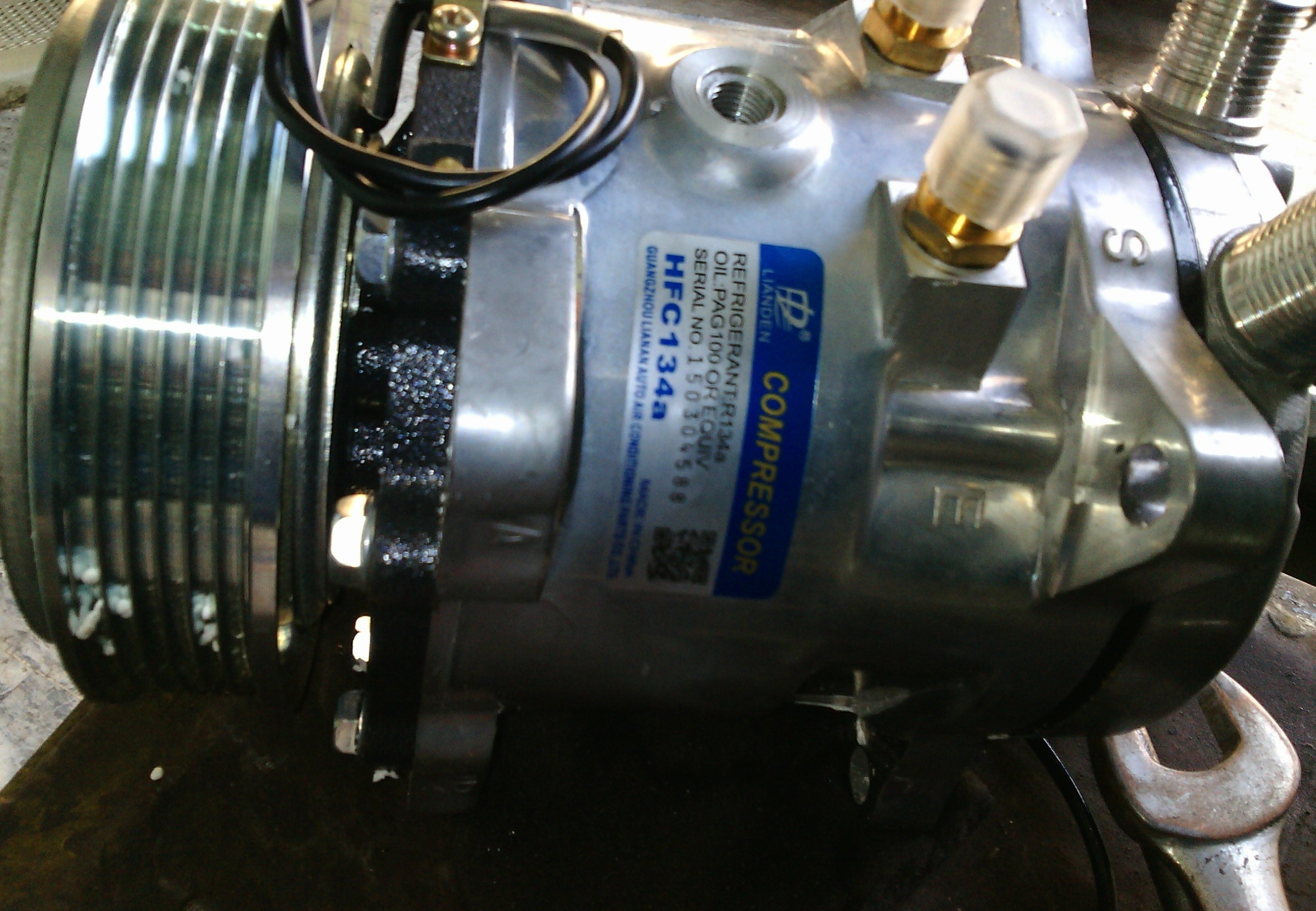

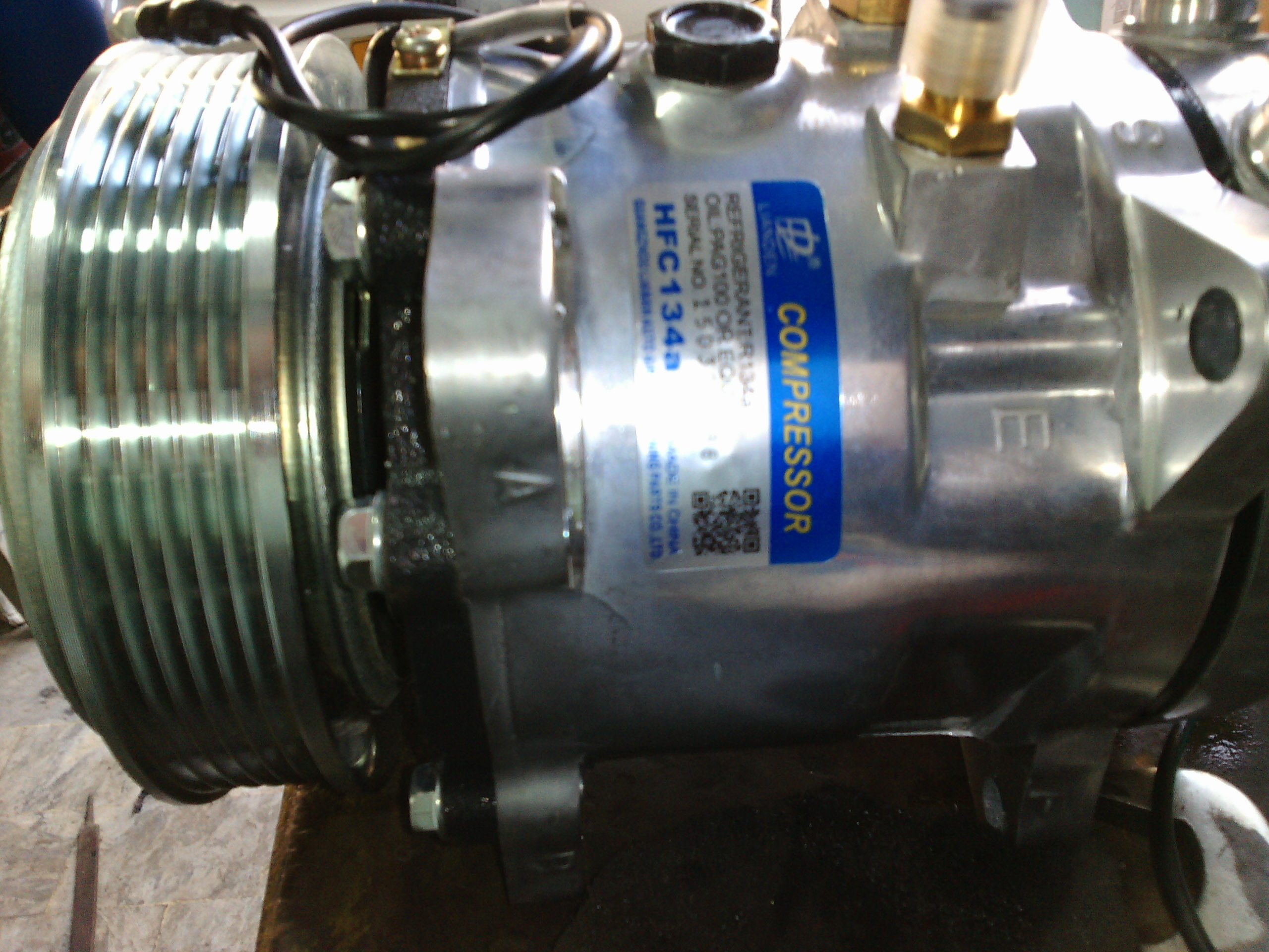

Anyways, He did with LIANDEN and told me that got all work done in Rs. 25,000 (Shop was asking 28 K but i firmly told him to pay only 25K maximum) Works include like New A/C Compressor, Installing Front Condenser (Koolmate brand), Related Pipes(All pipes changed), Flushing whole system, new metal bracket(seat for Compressor), Internal Coil, Refilling Gas, A/C & Dynmo Belt (Belt Size changes from #1260 to #1270) and associated Servicing Labour cost
After replacement, he took car to me & i experienced my self, All is same & cooling is just like SANDEN too. He drives mostly on CNG so After test drive on his Car, I only suggest him to go for Tuning and get RPM adjusted accordingly (Because as this is little heavy as compared to Terious Kid compressor so RPM gets little disturb when A/C is on with Full Head Lights ON ) in short it needs some adjustment. Also to avoid extra Load on Dynmo elec. system better to install some Relay for better performance.
He did all and yesterday told me it is superb.
It is better to visit Karachi for A/C works instead of spending 80 -90 K on just A/C there.
In Karachi, A/C work is more Good & lil. economical because of port(Sea shipment comes here) so Transportation charges can be saved, not too much difference but of course there will be some difference
BTW some of the pics, he Whatsapp me are:
