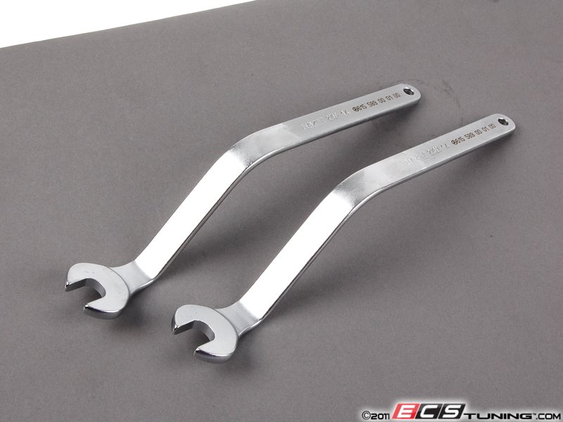

you are right abt the asking for trouble part for the OP. I have seen countless mechanics literally fracture/crack the valve guides while trying to set the valve clearances.
