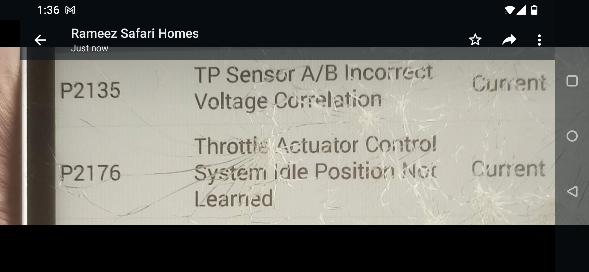

Have this car for 1.5 years and for last 2 to 3 months having this problem.. already spent 50000+ still problem remains ...
Randomly car going to limp mode. RPM get fixed to 2000 and no acceleration works restarting car sometimes fix it for few minutes
Sometimes it starts after using car and other times right when you start car in morning.
Have changed following things in last 2 months and it fixes problem for 2 to 3 days until starts again
New plugs
New coils
Three times changed throttle body (used)
Changed the acceleration peddel after a repair try.
Still car starts either normal and goes to limp mode or start with limp mode.
