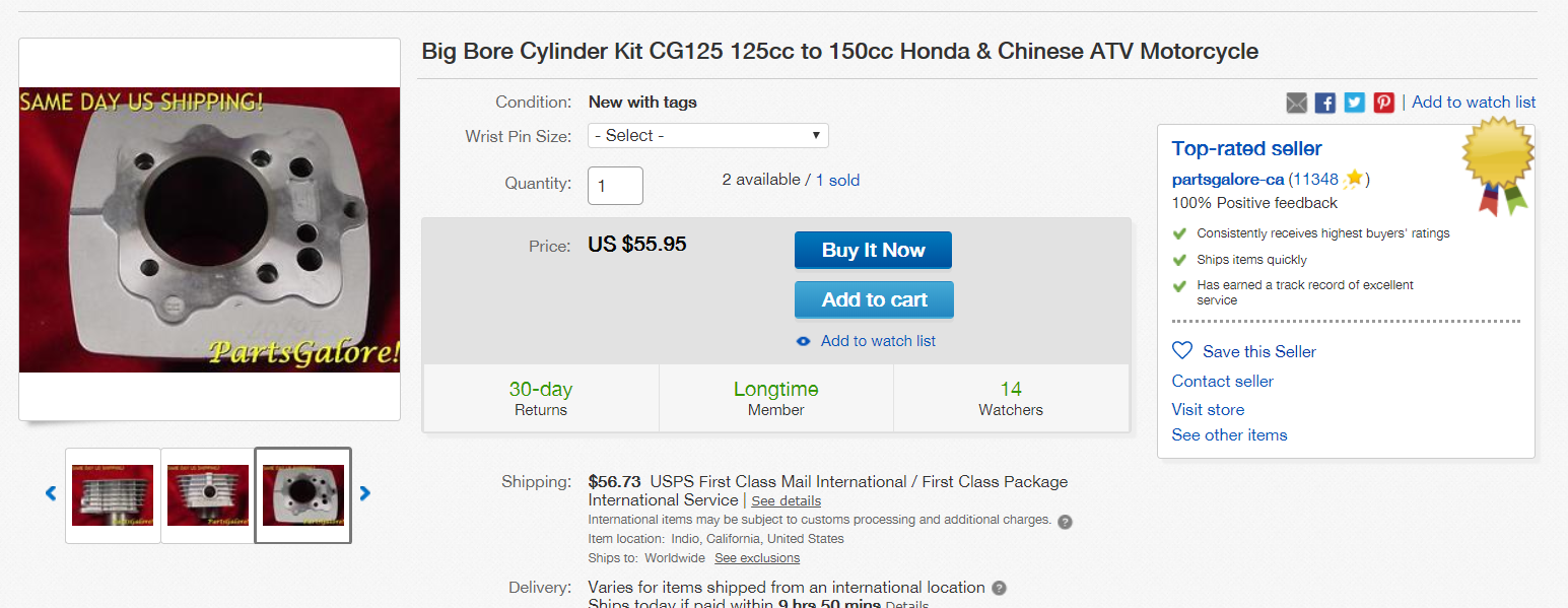

Honda CG 125 Upgrade Engine Performance Mods?
More like a downgrade...
Leaking gaskets, high friction, engine overheating, oil leakage, ignition issues, fowling spark-plugs, engine seizure, stressed transmission... Take your pick!
Don't attempt this unless your cylinder head is blown-up and need a top-end rebuild. It's just stupid and downright foolish to open the cylinder head of a brand new motorcycle.
