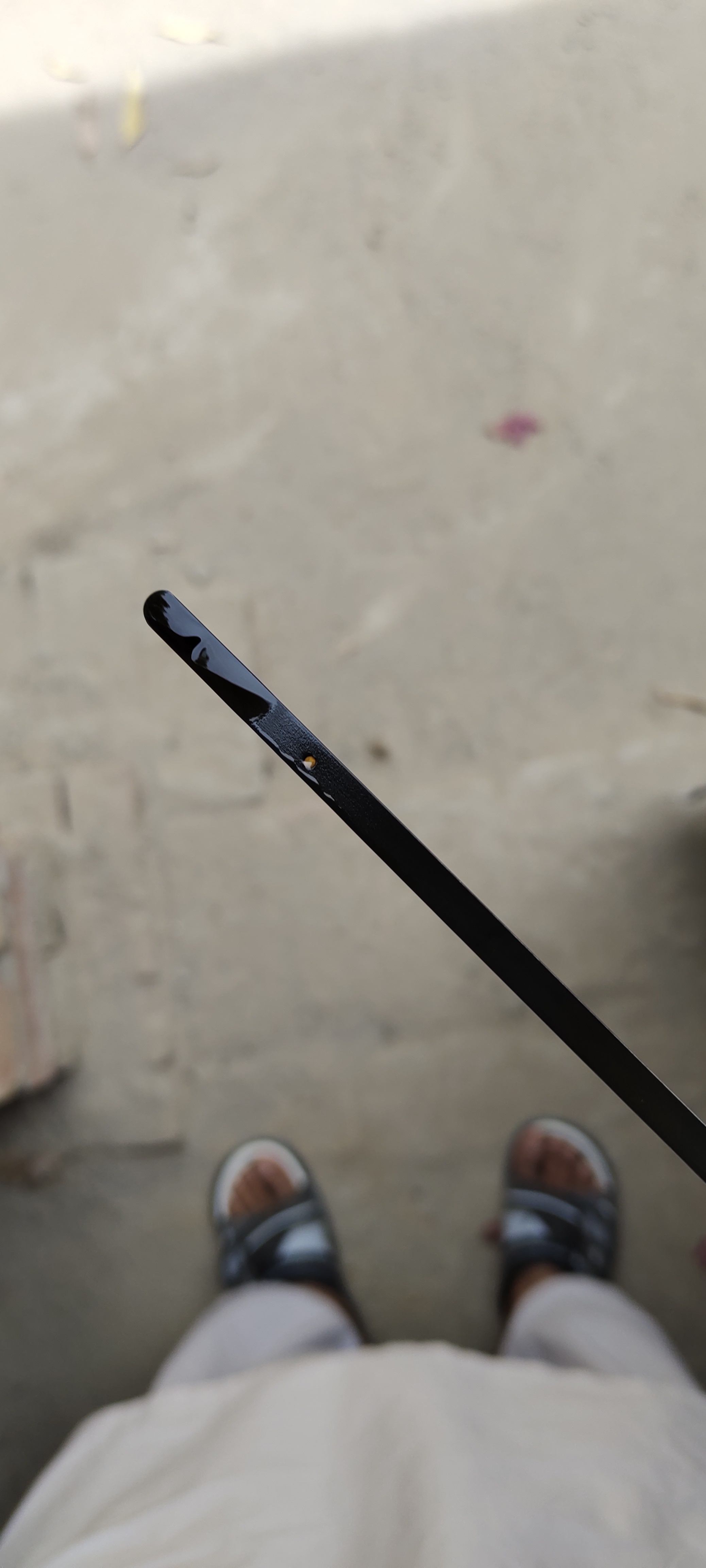

Thankyou for the response. My car's onboard average is displaying around 19.5-21 km/l these days, I think I can say it's otherwise healthy. I am just curious if i can and should switch to 5W-30;)
If there's a risk of oil reduction etc. I'd like to know if it is worth it to take the risk.
What would be the benefits, if any, of switching to 5W-30 at this point?
The disadvantages of continuing 10W-40?
