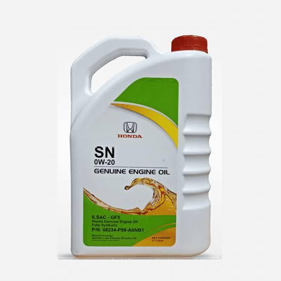

What is the normal running of Honda's 5w30 SN engine oil? 3000 or 5000km? Or i can change the brand in 5w30? Need advice. My previous car that was also Honda was running on ZIC 10w40. Never used Honda's 5w30 so that's why I am asking

In Urban settings normal running of 5w30 SN is about 5-7k km.Honda is recommending 0w20 genuine Honda oil nowadays for newer cars.
10k highway, 8k city

Honda's oil is sourced from idemitsu. They offer high quality oil. Honda recently upgraded their 5W30 to SP from SN. You might be able to get an increase of 1-3km/l if driven on 60-80 speeds.
