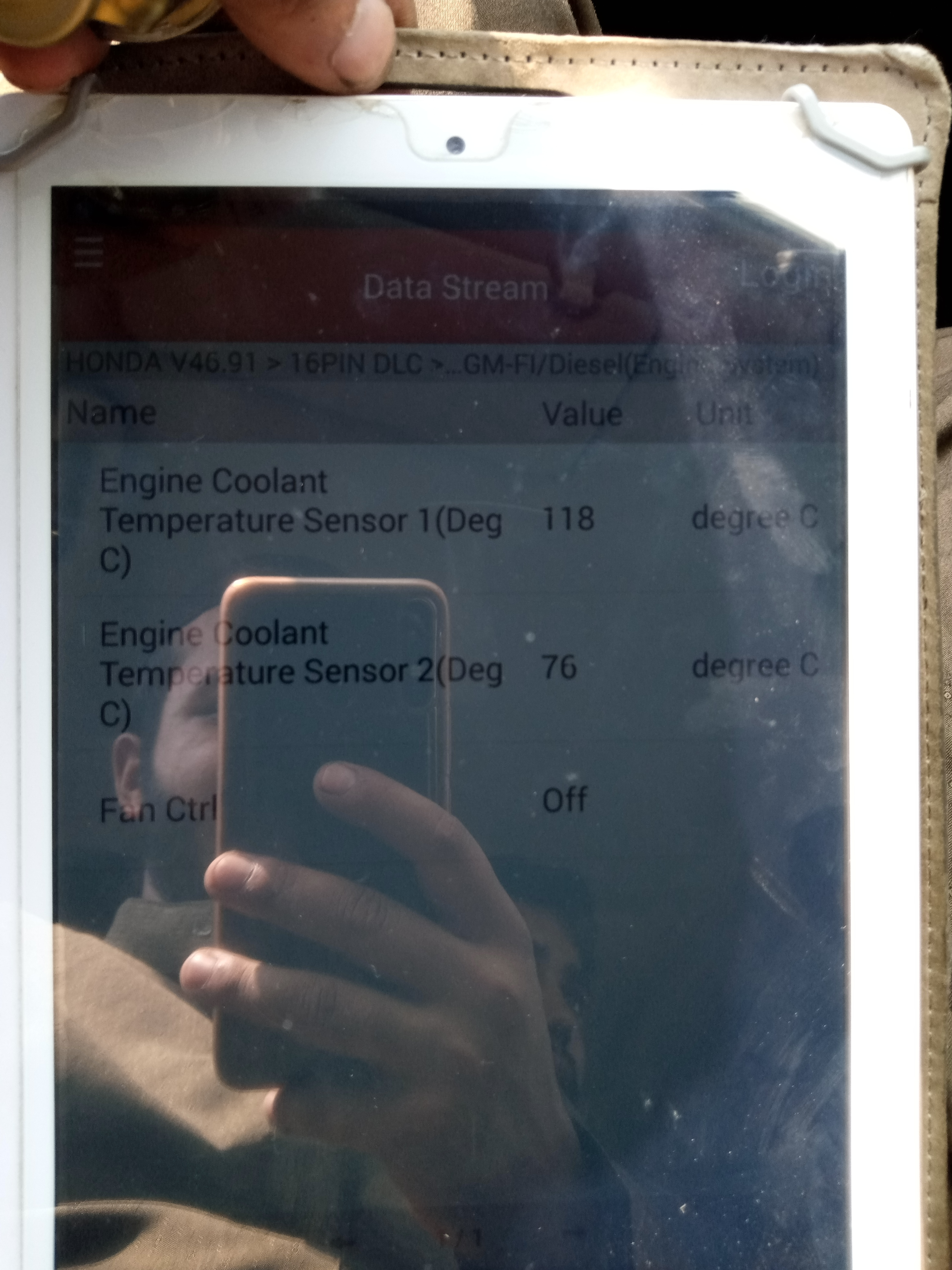

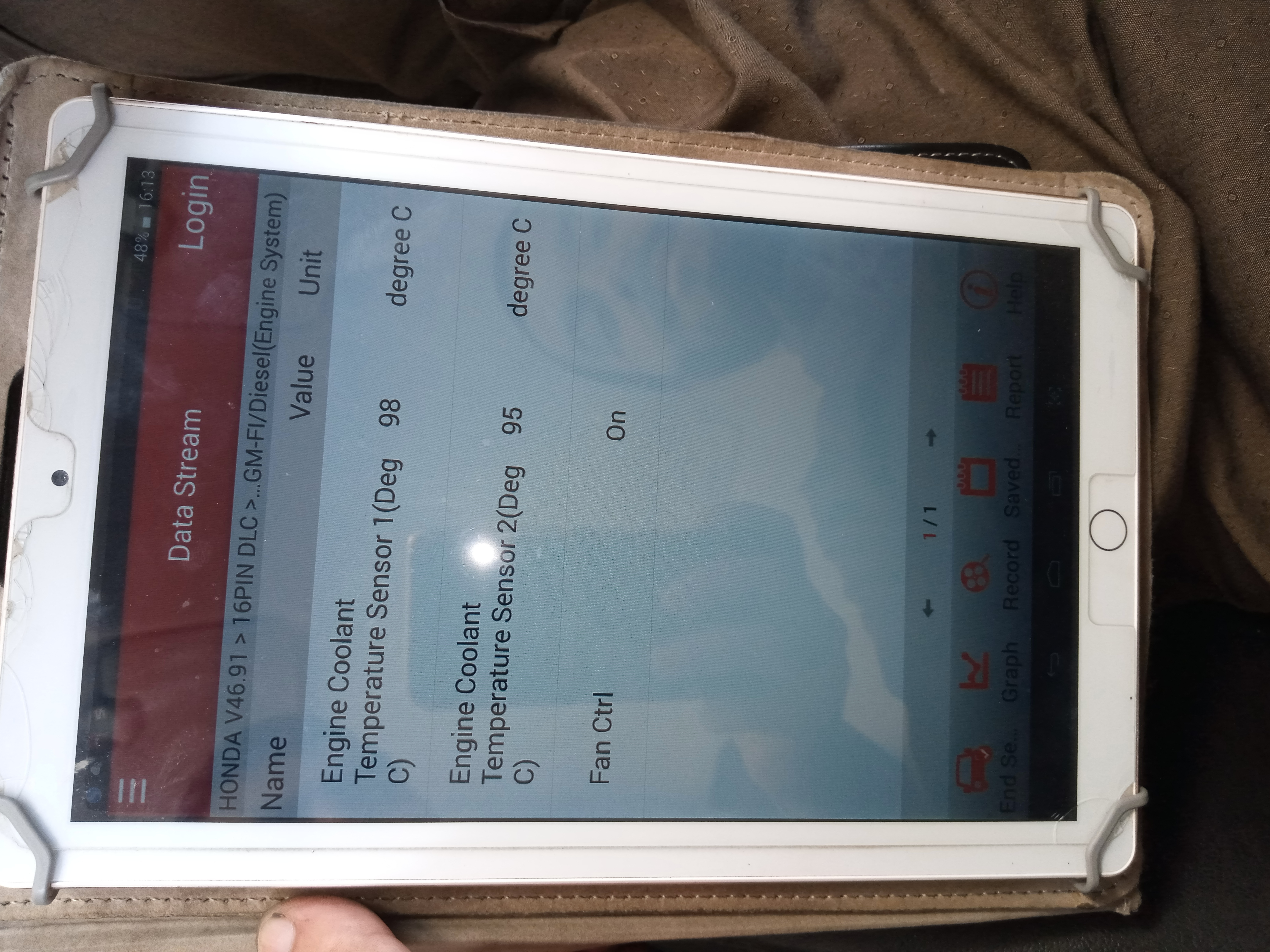

Got the car checked by live scanner. The radiator fans work properly and turn on off at specified temp, the fan would turn on at 106C.
No visible leakage has been detected, however, coolant level drops significantly. Car hardly moves 15kms when it shows overheating issue, blinking red light.
