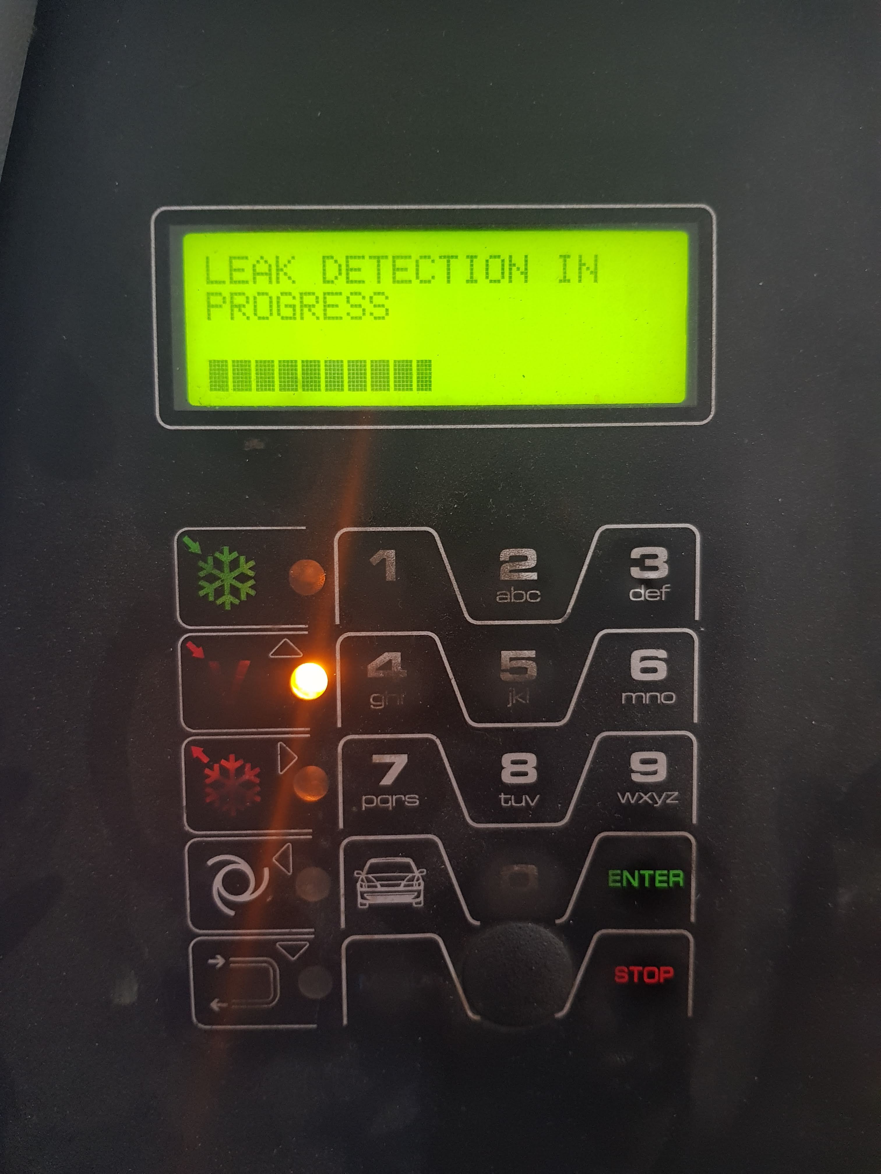

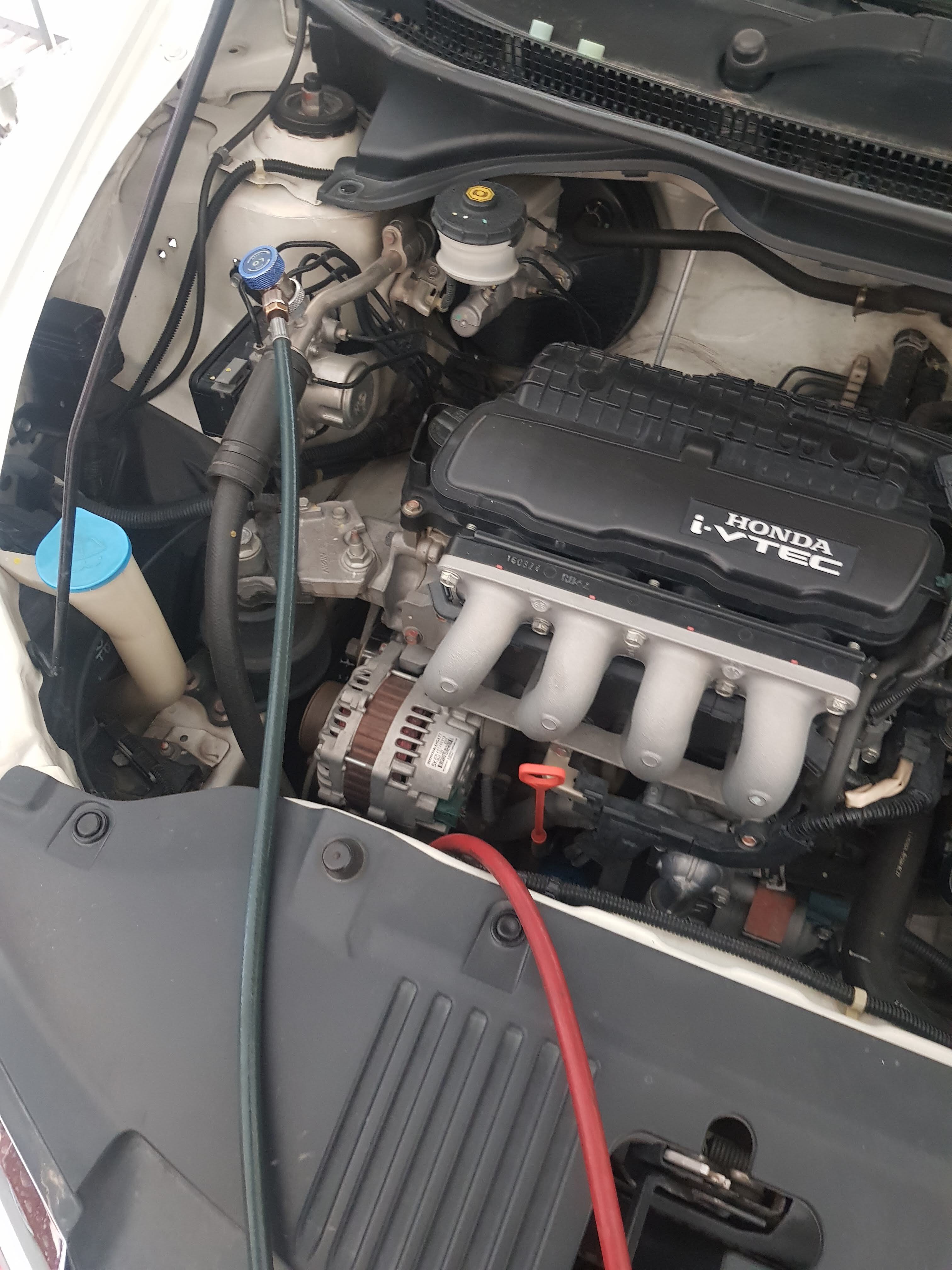

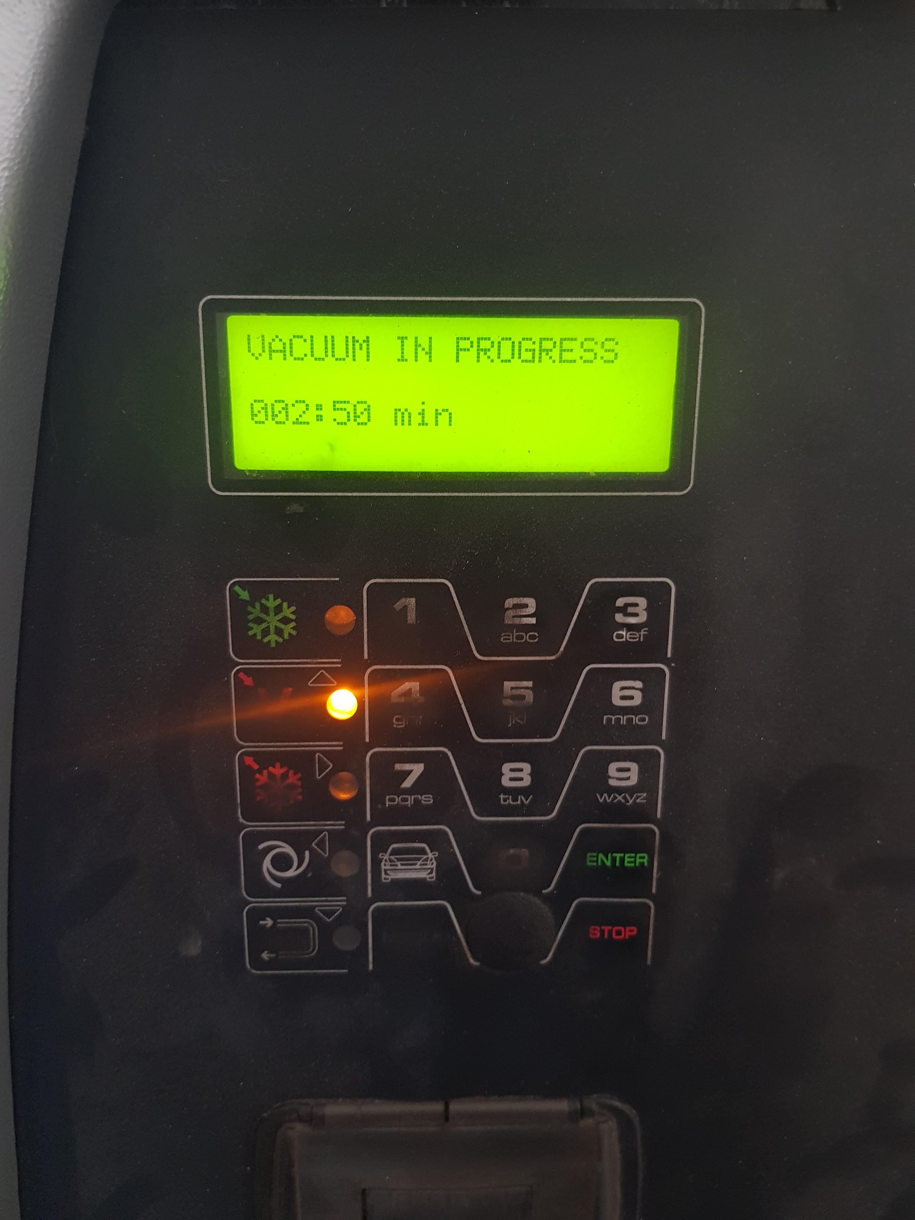

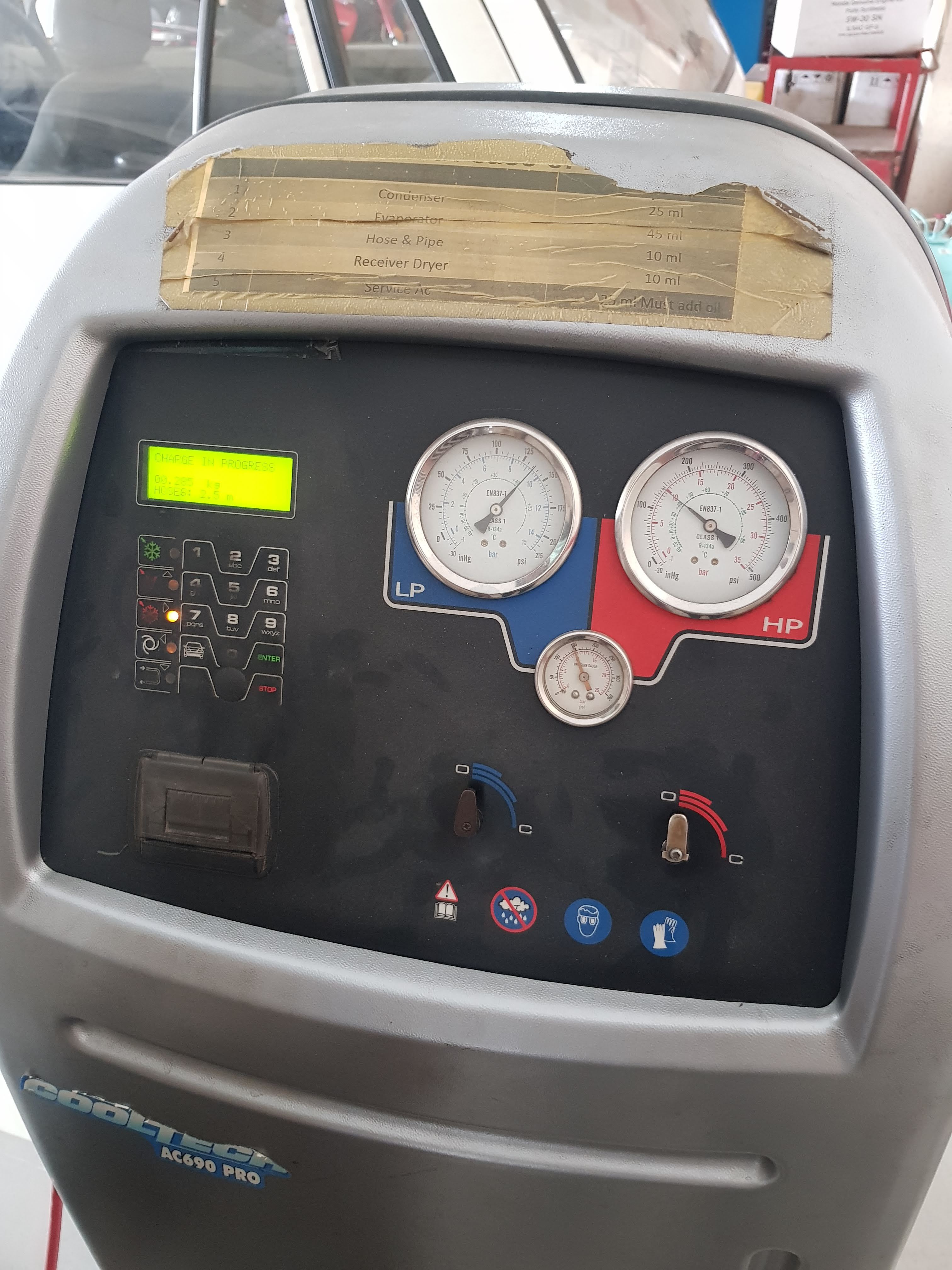

Hey? Let me warm up this thread for once again. I have successfully solved the problem. So, let me share you my experience in regarding to fix it. I've taken my car to Honda Fort dealership, Lahore last week. I let them know about this problem and they called their senior person to deal me. I let them know the whole scenario. He examined the AC response and quote me to refill the gas because it may cause because of insufficient amount of gas. He was kind enough that he didn't charge me to check how much amount I have left. He brought the machine and attached the hoses from both end. The machine took some time to suck the whole gas to weight it. I asked him how much gas it required usually. He softly replied that it should be 450kg. And vacuum took approximately 3mins to suck. Once this get completed the results were 270kg only. So, he told me that was actual reason it may freezes the ice. And, many of you guys suggested me the same to do so I asked me to continue his work. Before refilling the gas the machine actually check the leakage and luckily it was cleared. Once everything setup, it started refilling it to 450kg/s within a minute. And then he turned on the AC to it max throw with a lowest temperature for 10-20mins to check the pressure and few more technical tricks.He actually cleaned the AC filter and asked me to maintain my rpm to x2000r/min for 5-7mins. Then he dropped me with a closing bill with a ok report. I will attach the bill at end of this thread. And I have driven the car today in city for around 80-90kms and weather conditions were good enough today but it worked smoothly no problem at all so far. And, I really hope that this will stay for longer period of time. And, I'd like to thanks all of those people to drop me some suggestions and for those who make this thread engage, I hope this would help others in near future. Thanks for once again.
