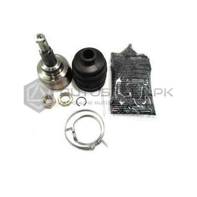

I am experiencing vibrations in my car's passenger side floor. anyone sitting at the front passenger side feels vibrations in floor. I got the vehicle inspected from a mechanic. He suggested three reasons
1. wheel alignment and balancing
2. wheels bearing
3. axel or goda
I have got the alignment and balancing done. The vibrations are still there, although the intensity is quite low now. nevertheless, one sitting at the front feels them.
My main problem is with axle. axle available in market is being sold in the name of kit (CV Joint) (to be precise, outer kit) without rod. if inner axle has problem, then one has to look for kabli axle as fresh piece is not available in Rawalpindi.
Can anyone tell, if I get the outer kit replaced, would it work? I do not know if complete assembly of axle is available in other cities or not, as all the shop keepers whom I contacted said only kit is available. any help form experienced guys please? I would only get the vehicle opened for looking at bearing and axle once I exactly know what should I do if axle is the real culprit.
attached is the picture of kit available in market @ 2100 Rs
