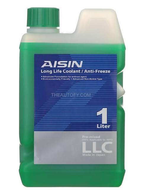

How can I know which coolant is in my car? I bought this car a year ago so not sure which coolant previous owner used. There is no problem whatsoever in the car. The coolant in plastic reservoir bottle is at minimum level so I want to add coolant to it up til to maximum level. So wanted to make sure that the coolant I am adding is same to the existing one. The color of coolant is green. Also from the last year coolant level is same when I bought this car last year. Is it okay if the level remains at minimum level. Ofcourse when the engine is hot coolant level expand and go up in reservoir bottle. The car in question is Honda city 2012 model.
Use this Coolant
Is this safe to add to existing coolant?

Yes. Safe to add. Keep the Coolant level in between the Min and Max levels. And keep the coolant reservoir cap tightly closed.
Yes it's on minimum level from last year when I bought this car and staying there till date. I think then I should leave it there but keep an eye Incase if it decrease then will add only
Got it, thank you. By the way you have evaluate based on the color of coolant I have? Or this aisin coolant is compatible with all green color coolants?

If you don't know exactly what coolant is in your car, dont risk mixing different types of coolant (colour isn't a guaranteed indicator).
Mixing will cause major issues, gelling I believe.
Better to flush and add totally new coolant.
