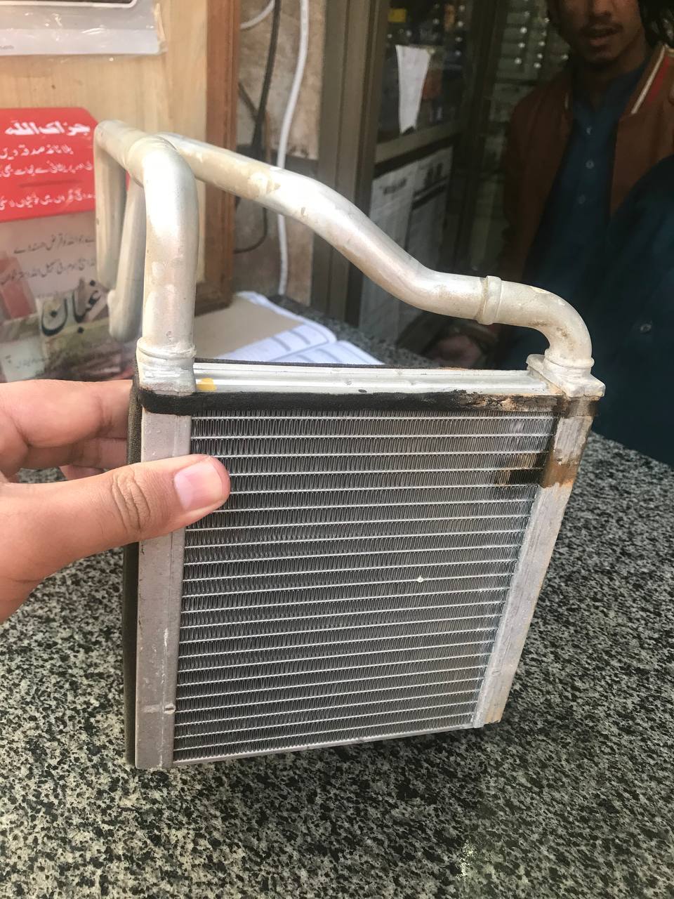

So after a week or so, I took the car to AMX Honda Center in I-10 islamabad to get it completely serviced. I asked them to check the heater too. They checked and told me that the heater hose is disconnected. So I asked them to fix it and they just reconnected and ran the heater, it was working fine. I was satisfied and I drove home with the heater on afterwards.
I'd like to mention here that this is my first car, I could not possibly have known that heater could've been disconnected because of a leakage in heater radiator. And AMX Honda should have known this, but THEY STILL JUST CONNECTED THE HEATER WITHOUT CHECKING FOR LEAKS!!!

Next day, I brought in a local mechanic and I asked him to disconnect the heater again.. After that, I topped the radiator with water and drove. All Good !!!
