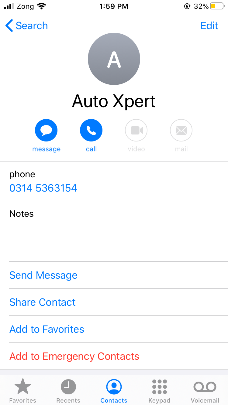

Please show some results of it? And feom where did you buy Philips nightbreaker?
Visit his page on facebook. He has uploaded videos there.
