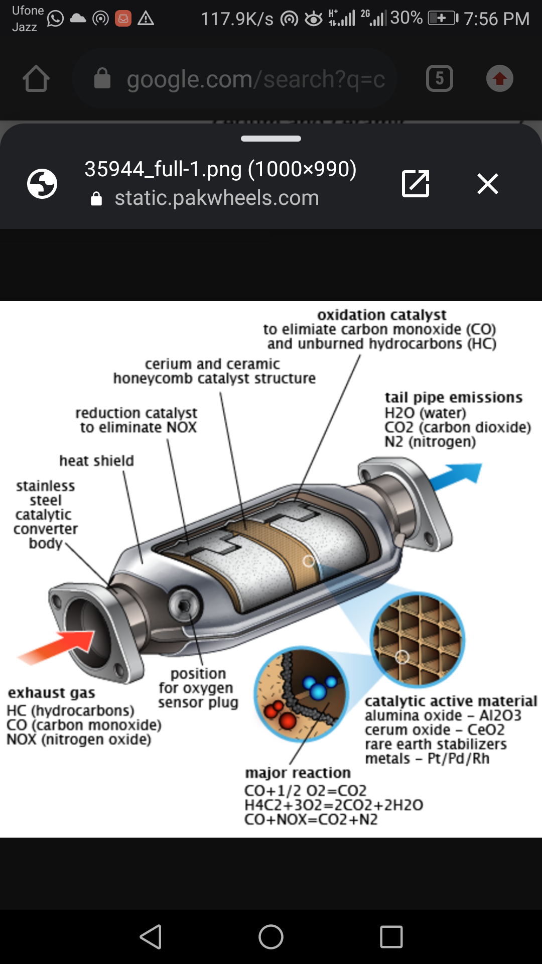

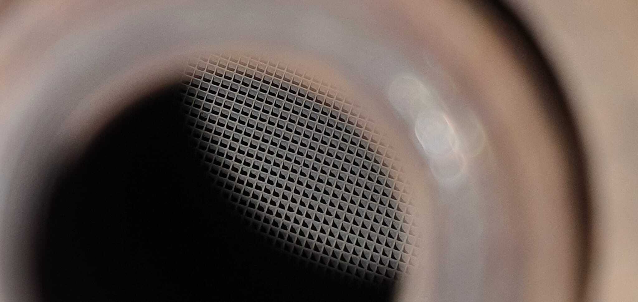

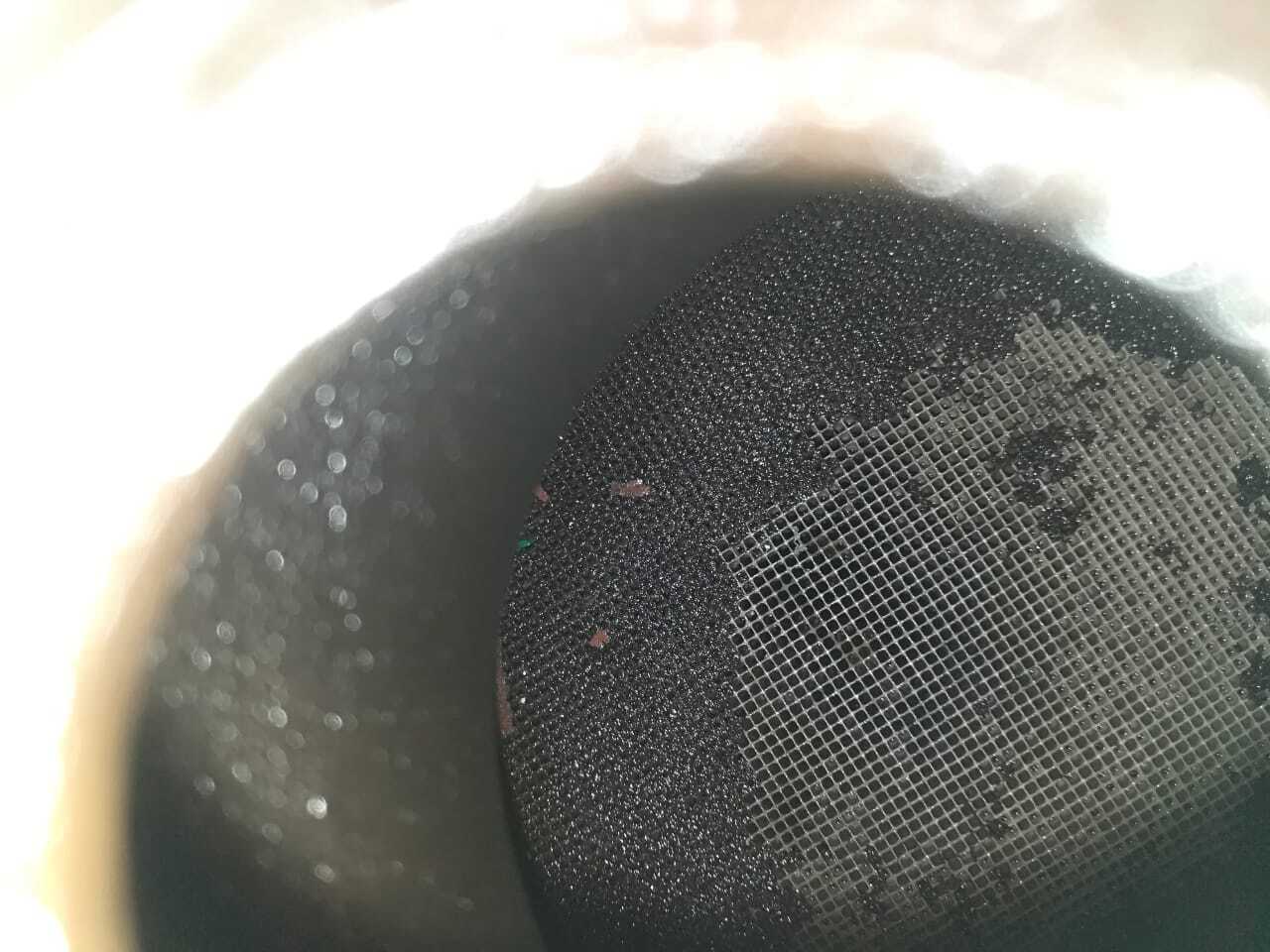

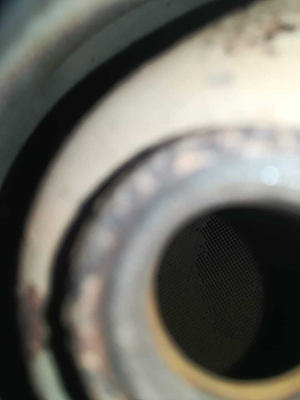

Bro its so simple, make a required concentration liquid in a bottle mixed with water, make a hole on cape, and put a plastic pipe of small diameter in the hole, pipe is available easily in market,
Now open o2 sensor, loose 3bolts of exaust pipe fitting under the car and seprate it from both sides, but dont open the catalytic fitting of engine exaust side,
Now poure Catawash liquid slowly slowly from o2 sensor point and let it react for 15 20 minutes to catalytic chock surface.... After this add clean water to remove liquid catawash.... Be careful... Always poure slowly to avoid water going inside the engine exaust chamber, after completing the procedure start the engine with open 3 bolts of exaust pipe, and increse throttle to 2000rpm and wait for 10 15mins, by doing this exaust pipe line along with catalytic will be cleaned and dried....engine may take long start up, If there is starting problem of engine then remove current coils, remove 4 plugs and make them dry, again insert the plugs with current coils and start...
