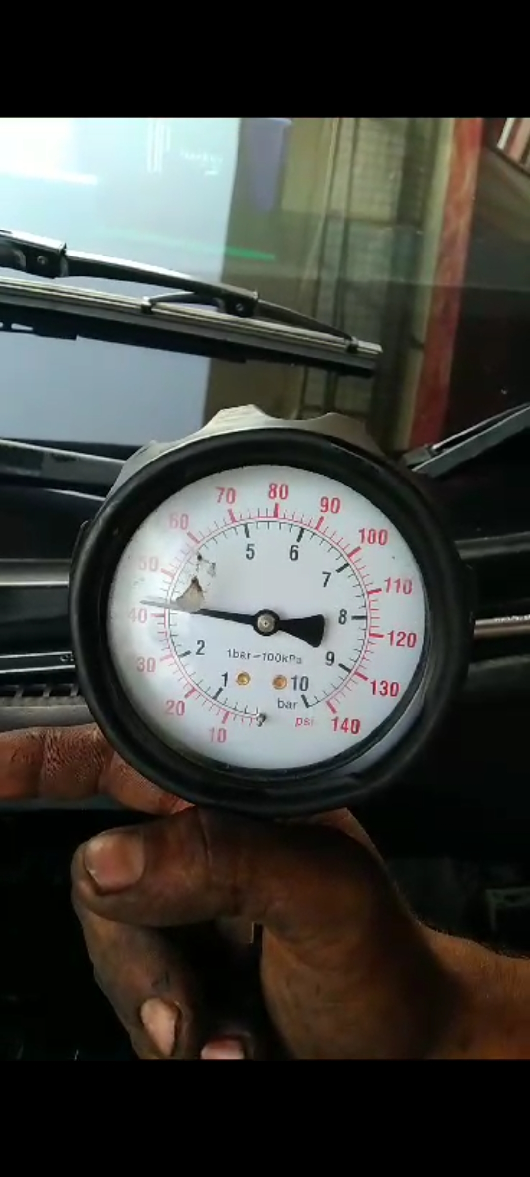

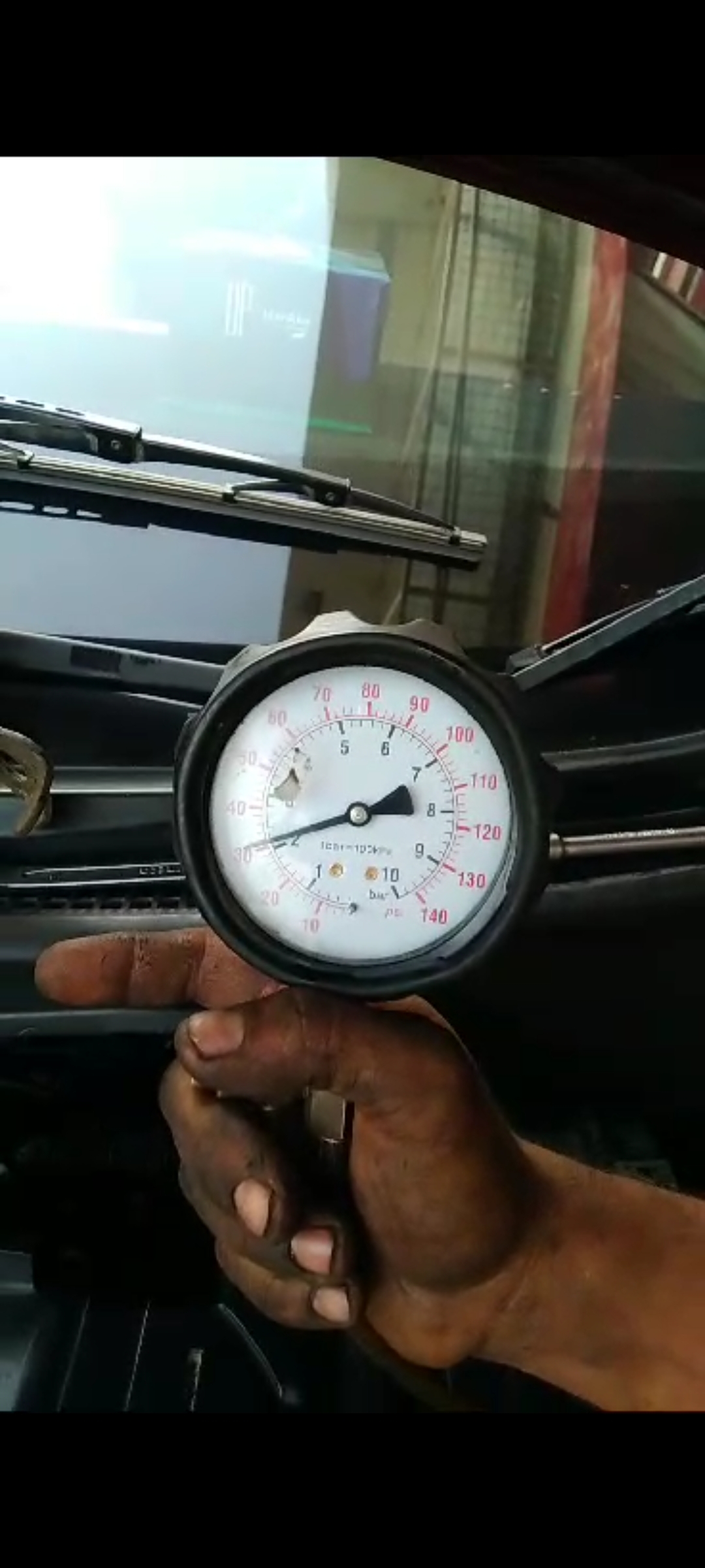

At idle honda says,
"Read the fuel pressure gauge. The pressure should be 320−370 kPa (3.3−3.8 kgf/cm 2 , 47−54 psi).
If the pressure is OK, the test is complete.
If the pressure is out of specification, replace the fuel pressure regulator and the fuel filter, then recheck the fuel pressure."
change the filter first and see.
