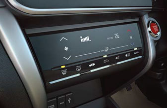

Good day i have a 2016 Honda City model it came with the rotary knob type air condtion controls, i'm interested in finding out if it is possible to replace it with a touch screen panel for automatic air conditioner and a link to where i could purchase it. Can anyone assist in providing me with some guideance, here is the link below.
nops. . .as its electronics dont support the digital temperature n flow controllers. . .the board is analogue type input output style !KK
Oh i see, thanks for your insight on the subject matter.
