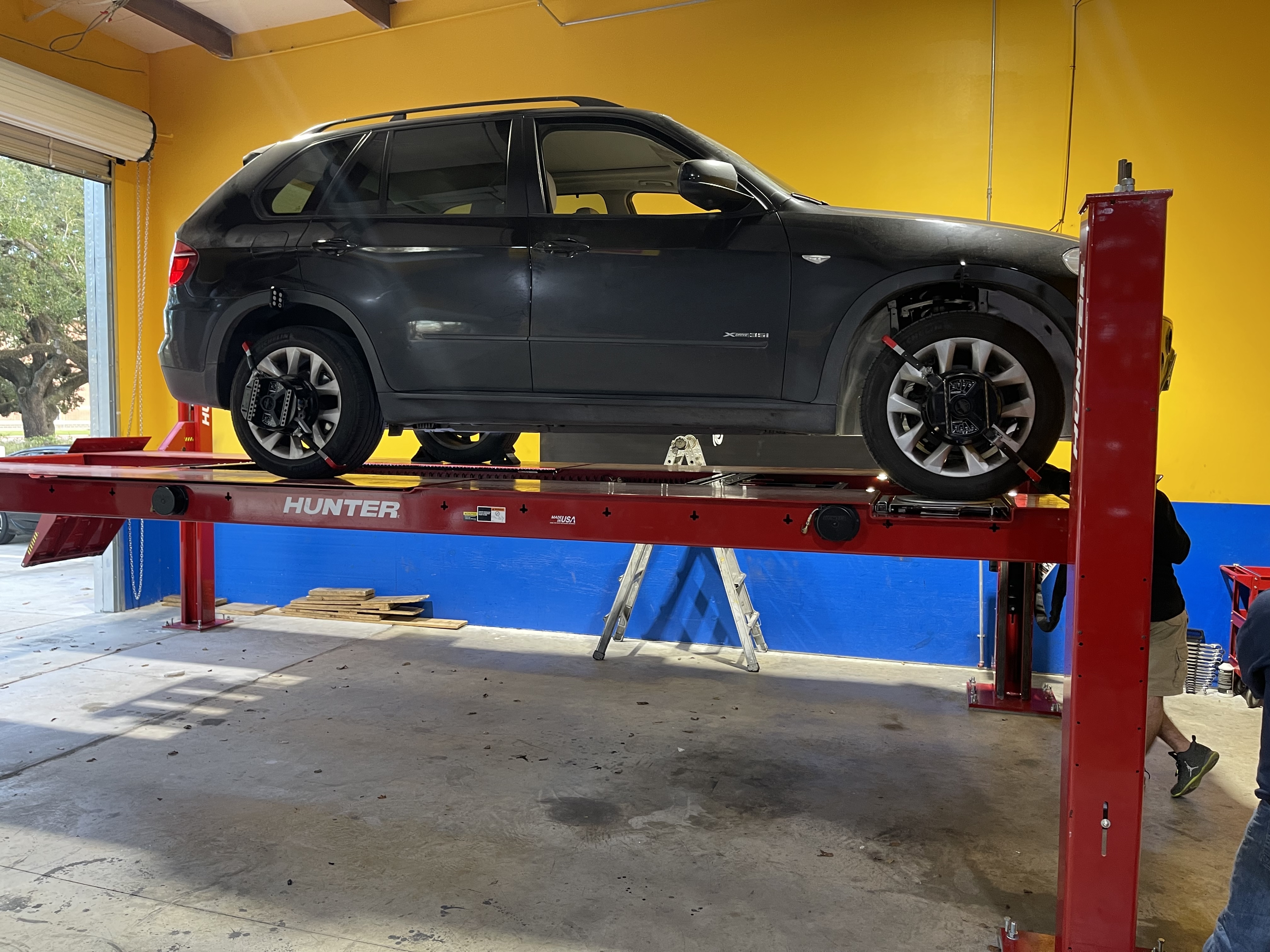

Steering is never ever removed from shaft, the pinch bolt at the pinion is removed and resplined if someone messed the rack in the first place. So i wouldnt consider this gent as âqualifiedâ
And this is a 2 wheel alignment rack, only does front alignment. Meaning if rear suspension is pointing wrong, the front will be wrong too.
So another minus point here too.
Finally i didnt see anywhere if they measured the axle angle to determine chassis ride height first.
Basically this is a cheap toe and go - real alignment is not this.
