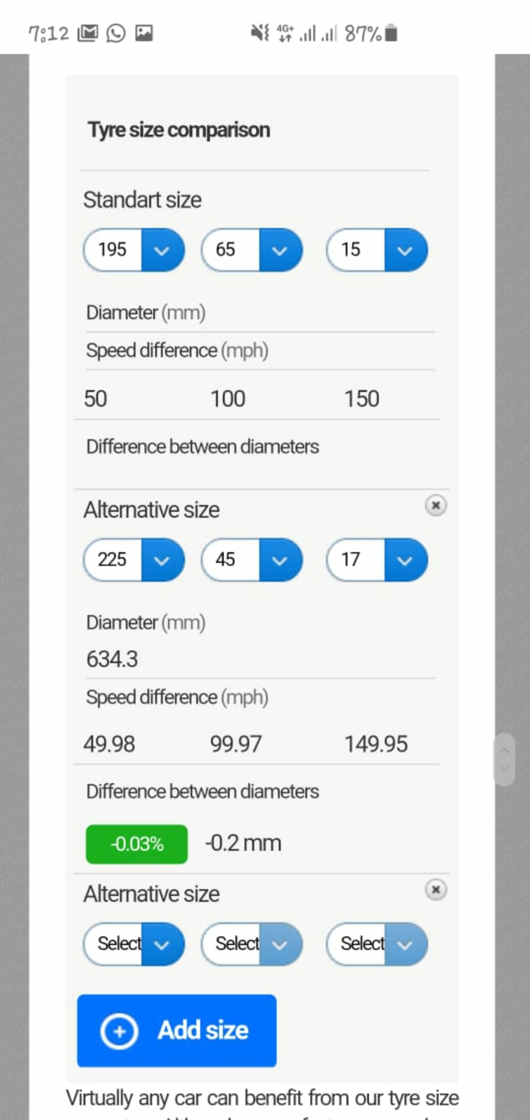

I think 235 width is making issue. If u want 17' then u have to use 215/50R17. The OEM size is 195 and you have installed 235 which is 40mm increase in width which should not be more than 20mm. Use 215/50R17 also by using this size you'll feel increase in comfort bcz of increased profile also on bumps and pot holes they'll perform better
