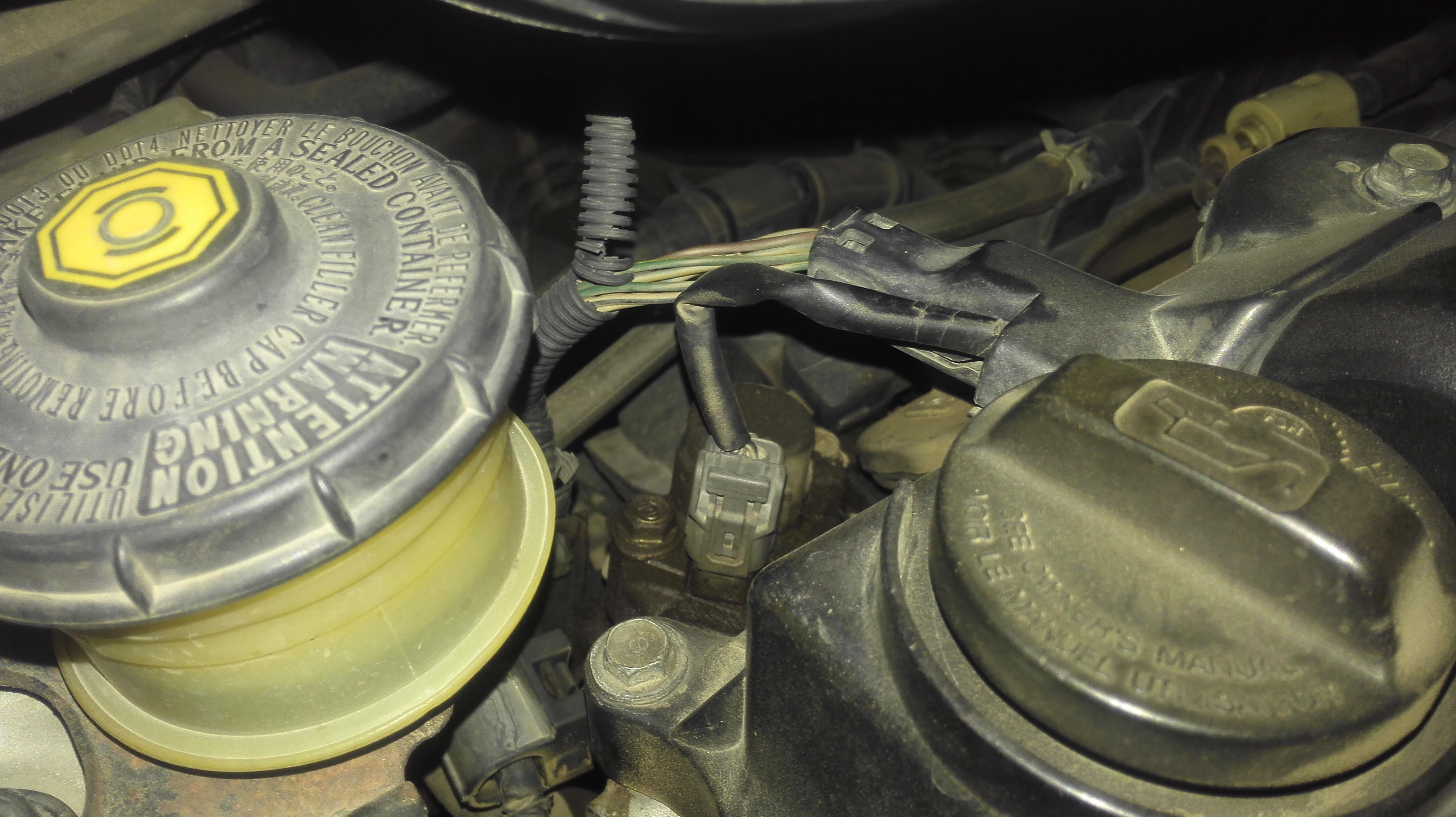

1 - It is best to not use any water at all or very little. The entire radiator and connected cooling system should be filled with a good quality coolant. Drain the entire system if it contains water only. Water is bad for the radiator and will cause rust. Other fluids in this car include brake fluid and power steering fluid which should not go below minimum levels indicated on their respective bottles on the top left of the engine bay.
2 - Left side blue cap is for wiper washer.
