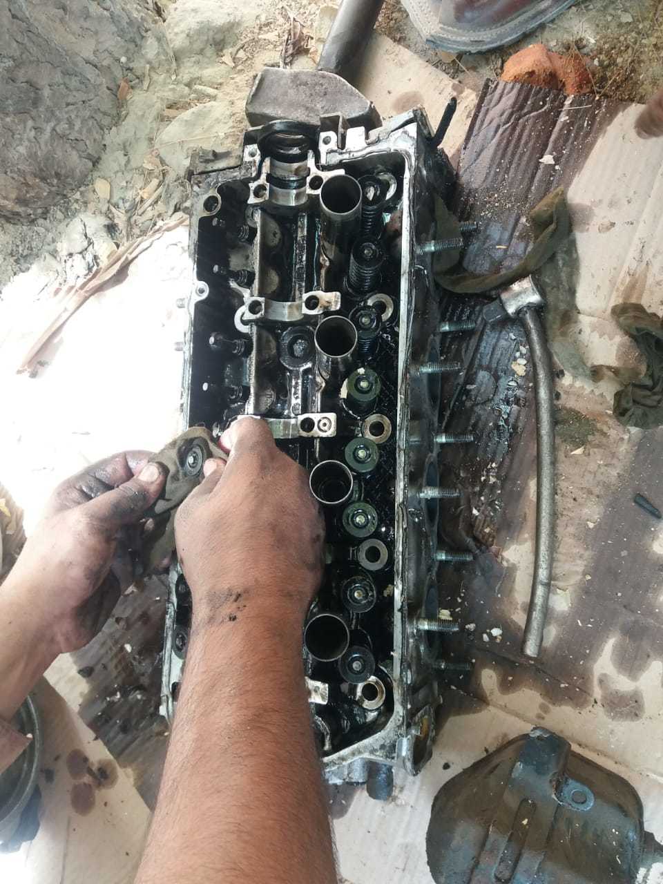

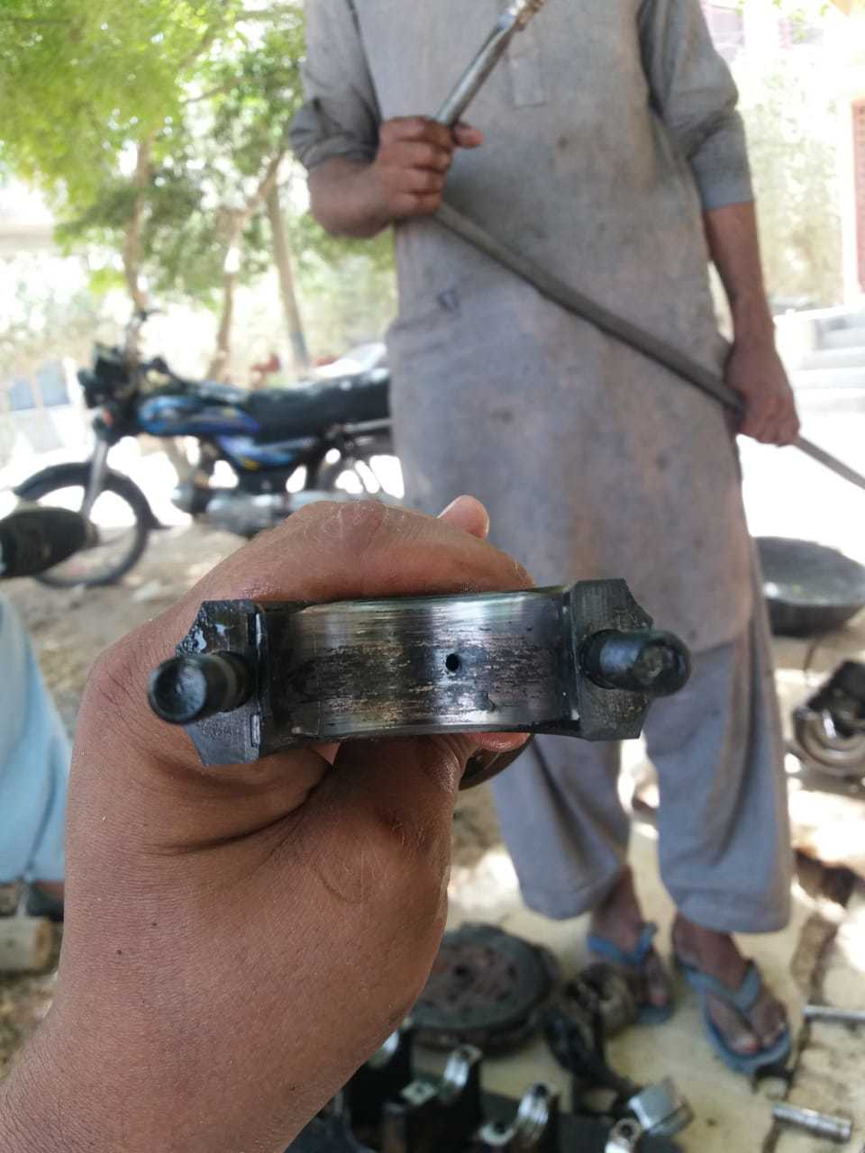

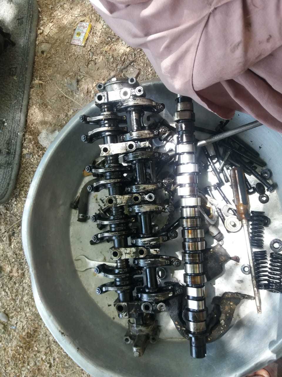

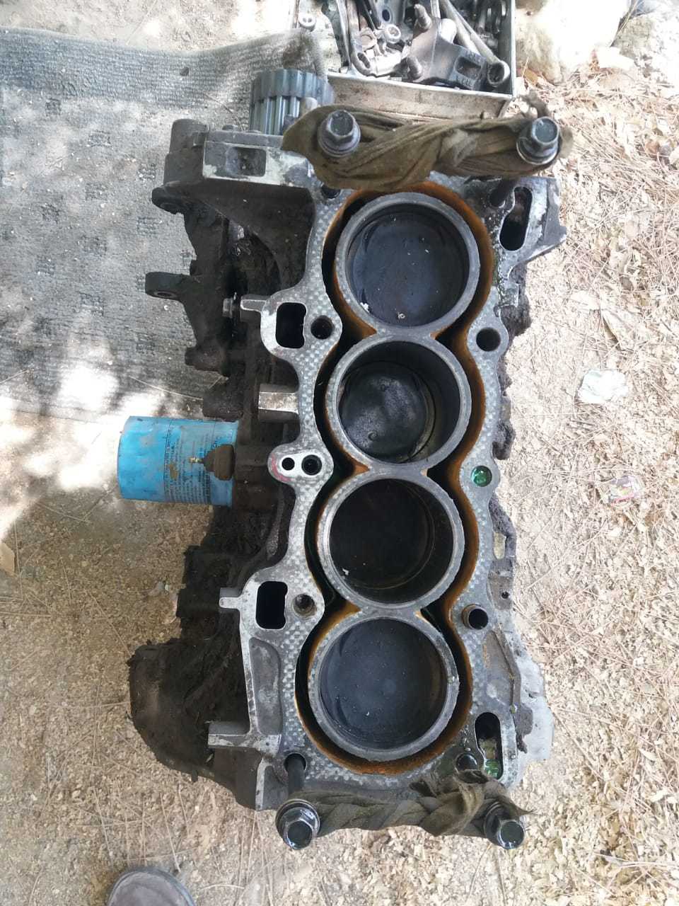

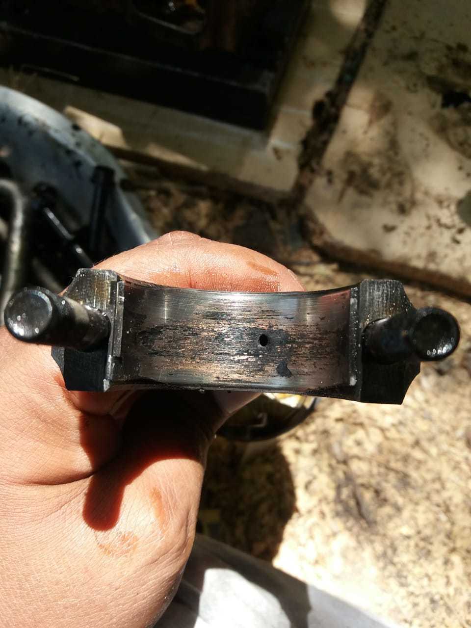

To whiz through the rest, we found out that the oil pump was not functioning optimally aaaaaand there was no pressure on high speed and you all know what happened because of it. Not really the guys fault who I bought it from because you can't really tell what condition the oil pump is in till it actually starts acting up. On top of it, it worked fine at lower revs as I had been driving it around in Karachi at 50-70 ki speed. Anywho, so the crank got messed up, the piston rods got screwed. Overall, the engine is in bad shape. So I toed it back to Karachi and parked it and the same fellows place.

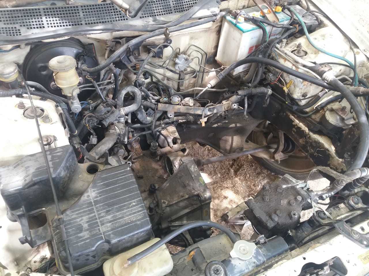

Now that some shops are open, my guy went about to check how much it would cost to rebuild the engine. I spoke to my mechanics here in Isloo and also some friends who know cars well like myself. So we came to the conclusion that instead of building the engine, we'd rather swap it out.
What I want to know is that some folks are saying that we only get the assembly swapped and not the whole engine. I kind of agree because the pulleys, the starter kit and everything else works fine. Its only the engine itself that got screwed up so we'd rather just swap the main assembly and not the whole engine.
