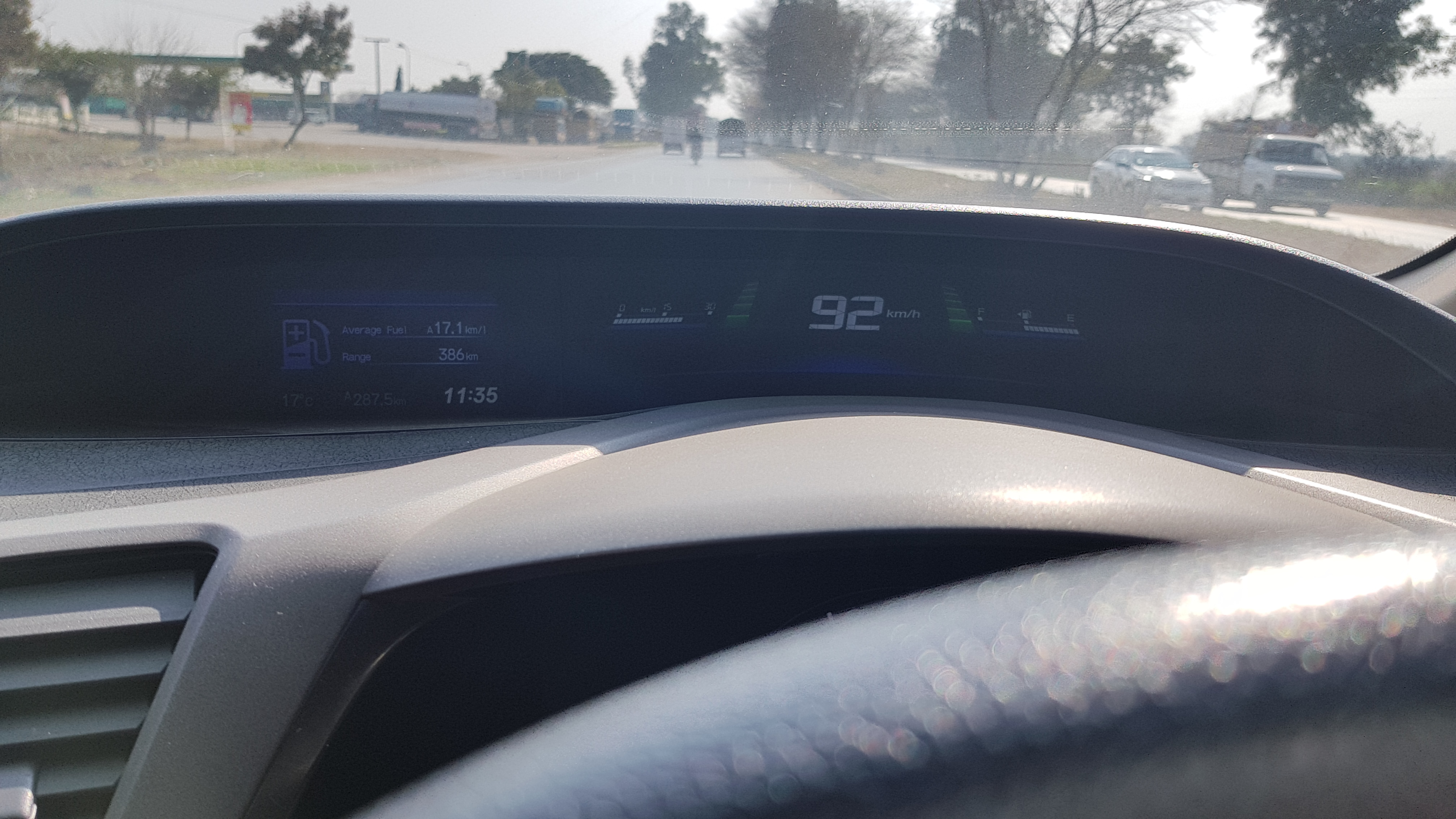

And the average i get (Civic 2014 Prosmatec hardtop) on highway with 80-90km/h speed is around 19.5-21km/l shown on i-Mid display panel. and on motorway at 120km/h speed 18.5 i get with manual cruising (mtlb paon ko aik jga set kr k acceleration zero krna - means change in speed should be zero).
