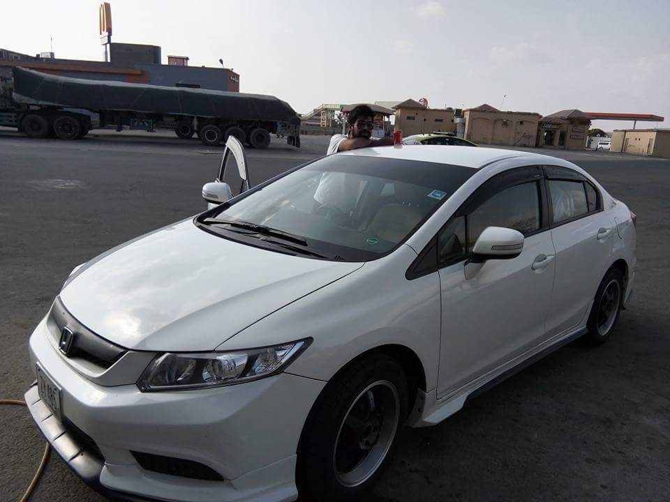

I bought this several months that back and straight away felt that the brakes are not up to the mark.
Oem tyre size is 195
I changed it to Michelin primacy hp 205/55R16 and still wasn't comfortable with stability and braking
Then I dropped my car by an inch by installing Japanese springs. It improved a lot but still not satisfactory.
I changed my tyres to 215 Michelin Primacy 3 and it was again improvement.
Then I installed 5mm wheel Spacer to increase crease the track, it improved the stability again.
The again I changed the brake rotors and calipers. I got bigger brake rotors and bigger brake calipers that come oem with car in dubai or Japan.
And now I am satisfied with the cars behaviour and response.
