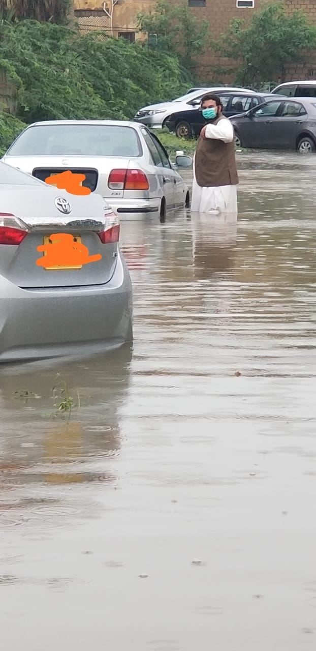

my civic got flooded recently, opposite to karachi club in office parking
both the ECU and Steel mate 838g security completely submerged in water for several hours.
water level was just covering the front tyres

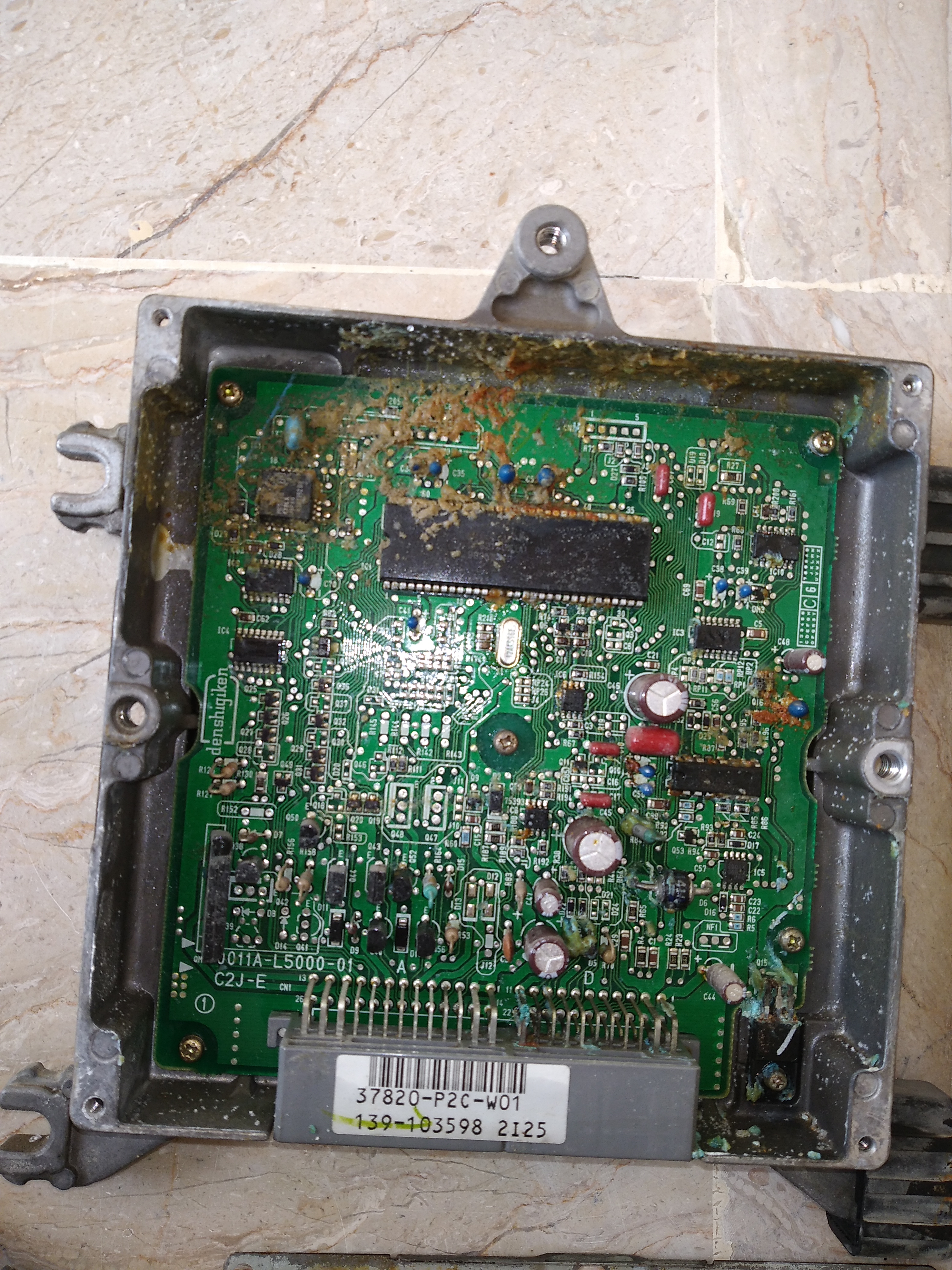

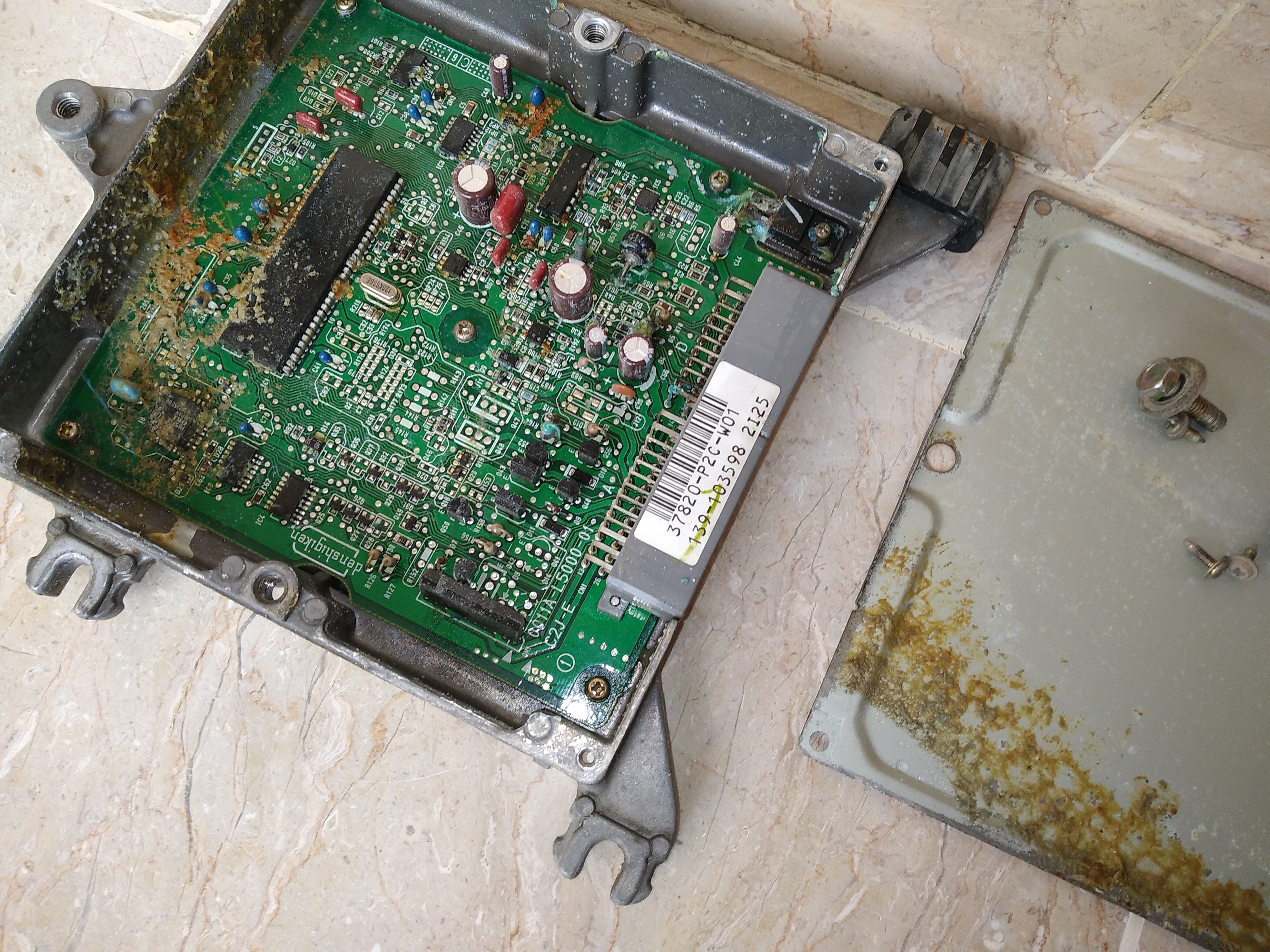

8) ecu was cleaned with wd40 and brake cleaner mix. but some components are corroded, 1 tiny component (i think capacitor leg has broken)

@Xulfiqar please advise further what items to check. and how to confirm the ecu is dead.
karachi members, if anyone would be willing to lend me an ecu for 5 minutes to i can confirm if its the ecu thats gone.

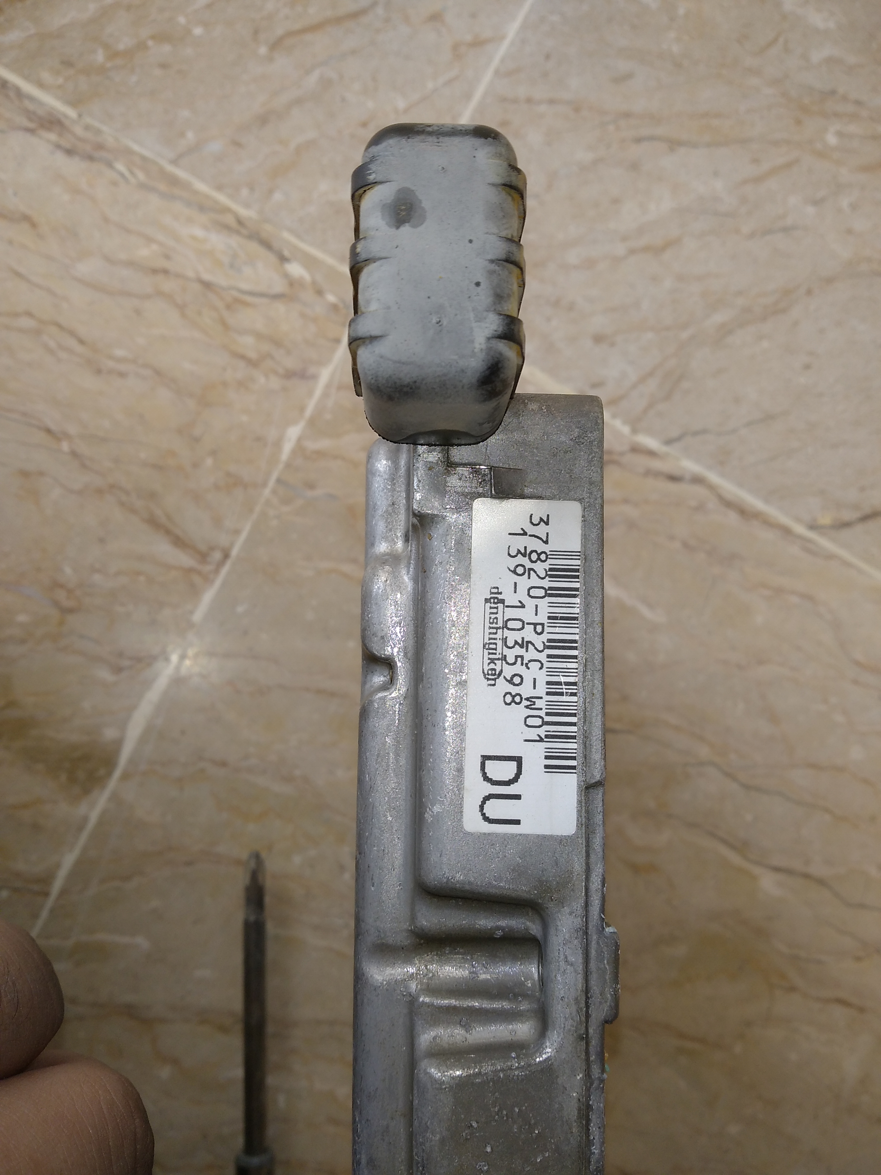

the car is 1997 pakistan civic, manual, completely stock and original engine with original ecu. EXI 1500cc.
the ECU number is 37820-P2C-W01
